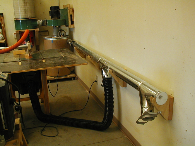

In addition to the Thein baffle and Wynn Environmental filter pay attention to your ducting length and any corners. NO 90° turns as air does not make right turns. It is all about air flow. If you restrict the air flow no increase in impeller size will help.
The photos are of a system I designed and installed at a retirement community woodshop where my wife & I volunteer. The fiber drum has a Thein baffle and you can clearly see the Wynn Enviromental filter. I kept the ducting to a single straight run which not only keeps the air flowing but also makes clean out of the ducting easy if it does becomes clogged. Notice all the blast gates come off of 45° adapters into the 4" ducting. Again to keep the air moving smoothly.
This system easily handles a tablesaw, planer, jointer & bandsaw. One at a time.
Bill
