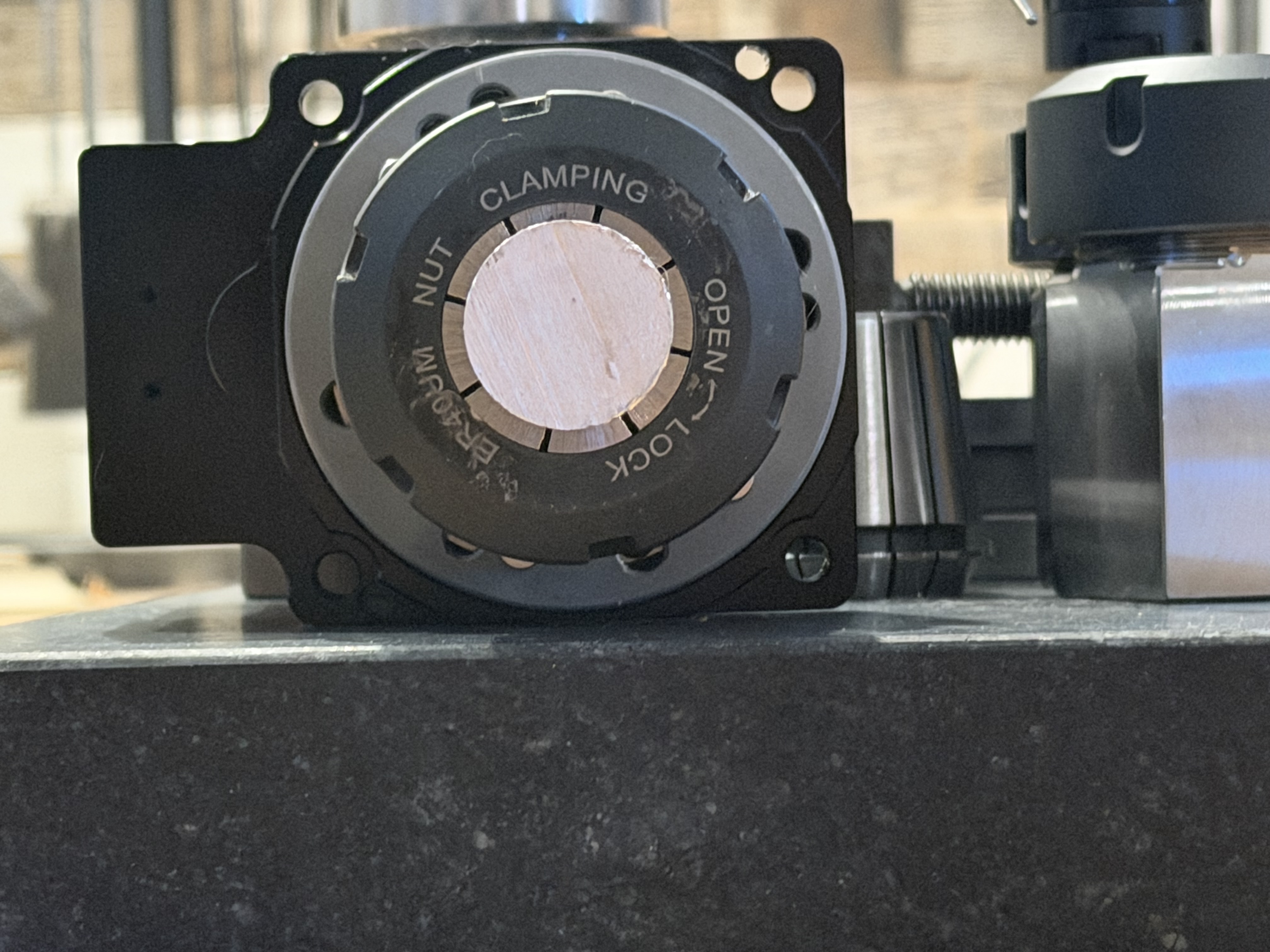

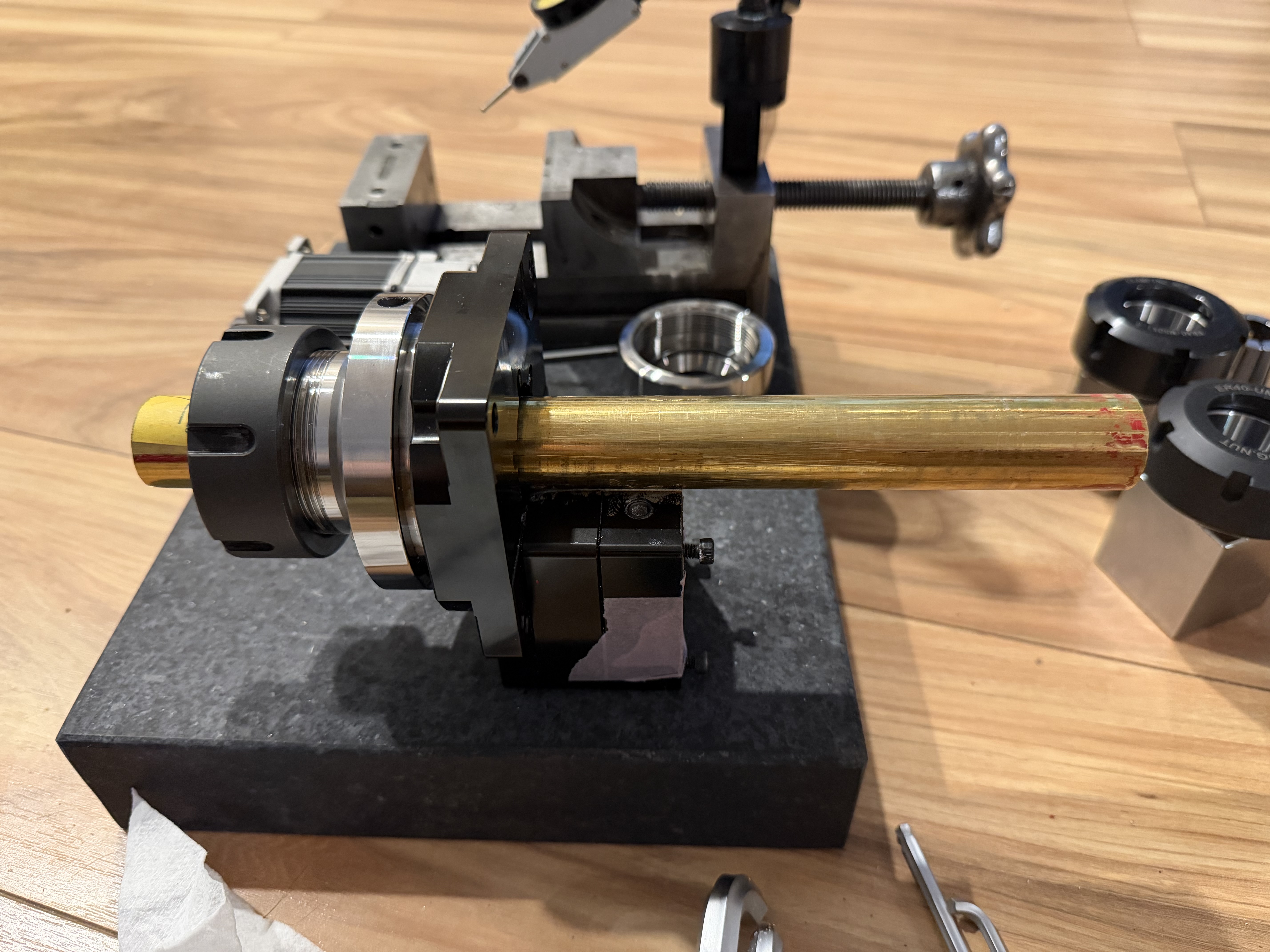

I want to run 1” bar stock on it so the ER40 was the best I could come up with. The driver is a little self contained all in one teknic clear path. Very nice with a price to match (not terrible for what it is but most folks could get away with much less…I just wanted to use this as a test case for evaluating other uses)
That looks great, @HeuristicBishop ! So that is 1" stock you’re demo-ing?

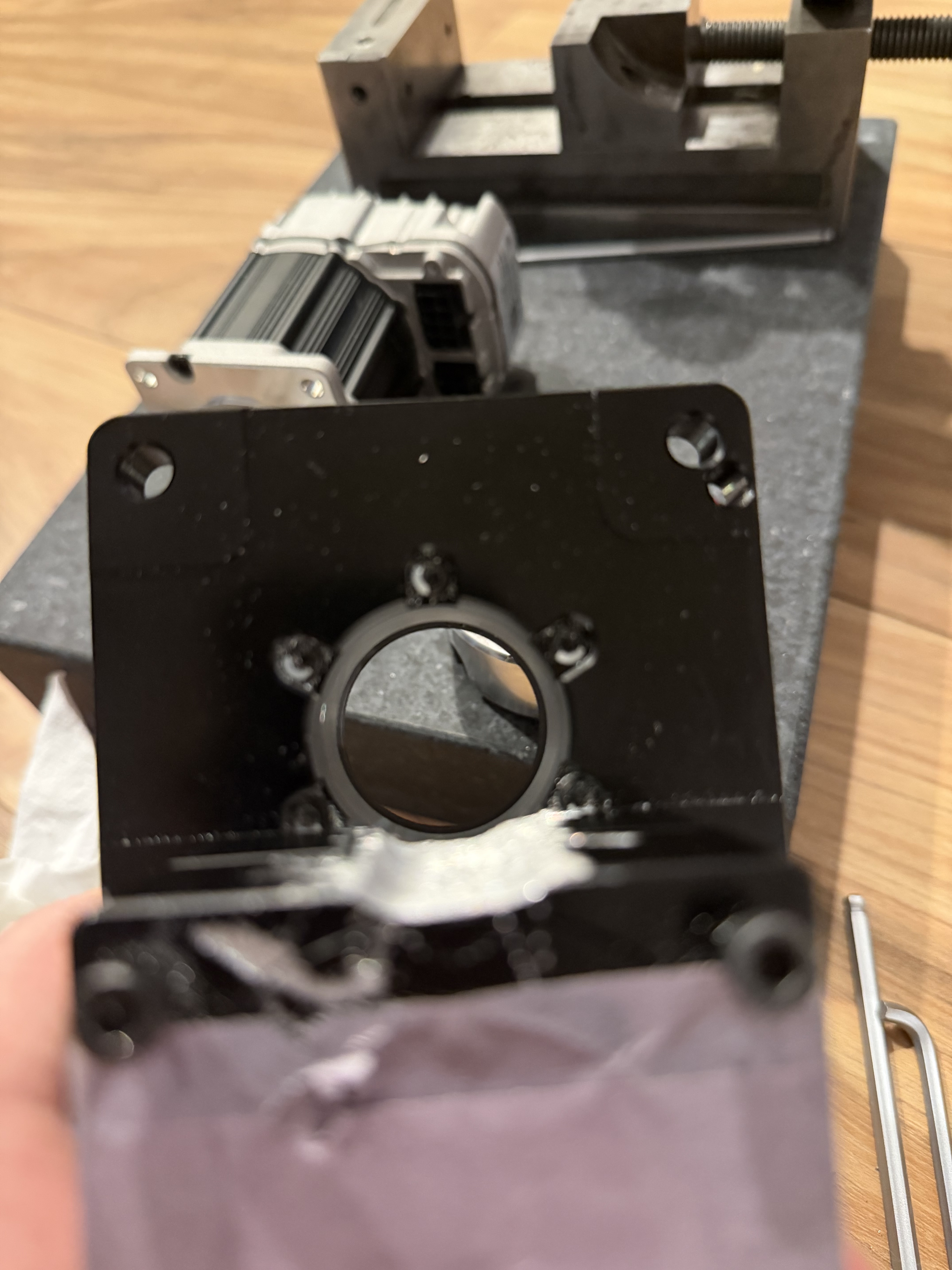

Can you mount the device as shown in the third photo–i.e. does the mounting flange clear the chuck baseplate? I’m guessing so because it doesn’t look rocked up on the surface plate…

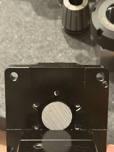

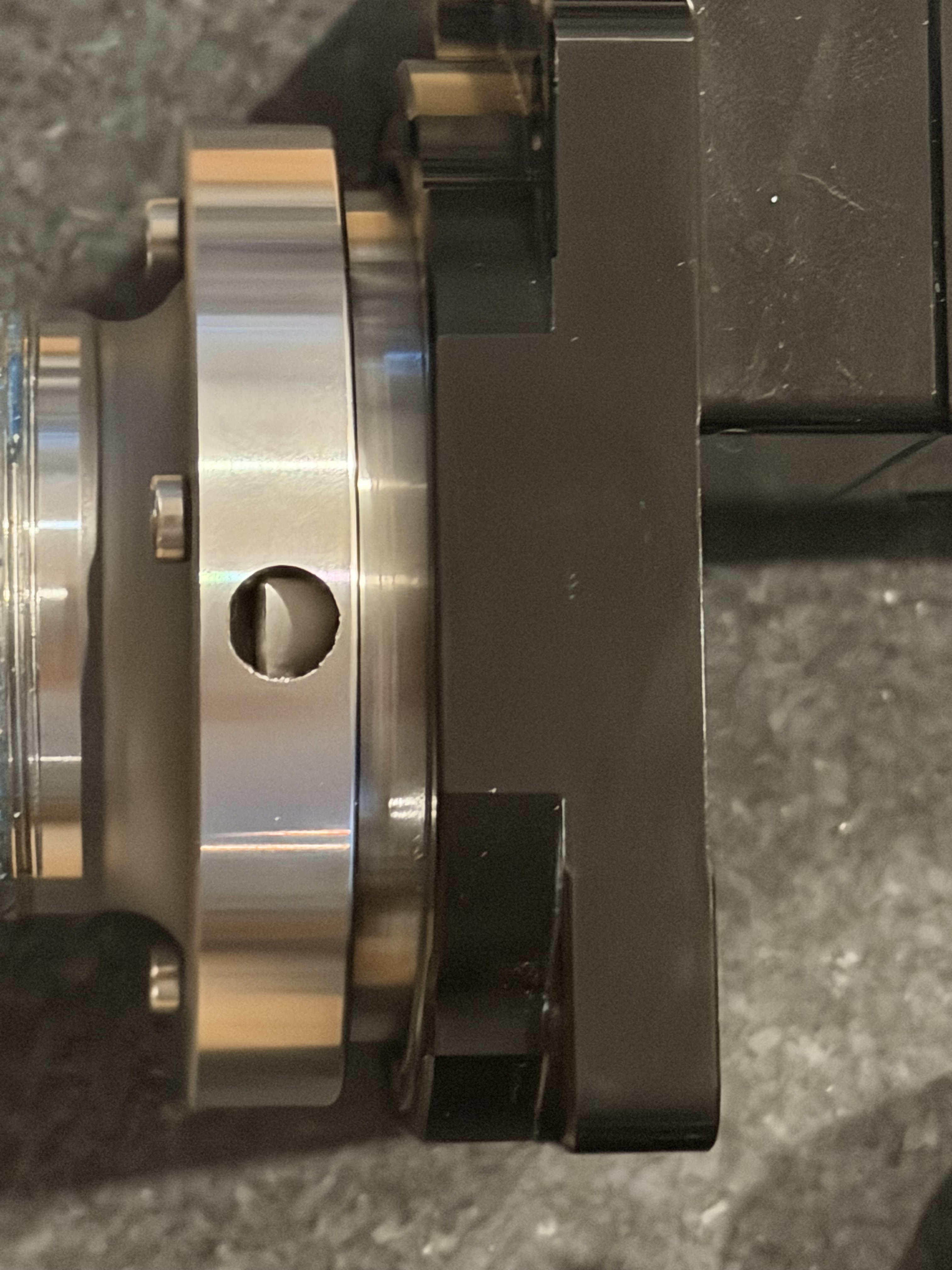

Yep, 1” material in the chuck. Still have to relieve the case of the rotary a few mm by hand to get full clearance through bore:
There is full clearance for the chuck regardless of mounting orientation:
I’ll have to get clever with the auto homing though. Probably a magnet mounted somewhere like the hole that’s no longer necessary. Hall effect for homing sensor :person_shrugging:
And I’ll be making a base plate to ensure alignment with the y axis of the machine. Given the SMW locating pins with the SMW base plate, it should be trivial to make something reasonably accurate and repeatable. In theory :crossed_fingers:

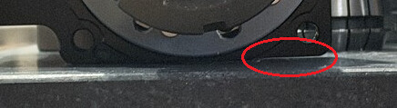

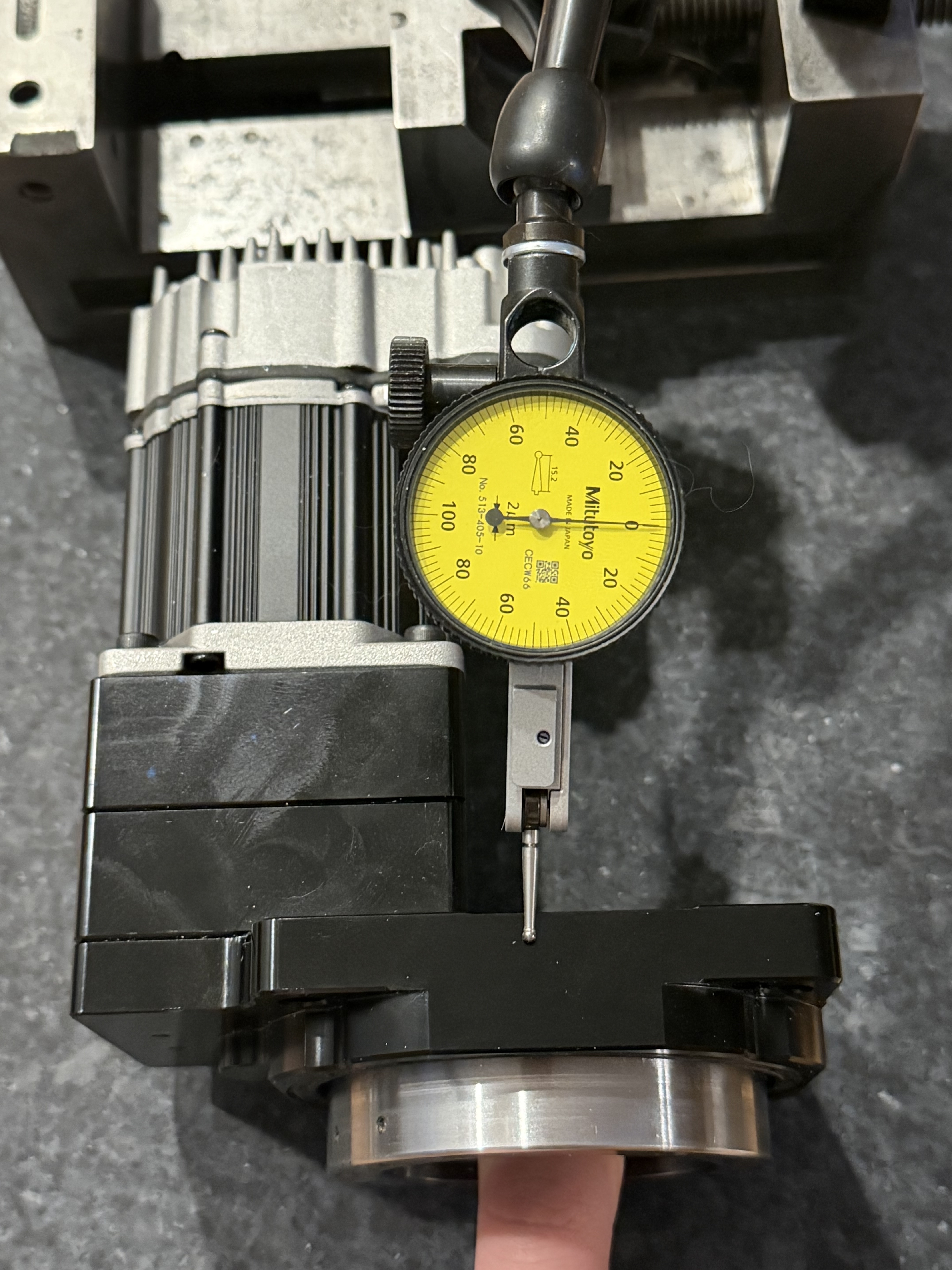

Is that daylight under their mounting flange?
If so, and if there wasn’t a spot of debris under it, I hope that the rest of their machining is better than that one simple facing cut…
:rofl: just a bit of debris. It’s accurate to about a micron across the top (according to a Mitutoyo 2um dti, import quality surface plate, and my own shaky hands…your mileage may vary :sweat_smile:)
:+1: 20characters (probably 18 besides the two of us…) :sweat_smile:
I’m kind of assuming that you will rotate the motor/driver 180° so that its cables aren’t pointing right down the chuck axis, once you modify for thru-positioning the stock… That is one serious looking motor/driver BTW…
I’ll probably rotate it 90 degrees.
The motor driver is the nicest one I could find in this size that has a reasonable chance of spinning fast enough with enough power to do continues 4th axis milling. With the reduction of the rotary gearbox, we need to spin fairly quickly to maintain a reasonable feed.
But yeah, it’s a beast of a little driver and I’ve really enjoyed just playing with it outside of any useful endeavors. It “just works” which is so much nicer than the usual stepper/driver experience.

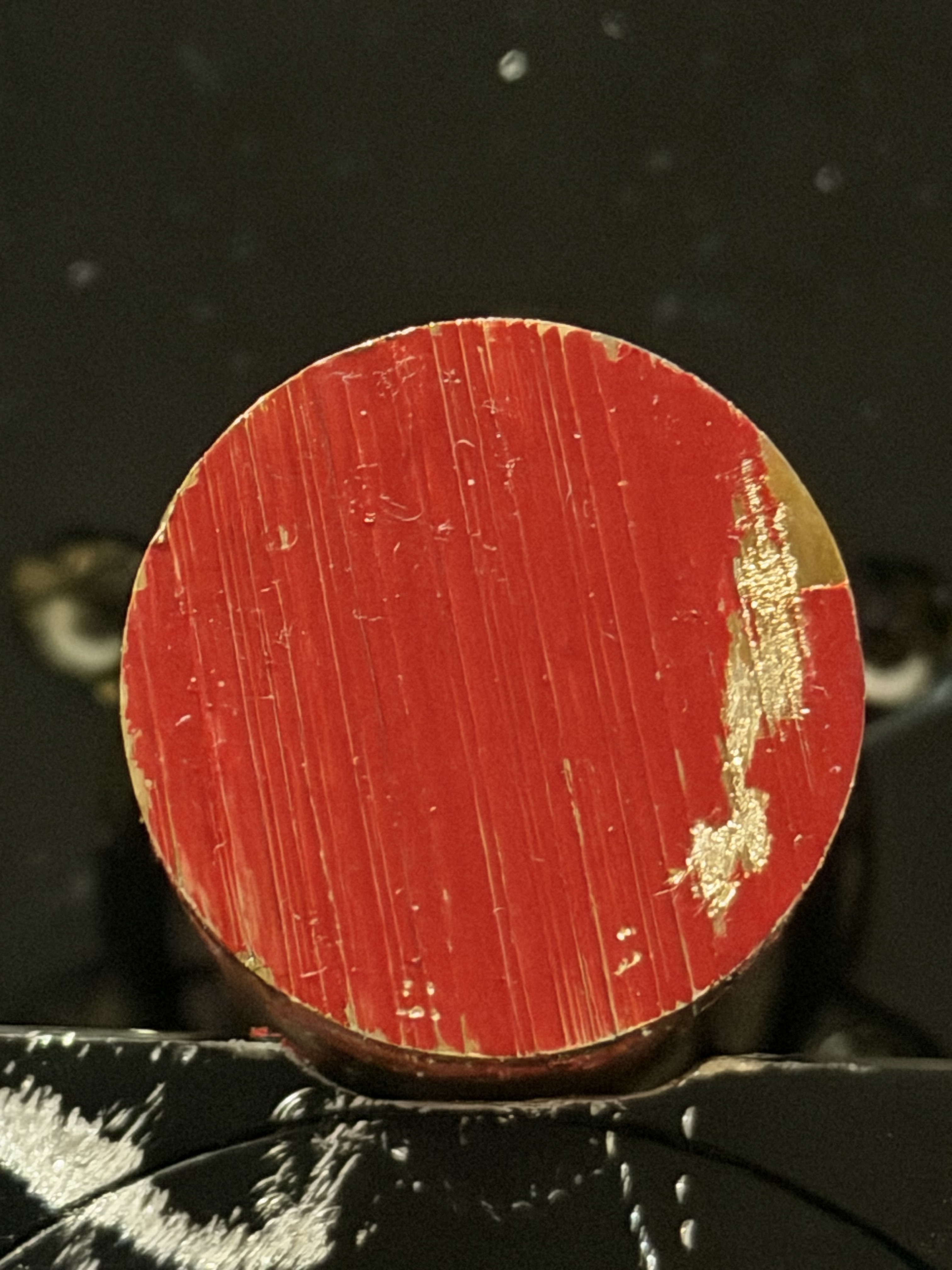

Now I’m not particularly proud of this but clearance is clearance…and with only a jewelry hand grinder, not the worst I’ve seen.

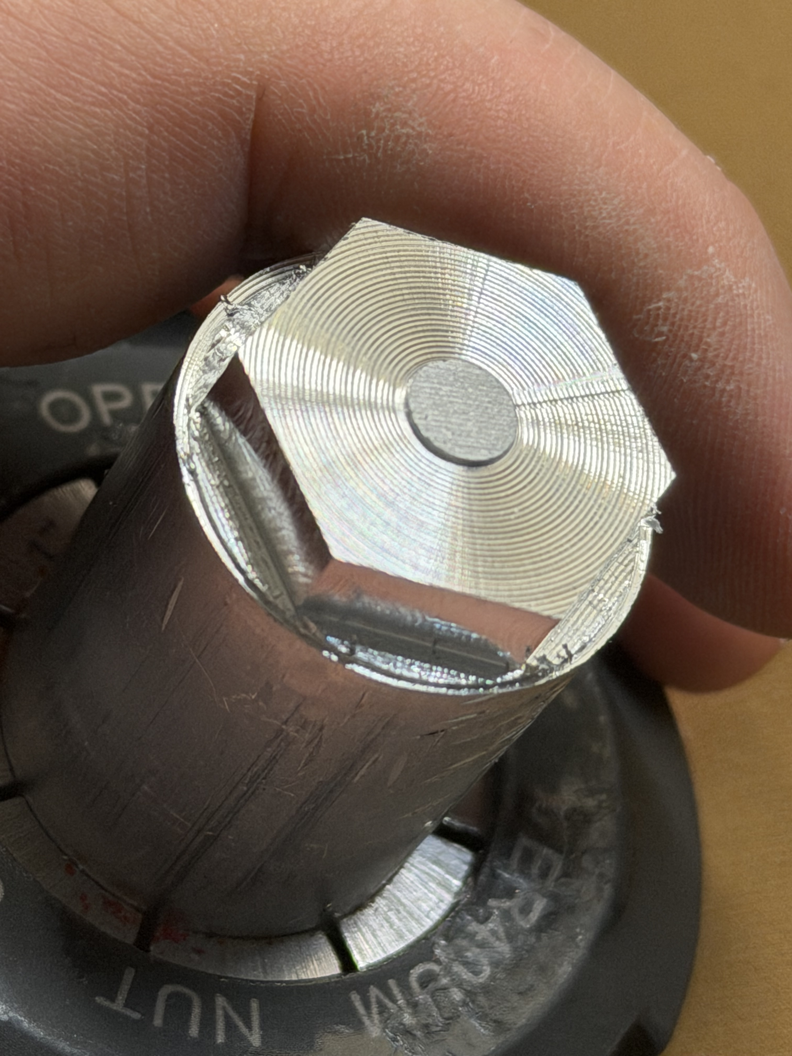

Oh man, it actually works. It really, genuinely, actually works. What a relief :sweat_smile:
That was done with very light cuts because I’m using a 3d printed bracket to hold the rotary to the table. I need to make a bunch of modifications before commissioning one out of something real like steel…though I do have a giant block of 7075 :thinking:
Do I trust myself enough to make the final piece of the puzzle to spec? Probably not :stuck_out_tongue_winking_eye:
That is fantastic, Tyler. Look at the mirror finish on those hex facets! :grinning:
But for the life of me, that facing cut looks like you spun the 4th axis while you were feeding down in Z… For me, that would be a “halfway pressed down on the estop button” situation… :sweat_smile: Much respect to you!

It sure is pretty, though to be honest it’s probably just from such a low feed that the tool effectively burnished the surface :stuck_out_tongue_winking_eye:
