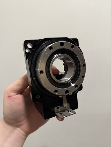

Oh this is a pretty little piece of kit :smiling_face:
I’ll likely use this 85 as the fourth axis but I may pick up the 5:1 60 as well just in case…and because I really like the build and feel.

:+1: :+1: That does look great, Tyler. That is the 10:1? I did some studying of the Amazon page, and see that the 18:1 DN85 has an unobstructed bore (just to keep options open…) with the limitation of only a NEMA17 motor. I would be tempted to go that route, with the same center height of 42.5mm/1.673"
Thank you, by the way, for finding this! :slight_smile:
I think the 18:1 can be made to fit a Nema23 by request. Though it may be a bit more expensive (from their website it seems like it would be ~$30 but that’s just a guess)

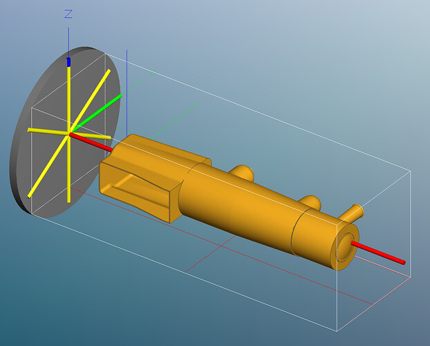

I am assuming since you said continuous fourth axis that you are planning to something radical (and knowing your track record, really cool) about the Nomad’s driver board and Grbl-based control software?
My own mental musing involves an independently-controlled indexing driver. MeshCAM has (or did, the last time I seriously used it–I’m just re-learning it after my extended sabbatical) provision for indexed machining.

Wow, I had to go back to MeshCAM 6 to find the indexed “4 axis” machining setup…

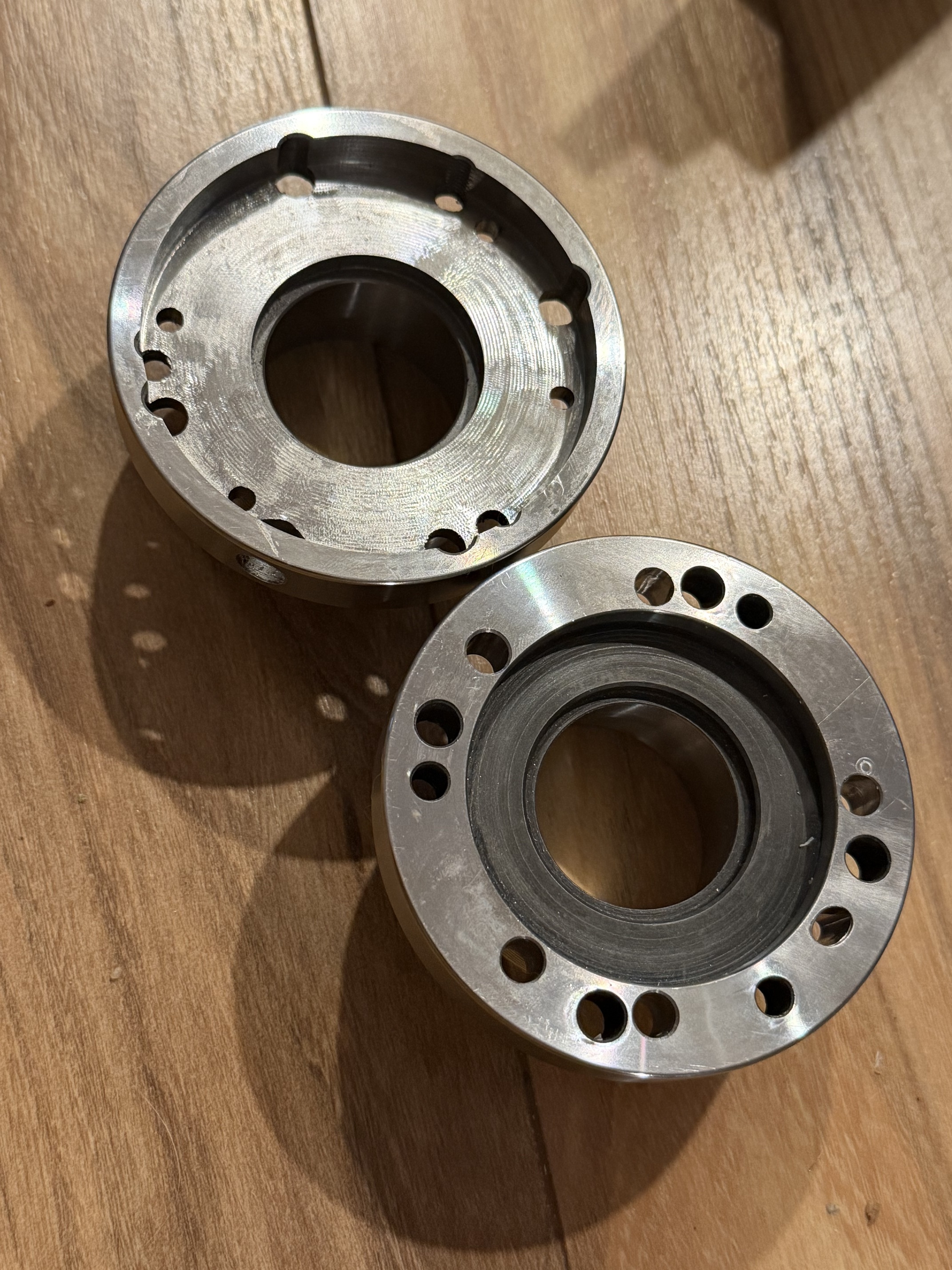

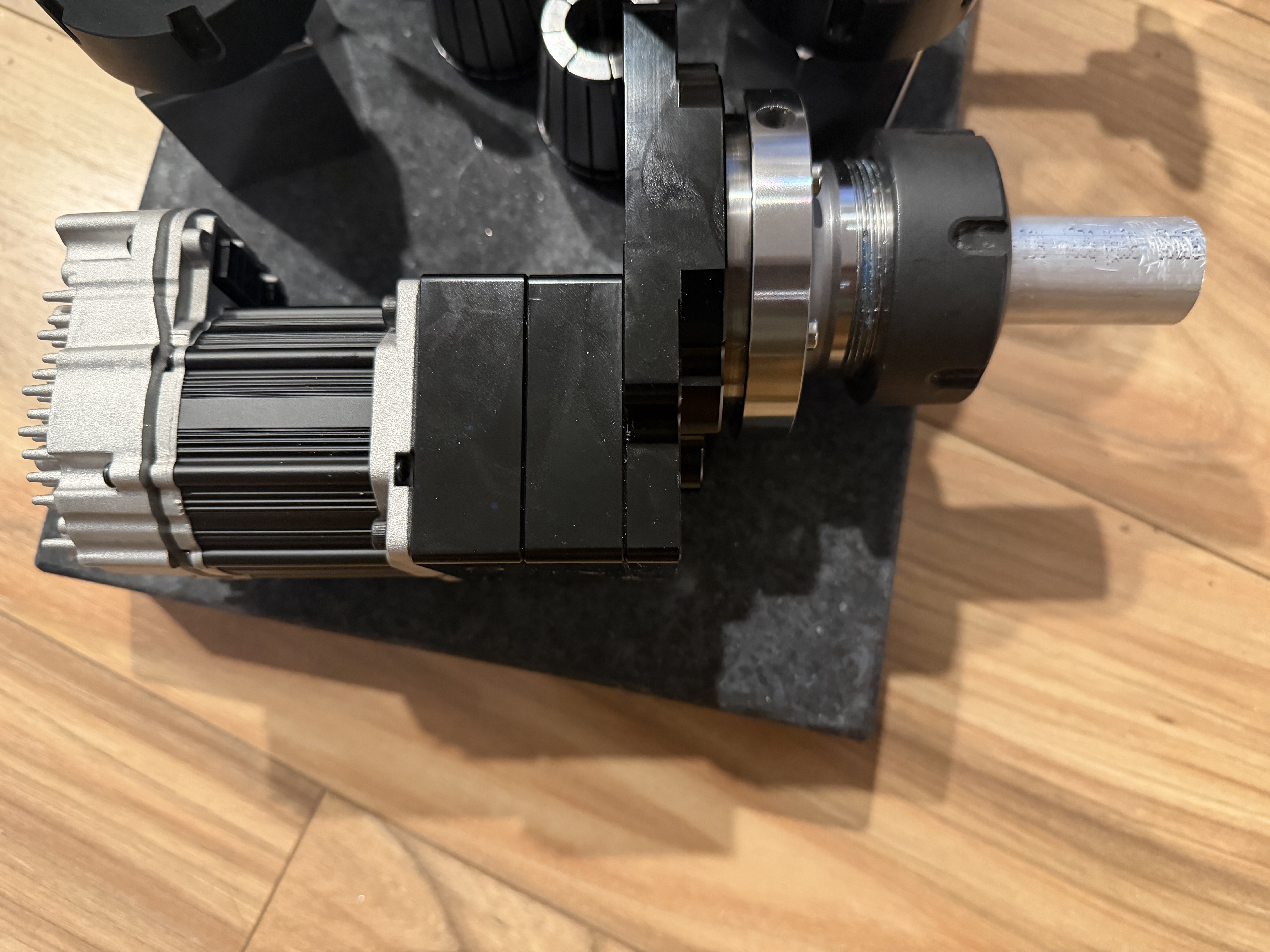

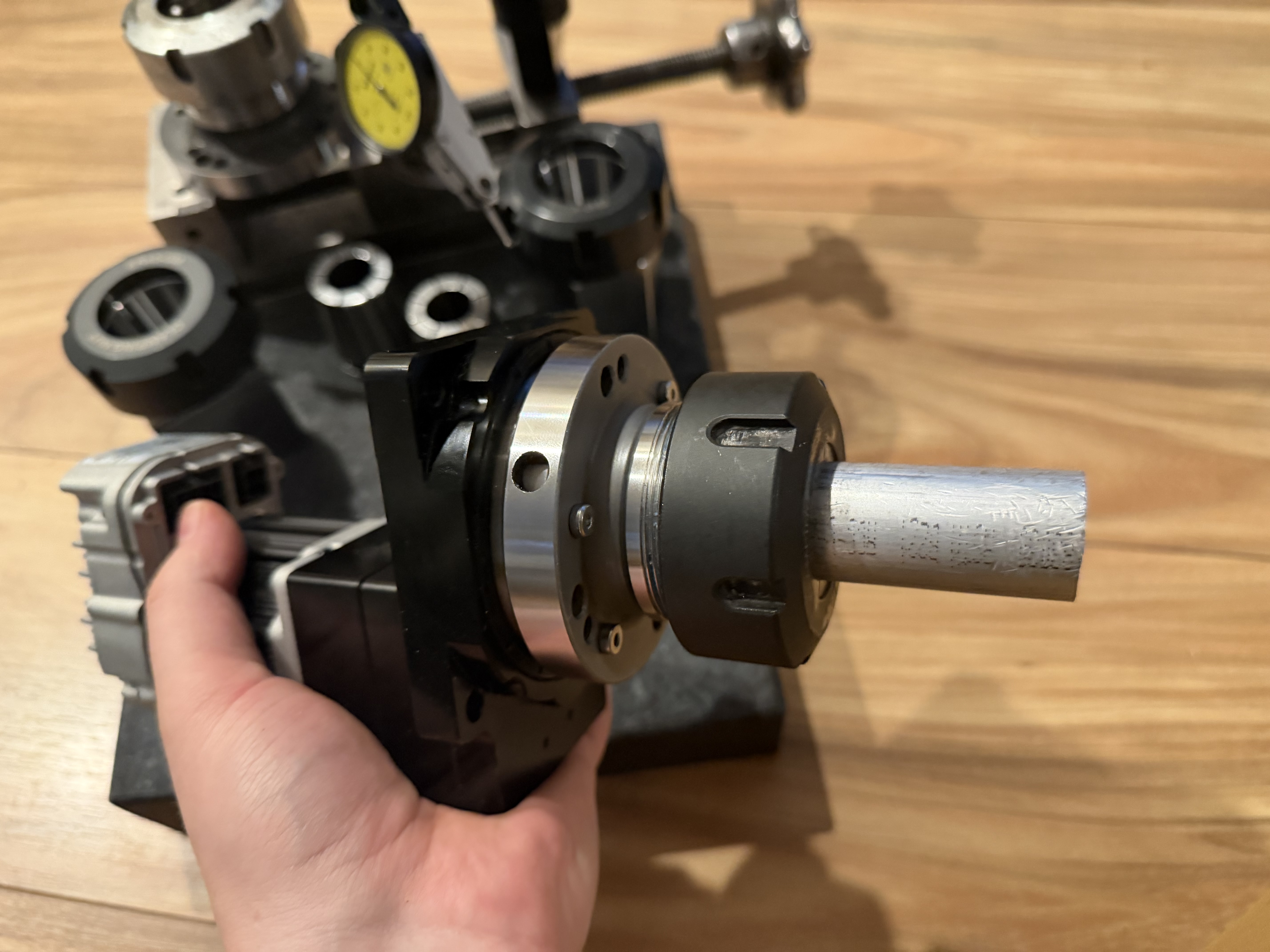

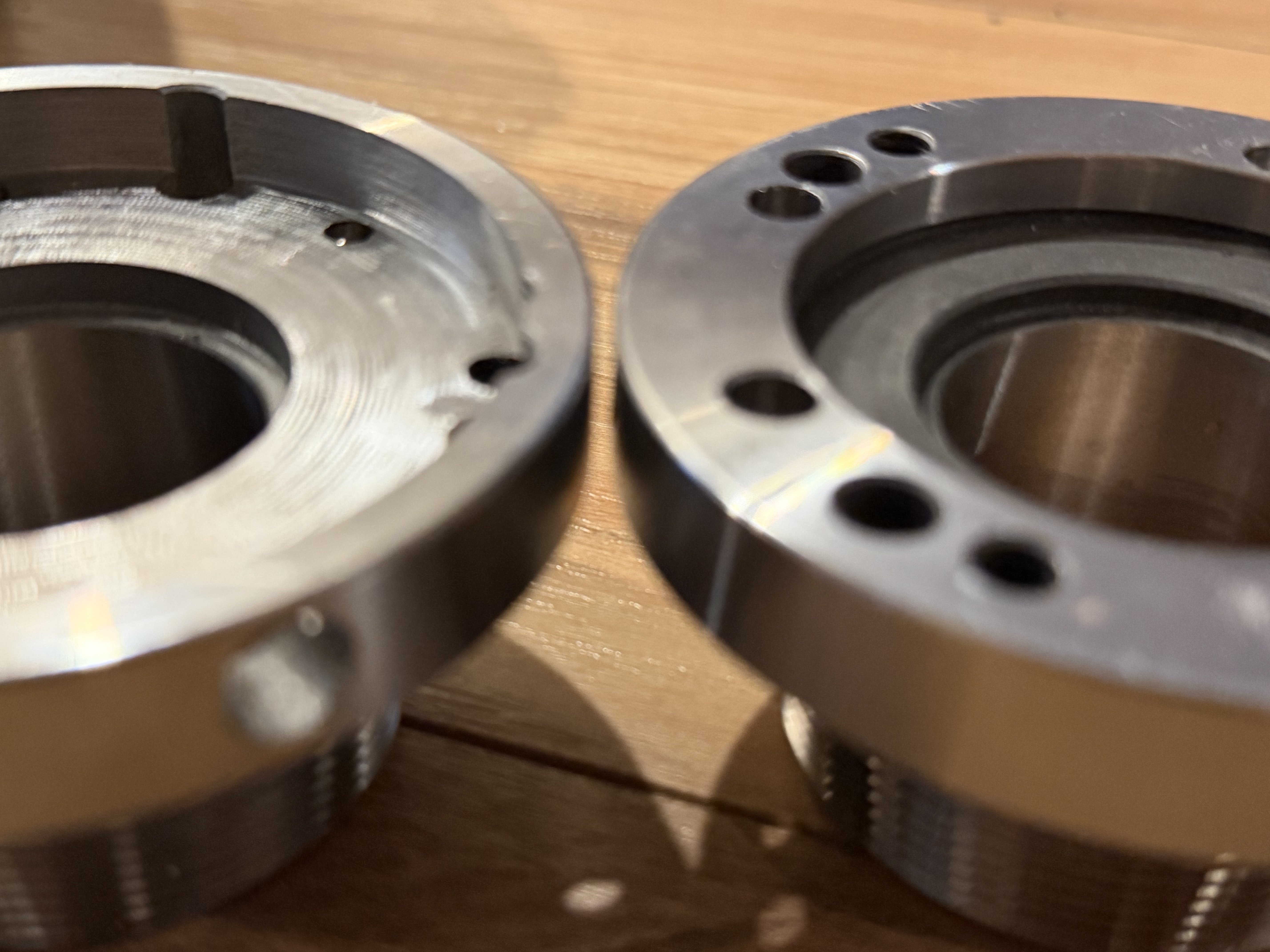

I did a thing. Finally.
Adapted an ER40 collet chuck to the face of the rotary. Very close slip fit and a few clearance bores for 4m bolts.
Here is the relieved and a mostly original chuck side by side:
And the entire thing fitted up:
How well will it work? No idea :slightly_smiling_face:
But once I find out I’ll update the thread with lessons learned.
Looks beefy. New controller? Or wire the y-axis driver into the rotary stepper?
