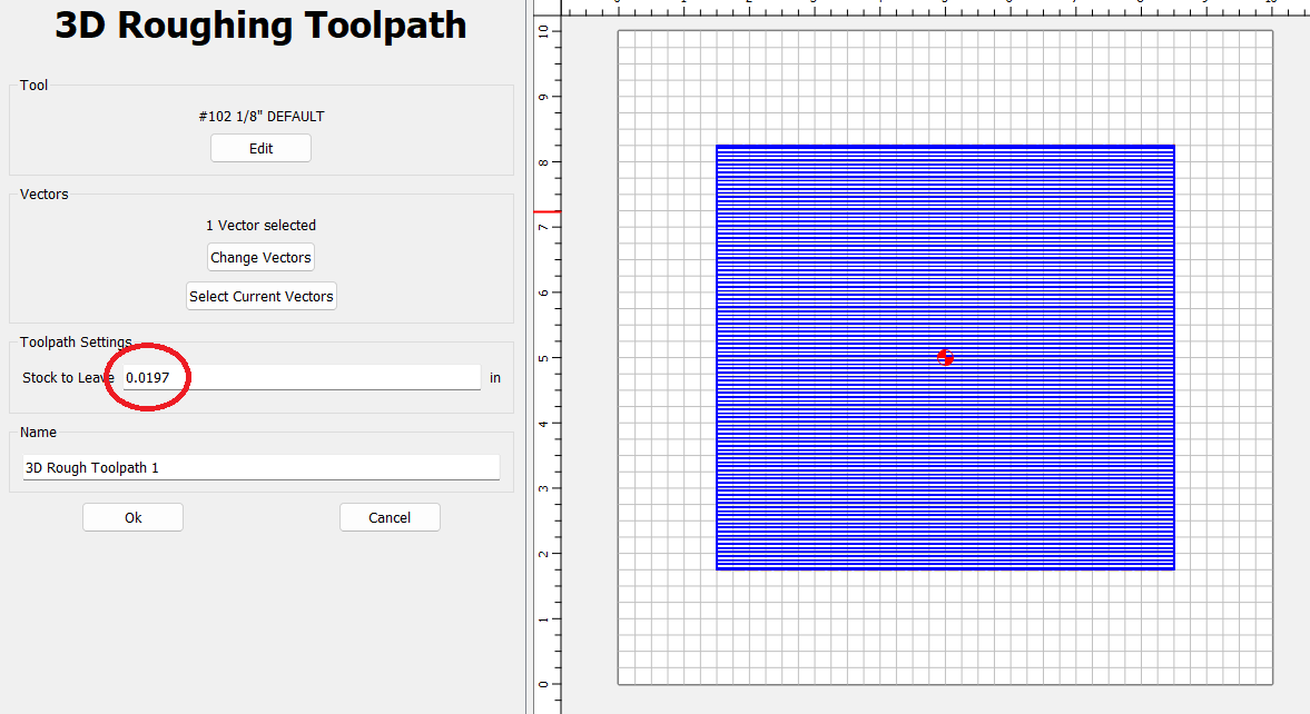

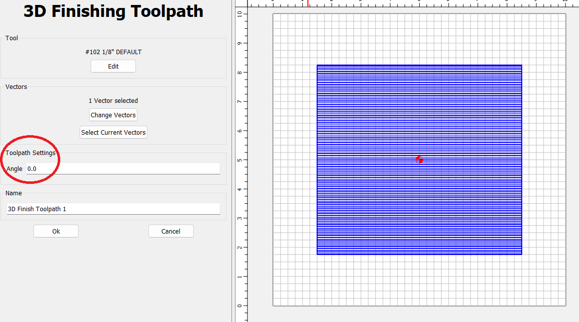

Yes there is a roughing pass tool path and you set what to leave. Then you do a finishing path and only the amount left is removed. You sometimes have to run the finishing path a second time to get a really smooth finish. Roughing and finishing fall under the 3d umbrella.
The roughing and finishing work on 2d as well as 3d tool paths. Here is an example of the roughing on a simple square 2d path.
