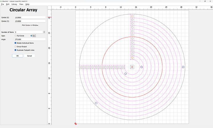

The problem is we are looking for a round one - 28" or so and I don’t know where to start

Then it is simply a matter of selecting a circle from a begin/end point and using Circular Array:
to duplicate as needed around the course…
Count the circles on the track and select a set which have the same number:
and repeat for each:
and if need be go back and repeat since one fewer was necessary.
