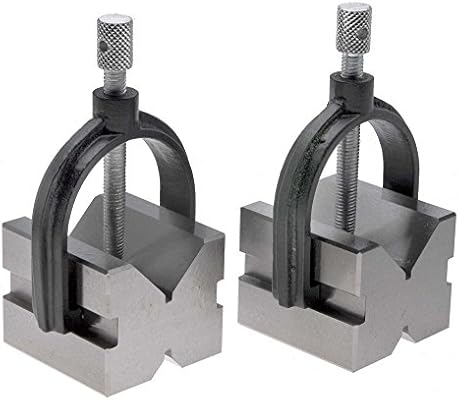

I think you got the sticking point - low profile. Not sure what your accuracy requirements are, but a set of small V blocks in a low profile vice perhaps?
Ya something like that could work. I ordered a super cheap mini lathe chuck to experiment with. We’ll see how it goes

Have you thought about a small set of v-blocks? These are 1", I’ve seen others. A little flat filed on the end of the stock makes for a decent flip reference with square.
