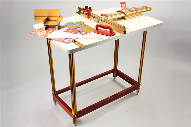

Another system I like is the Incra system
I used this system and it gives you lots of workable area to do large projects and it can be customized in endless ways for tool and accessory storage. The system allows for repeatable cuts and really good accurate results.
The porter cable router is not available but there are other good choices out there.
I would agree with this but it would be If I had the extra room in my shop I would have both the JessEm and the Incra setup.
I use the JessEm setup as my go to one. The Incra system Is my brothers main setup.

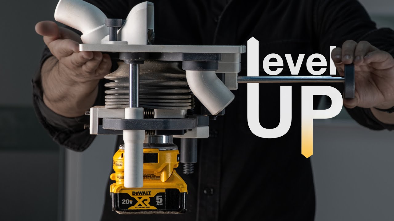

If budget is a concern, I’ve been thinking about trying a lift system from USSA: https://www.ussadesign.com
The YouTube channel is :fire: too:
I picked up the pioneer router jig awhile ago and I just love it. Great design and consideration coupled with exceptional quality. I’ve got no reason to believe their router lift systems would be any different :slightly_smiling_face:
( Also check out their 3d printed diy plans if you are on a shoestring budget. The digital products are as polished as the physical in my experience so far! # notsponsoredIPromise :sweat_smile: )
