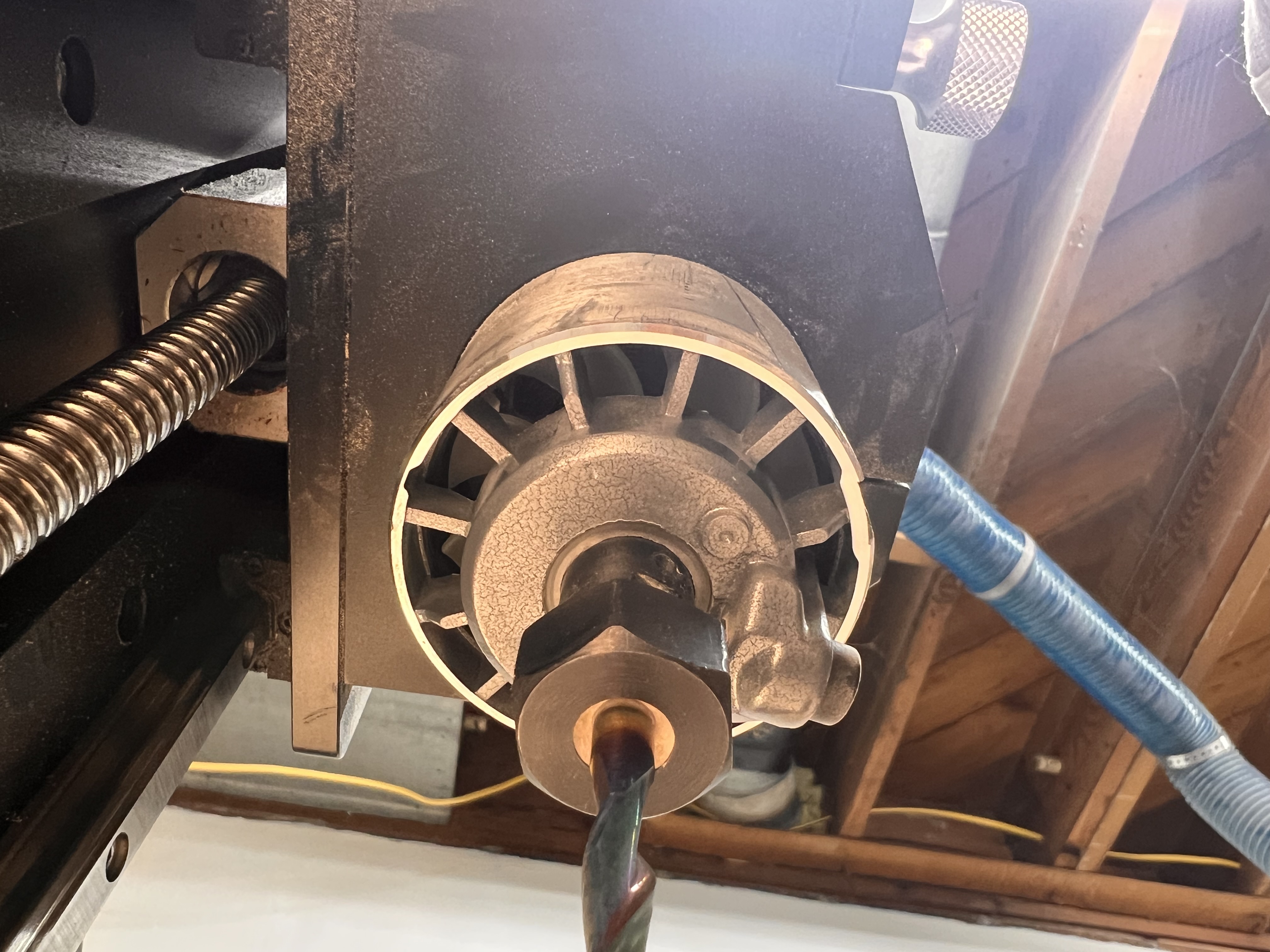

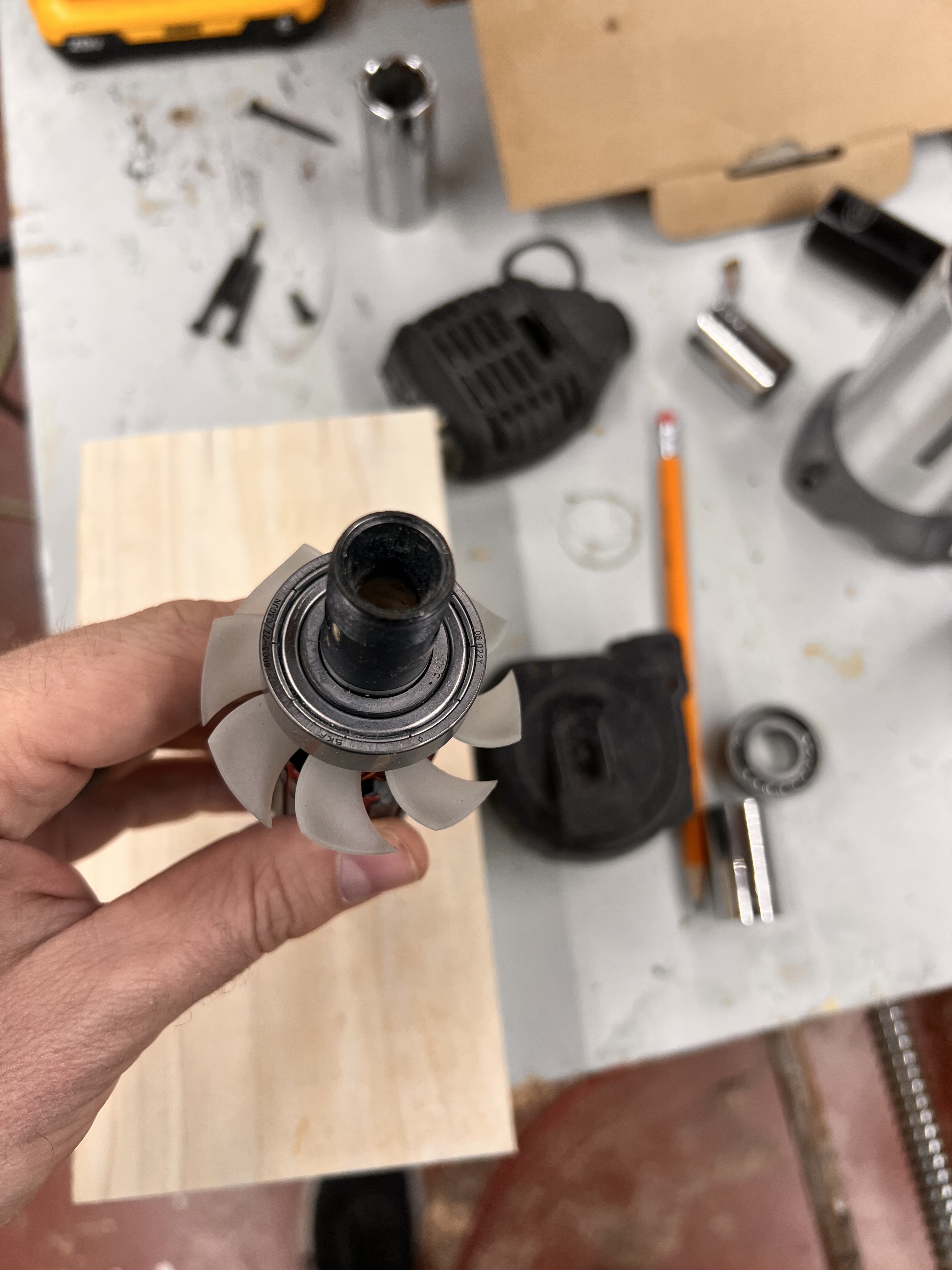

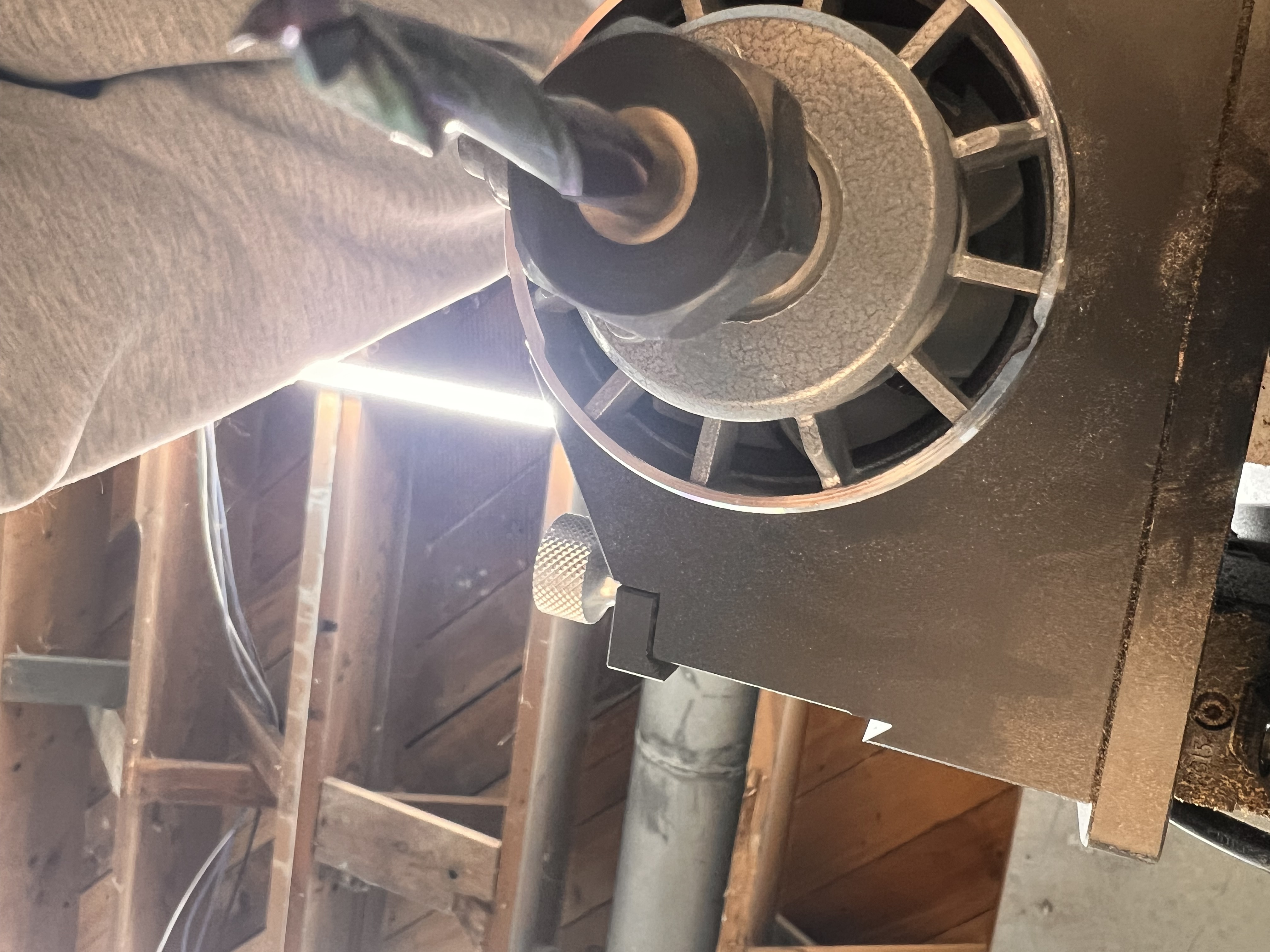

Anyone else have issues with the lower bearing on their router. I decided to pull one a part and see if I could see the issue.

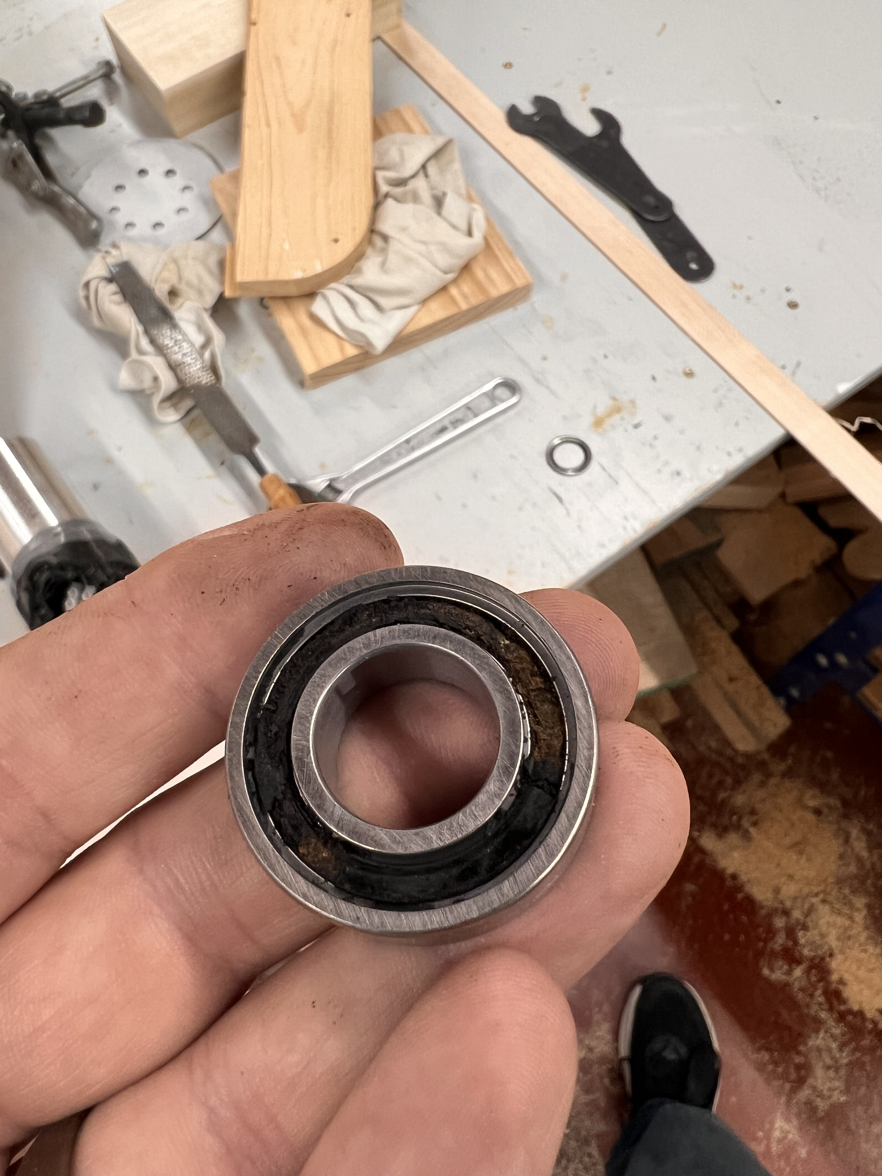

Turns out the lower bearing is the culprit.
I am wondering if dust is getting in the bearing i wouldn’t think so since it is sealed. But I have thought about putting a filter on top of the router to see if that would help.

The Makita and C3D router have well documented issues with bearings. It is almost always the lower bearing. There are kits to rebuild the router but the price is almost as much as just buying another C3D router. The c3d router is a clone of the Makita 701# routers and use many of the same part.
Here is a kit on ebay: It is just the bearing is about $22.00
Buy the time you tear it apart, pull the bearings and rebuild the router a new one from c3d might be cheaper and less aggravating. Currently it is $80.00 or so.

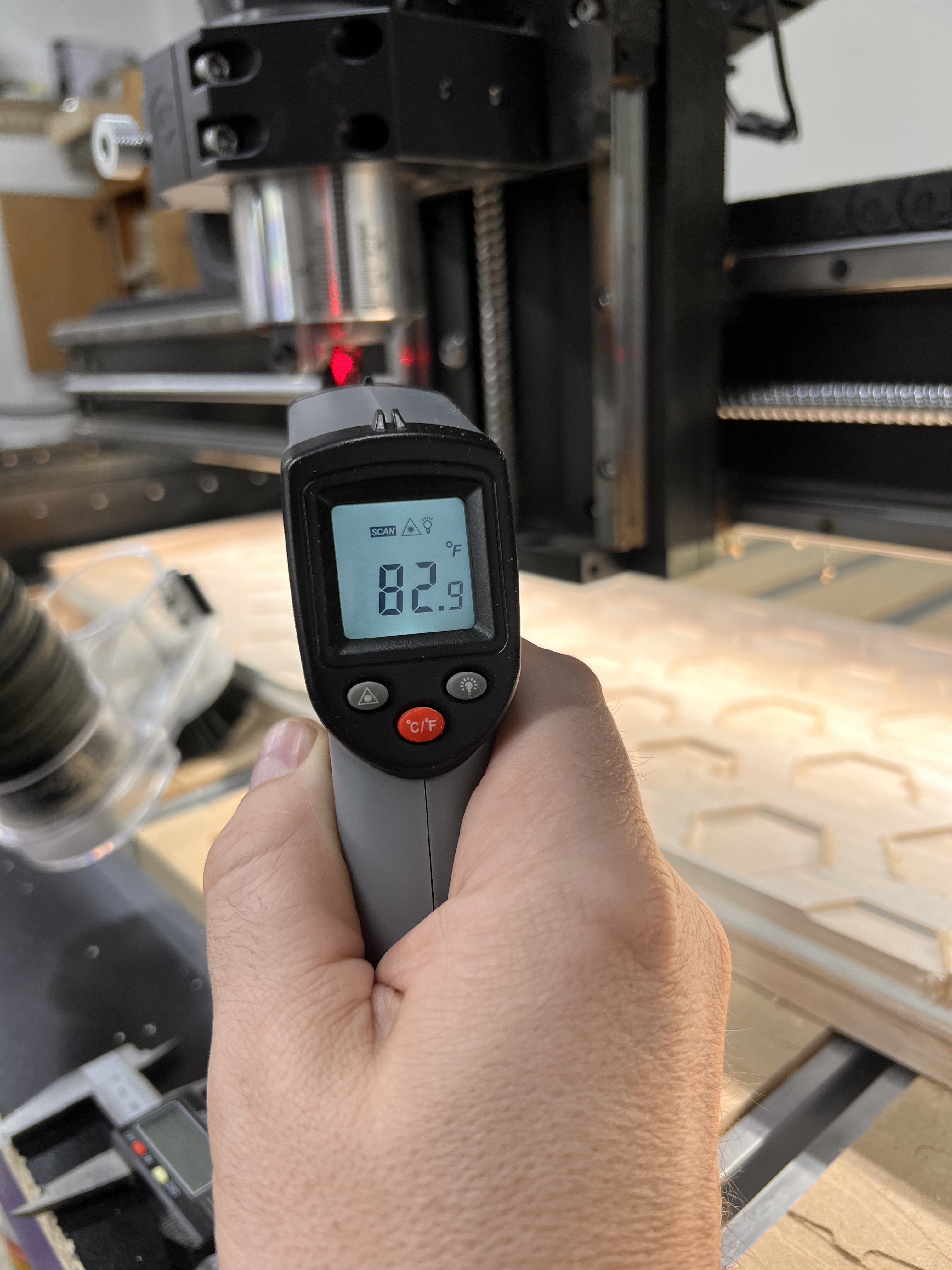

New bearings arrived yesterday! Quick install, just finished a job very little heat in the lower housing and collet.
