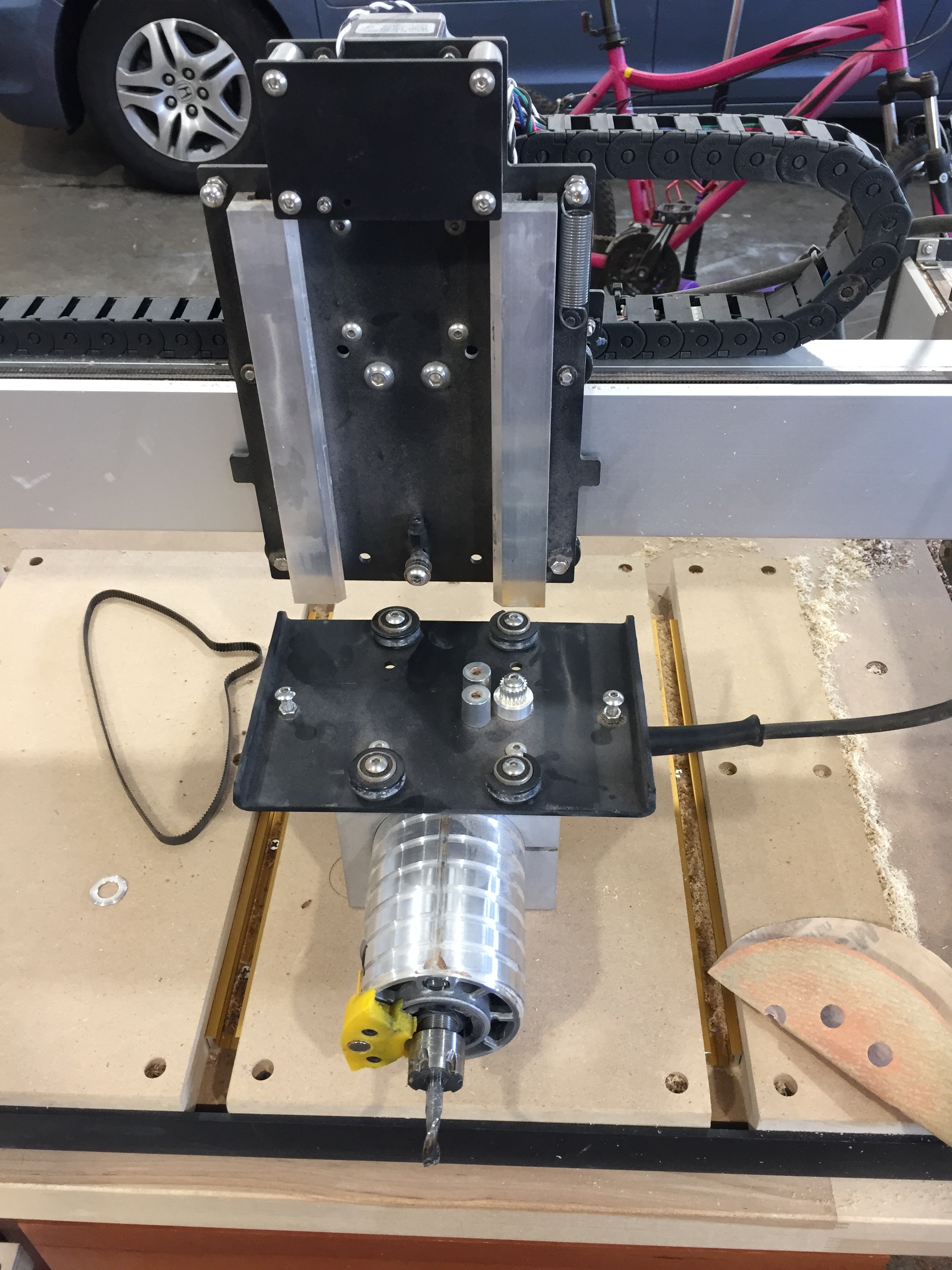

Router carriage came off the rails!
I wanted to share a mishap I had on my shapeoko xl this weekend, mainly to point out where I think I made mistakes, to help others avoid this if they are like me and didn’t think of this. I use double stick tape to hold many of my projects, and I got a bit lazy and only put one piece along the length of a 3”x5”x1/2” piece of Baltic birch. I also pushed that piece up against a cleat on the one side, thinking it would help hold the piece a bit. Well, I thought wrong. Half way through the project, the piece cut loose. Next thing I know, all heck is breaking loose. What I think happened is that the piece broke loose, lifted up a little bit with a z axis command so where it was spinning above the cleat, then went back down and hit the cleat all in a blink of an eye. Next thing I know, the router flew off and was bouncing around on the table top while the steppers were pulling it around. It turns out that a couple if the v wheels were broken, allowing the carriage to fall off completely. It ended up damaging a few other things and my dust boot completely disintegrated (I didn’t have it hooked up to dust collection at the time). Luckily I had bought a maintenance kit so I was able to get it back up and running. I just wanted to share as I was surprised at how fast it happened and I had not pictured this as an obvious failure mode.

I hate seeing bad things happen, but at the same time I love seeing bad things happen when they work out ok with no injuries or serious damage to equipment. It’s the perfect little reminder of why I sit within arms reach of my kill switch during all runs on my SO3. I had a very well clamped (or so I thought) piece of 3/4" maple break loose last week, but I caught it before it did any damage beyond damaging my chunk of wood. Had I been away from the machine it could have been much worse. Thanks for the reminder!
