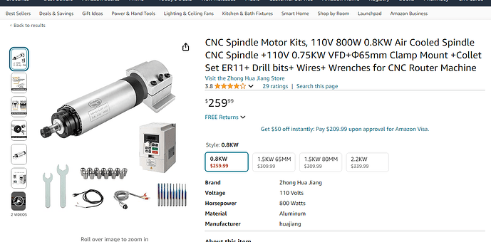

Id love to go with the vfd kit from C3D but just cant justify the cost for how often i use my machine. Ive looked at some of the kits on amazon and like the price a lot more but worry if i run into trouble with it.
I felt the same way, so I took the leap to find out.
I’ve had it for a couple of years now, run a ton of jobs, and it’s still working good.
