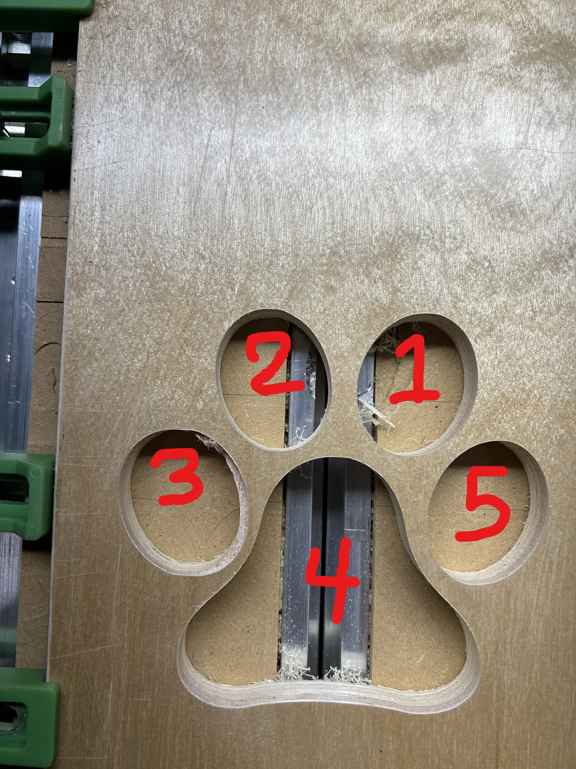

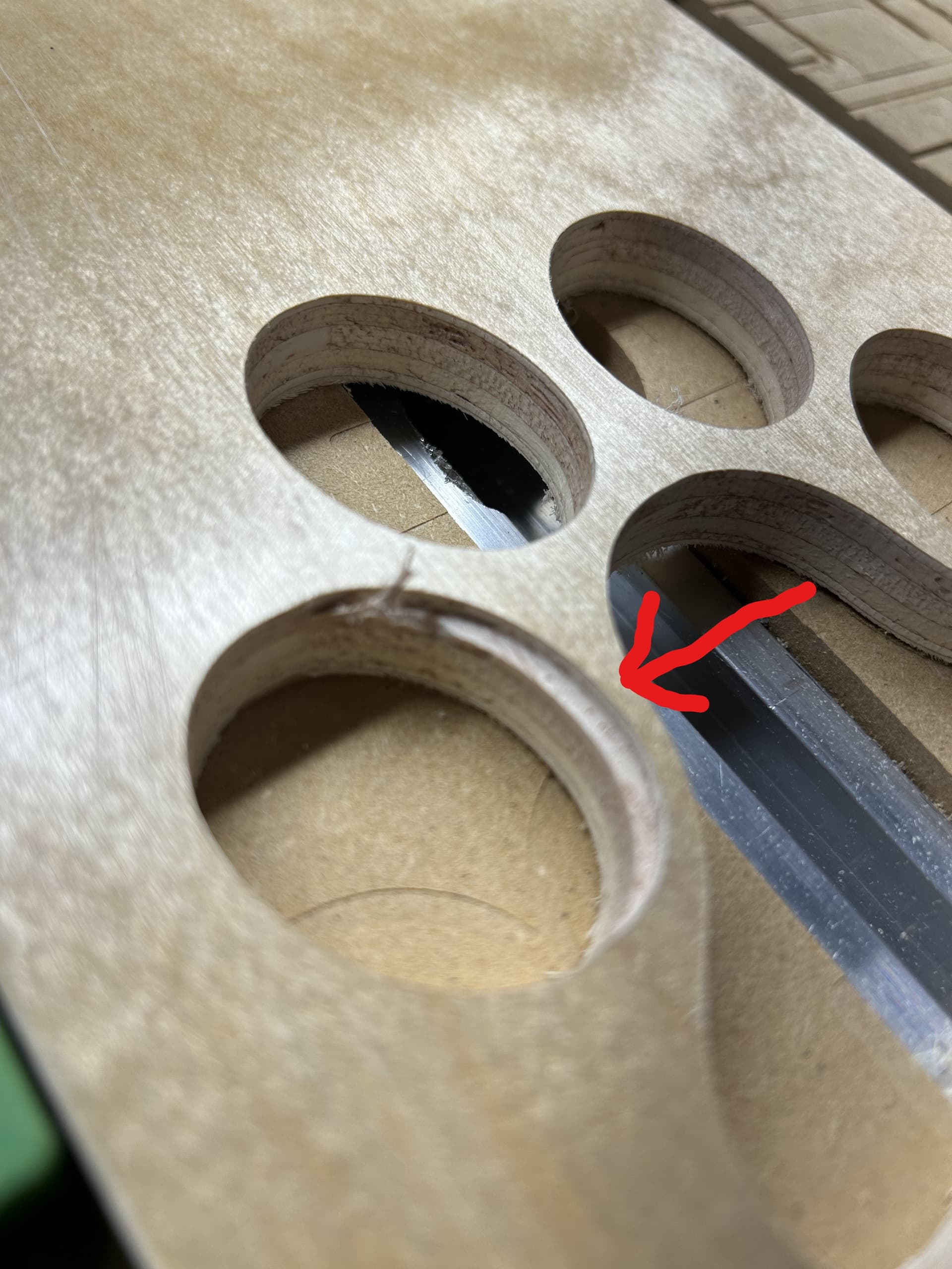

Recently I have been encountering an error when running a file. I have made 50 - 60 of these previously with no issue. What I am encountering is my Pro XXL during a pocket hole cut in creating an oval cut, the router will stop just slightly on the x-axis; just a split second. This causes the subsequent cuts through the pocket to be off slightly leaving a lip and making the oval out of shape. In the photo I have labeled the sequence of cuts. This is not a complicated design; 5 pocket holes all using the same bit (#251).

This is either mechanical (check the machine mechanically, including lubrication), some sort of interference (a dust hose or cord or something else kept the machine from moving at some point and steps were lost), or electrical (a wiring fault kept a step from being made), or an issue with toolpath/tooling engagement (the tool was trying to remove more material than it was able to for a given move, or got pulled into the cut).
Check each aspect, and address as necessary.

I have gone as far as to disassemble the carriage which holds the router. My purpose was to review all the wheels and apply some oil, from the kit ordered on Carbide 3d, to the rollers which move the router on the x-axis. Individually I applied oil to each of these small four rollers and ensuring they move smoothly along their tracks. This was completed one at a time to help keep it all aligned. However, I noticed after this when moving the carriage with the steel plate and four small rollers left and right by hand, there was small resistance at one point along the track. A resistance was not so great that it stopped movement, but required a little more pressure when moving it by hand. The reason this caught my attention, is when the small rollers were moved left to right individually they move very smooth. When they are collectively attached to the plate and moved left to right, they came across this point. Is it possible that the guides these rollers slide on move a little? Possibly bow a little due to climate change? I can see this area being a potential area impacting movement.

Post a photo of the part in question?
How much movement (or non-movement) is there?
