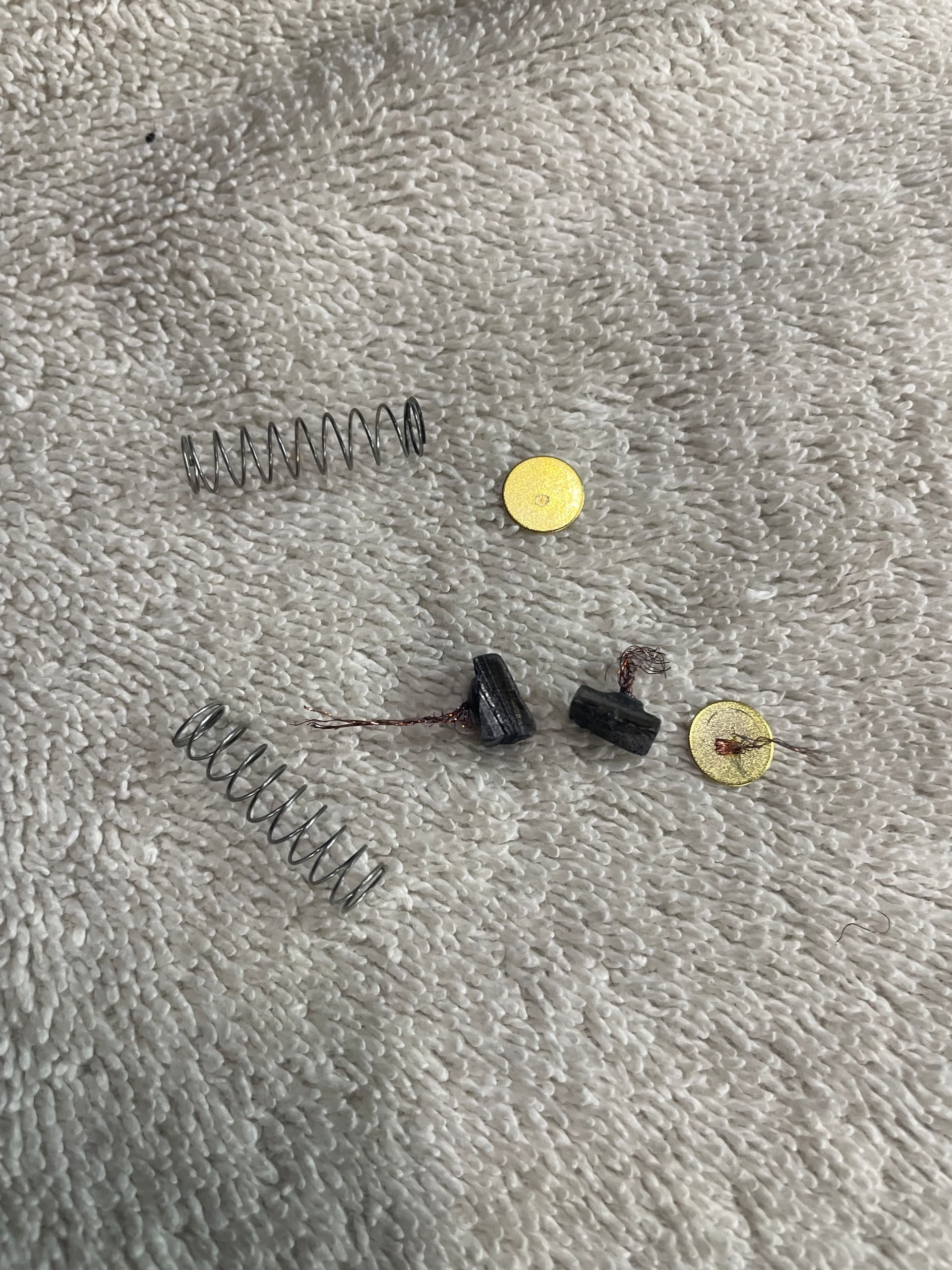

I hope someone can help us with this issue with my router. About 3 weeks ago, the router was “clicking” and sparking. My husband changed the brushes and all was good.
And in just 3 weeks, it started happening again. My husband opened the router again and the brushes were destroyed. I’ve never had to change them out so soon.
Well, when it was turned on, the sparking was still happening. I have a video, but I don’t know how to upload it. :frowning:
I wasn’t working on anything other than what I usually do. Nothing aggressive.
Can anyone offer any insight on what could be the problem? Or do I need a new router? This one is approximately 2 years old and I use it pretty frequently.

Are you cutting any materials now that you didn’t do much before? Anything that might create particularly abrasive dust?
Does you dust collection setup seem effective?

Thank you for answering. It’s the same pine we’ve been doing for years. He also cleaned the router with compressed air where the brushes go and where the vent is. We only contour the wood.
We have the same setup we’ve had for the last 4 years. I have started cutting sheets of PVC lately, but it’s here and there. Could that be it? I’ve been doing the PVC for about 6 months now.

We do cut a lot…could it be simply worn out?
It could also be a worn, damaged or dirty commutator. This is the surface the brushes ride on. If it’s in rough shape you will burn through brushes very fast.
You can get a replacement kit for the insides of the router pretty cheaply. It includes the armature, bearings and everything you need. Search online for the replacement kit for the equivalent makita router.

The C3D router is a clone of the Makita 701 router. Both of these models have issues with the lower bearings failing and the brushes wear out very fast, not as fast as you had. If you are running production maybe it is time to upgrade to a spindle. You might get a Makita for a temporary replacement but long term you should invest in a spindle.
