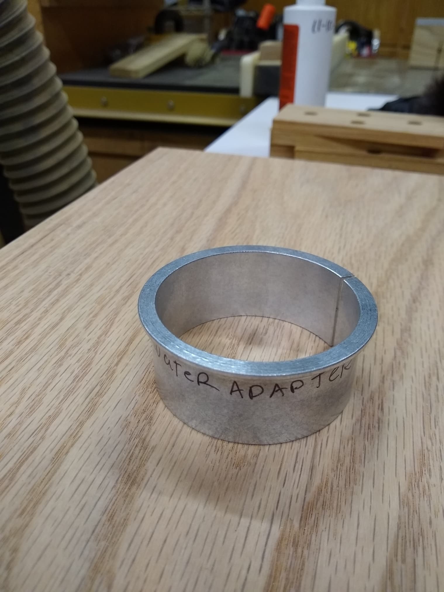

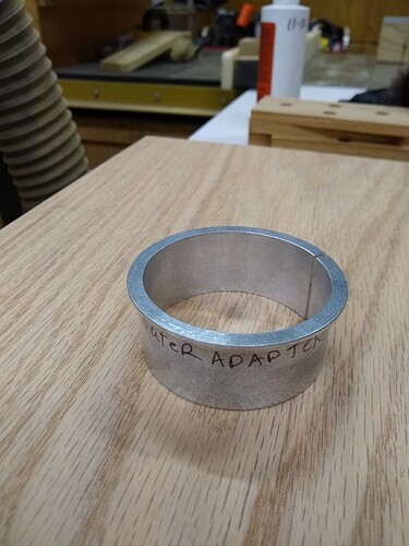

To put an end to the brush eater, I just picked up the Dewalt (DWP611) as I understood it fit the stock mount but after driving 2 hours to get it it appears that was not accurate as the collar is far to small to accomodate the DWP. FML.
The stock mount on the Shapeoko 3 fits the 69mm DWP611/D26200.
If you have an SO4/Pro then you need the 69mm spindle mount:
There is an insert inside of the collar that you take out if switching to the DeWALT. It took me a few minutes (ok, hours) to figure out that the spacer was in there.
Hope this helps.
William I think the reducer ring only applies to the original router mount for an SO3. The machine in question is a 4XXL so it likely came with a Z-Plus and likely a 66MM router mount when the machine was purchased.
Here is a picture of the SO3 69MM router mount reducer to make a Makita/C3D router work.
