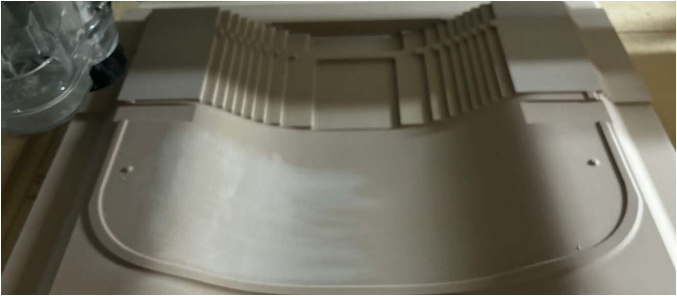

Hello all,

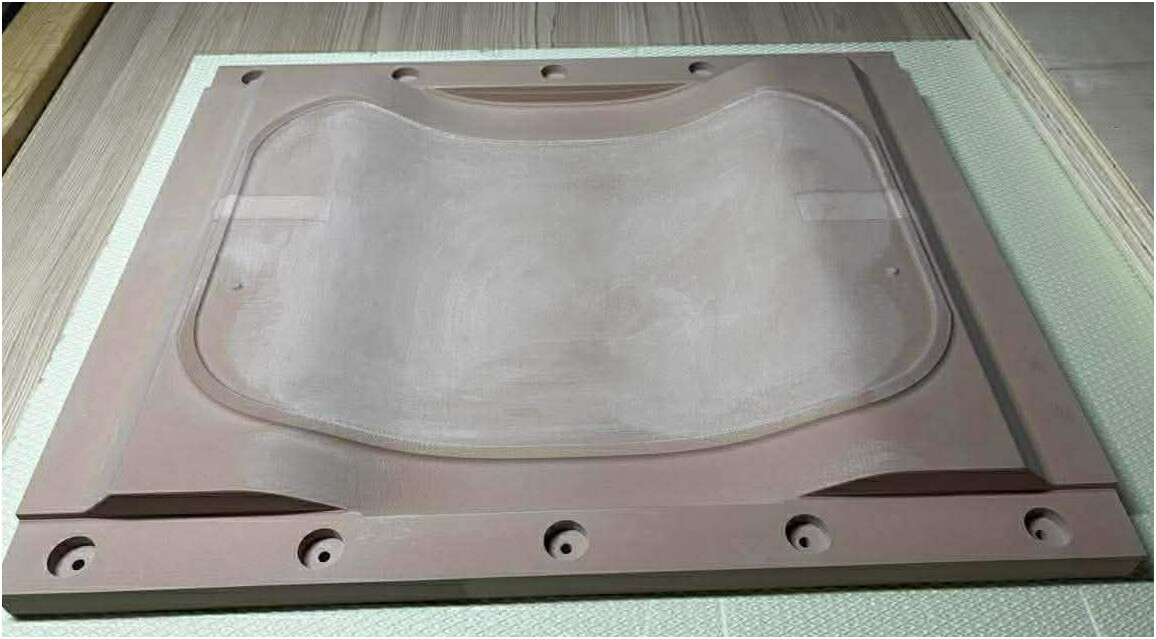

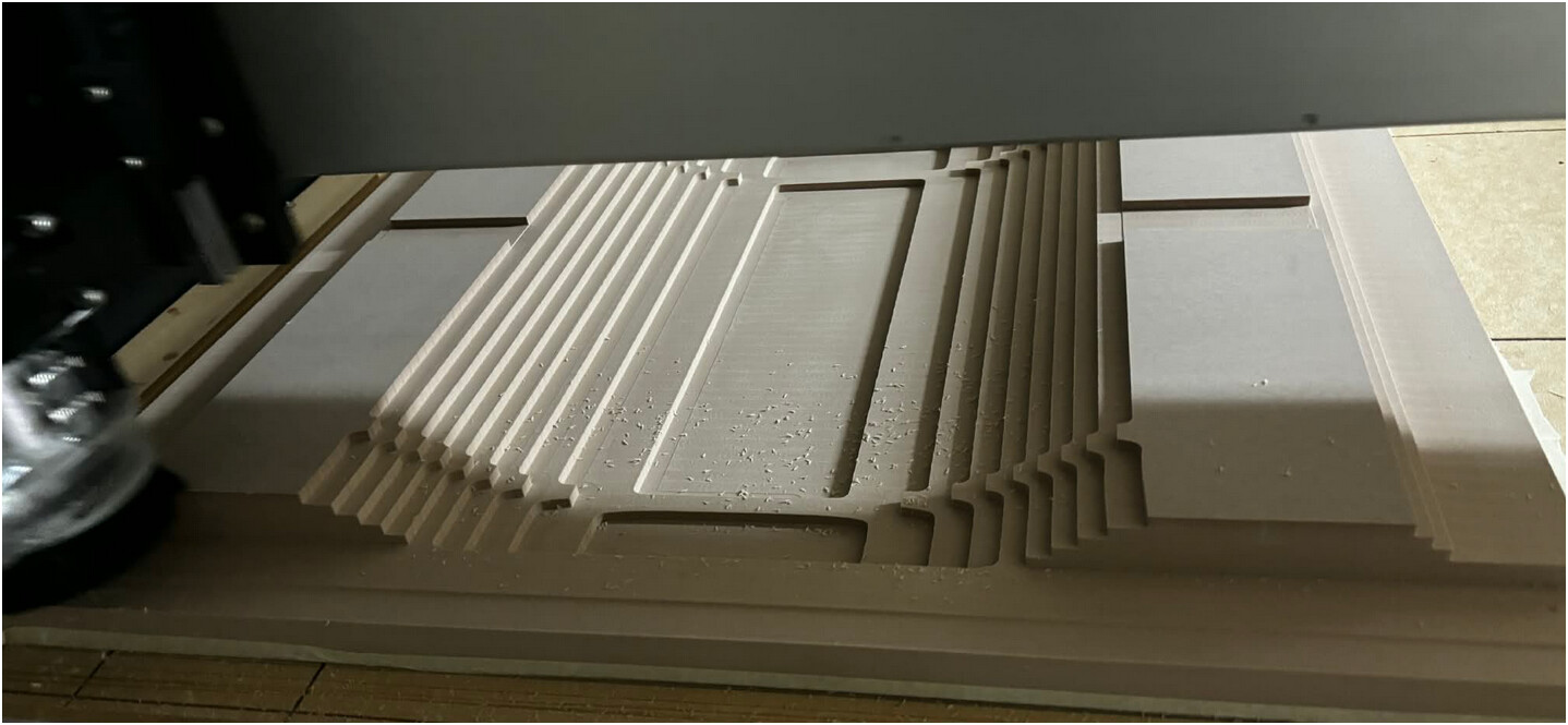

i have an issue, when the machine got stuck ( chipped wheel - not sure why ) on Y axis when doing a 3D rough toolpath and it did cut material where it was not suppose to.
Now i would need to change the file to run only a portion approximately 10 cm of 3D finish toolpath.
The model sould look like this :
When it finished the 3D rough toolpath it looked like this :

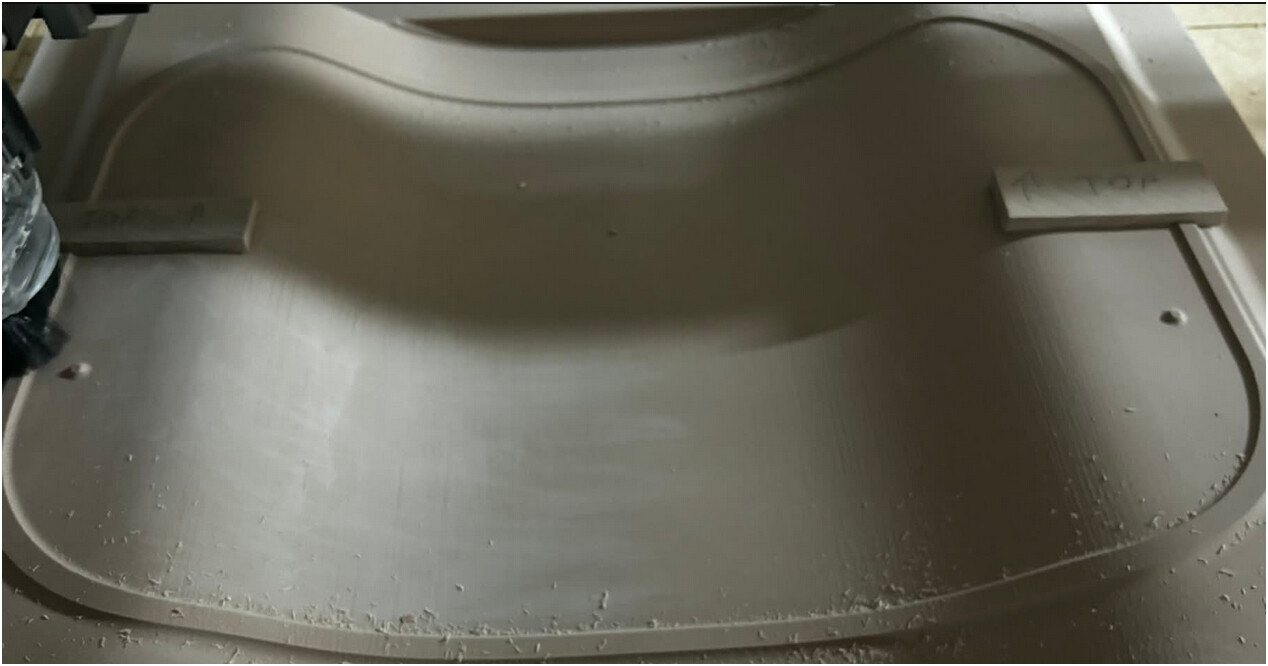

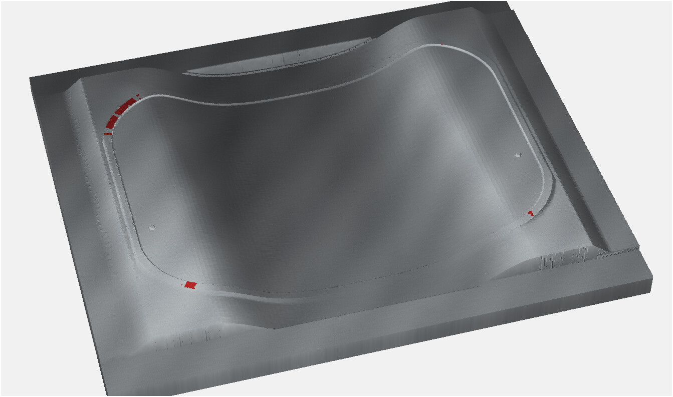

When the 3D finish toolpath ran, it showed up lack of material. I didnot notice it before. I let it roun through and now I have missing pieces:
I will let it run threough , glue missing material to voids, and woud like to run only the 10-15 cm of finish toolpath.
Can anyone suggest how to adjust the file ?
The file :
Thank you for your help in advance,
with best regards,
Miha

Ok … now i fond restart the program in motion … I will try to find an appropriate line …

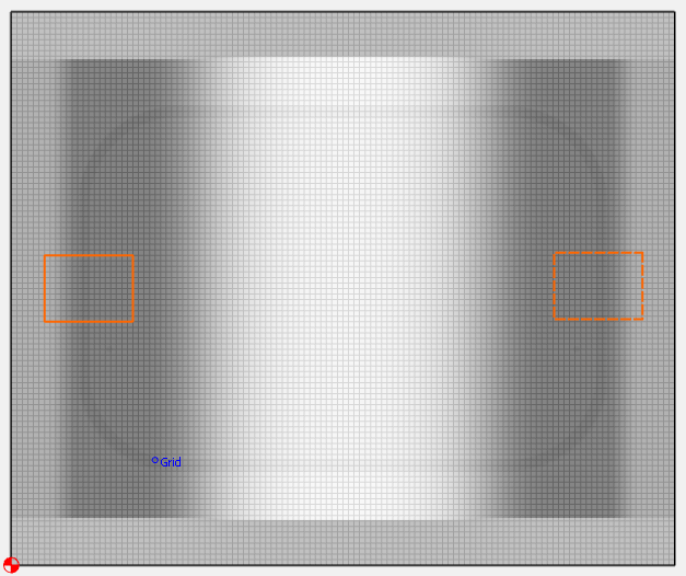

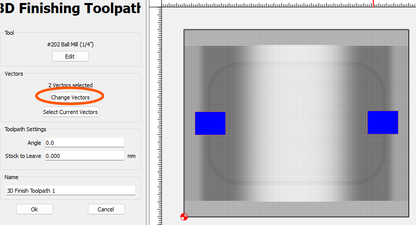

Create 2 boundaries
Edit the toolpath and Change Vectors to those boundaries

Thank you,
I see now that, that would also be an option - will be definately used in the future.
I just glues two pieces in voids, and run the program from code line approximately 2 cm before the gaps. Checked in NCViewer.
It worked flawlessly
Thank you all ,
