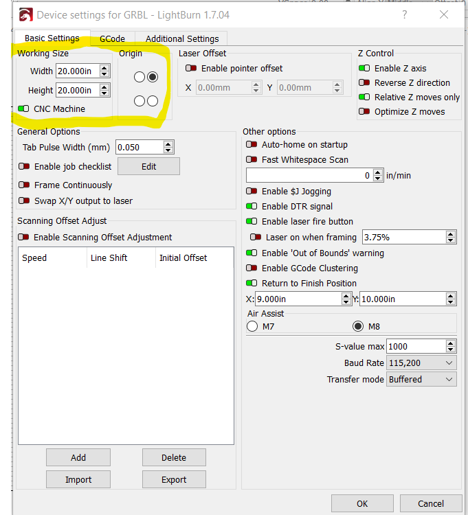

OPT PLH3D-XT8. Right now my issue seems to be with Lightburn communicating with my CNC. Lightburn had me change some settings and they aren’t correct. Carriage is slamming into to sides and end.

I had the same issue with the travel being messed up and what I discovered was that a couple of settings needed to be changed in the Device Settings window.
I have a Pro 5 2x2 so I made the workspace 20" x 20" so the laser mounted on the left side of the router bracket wouldn’t hit the left side of the machine.

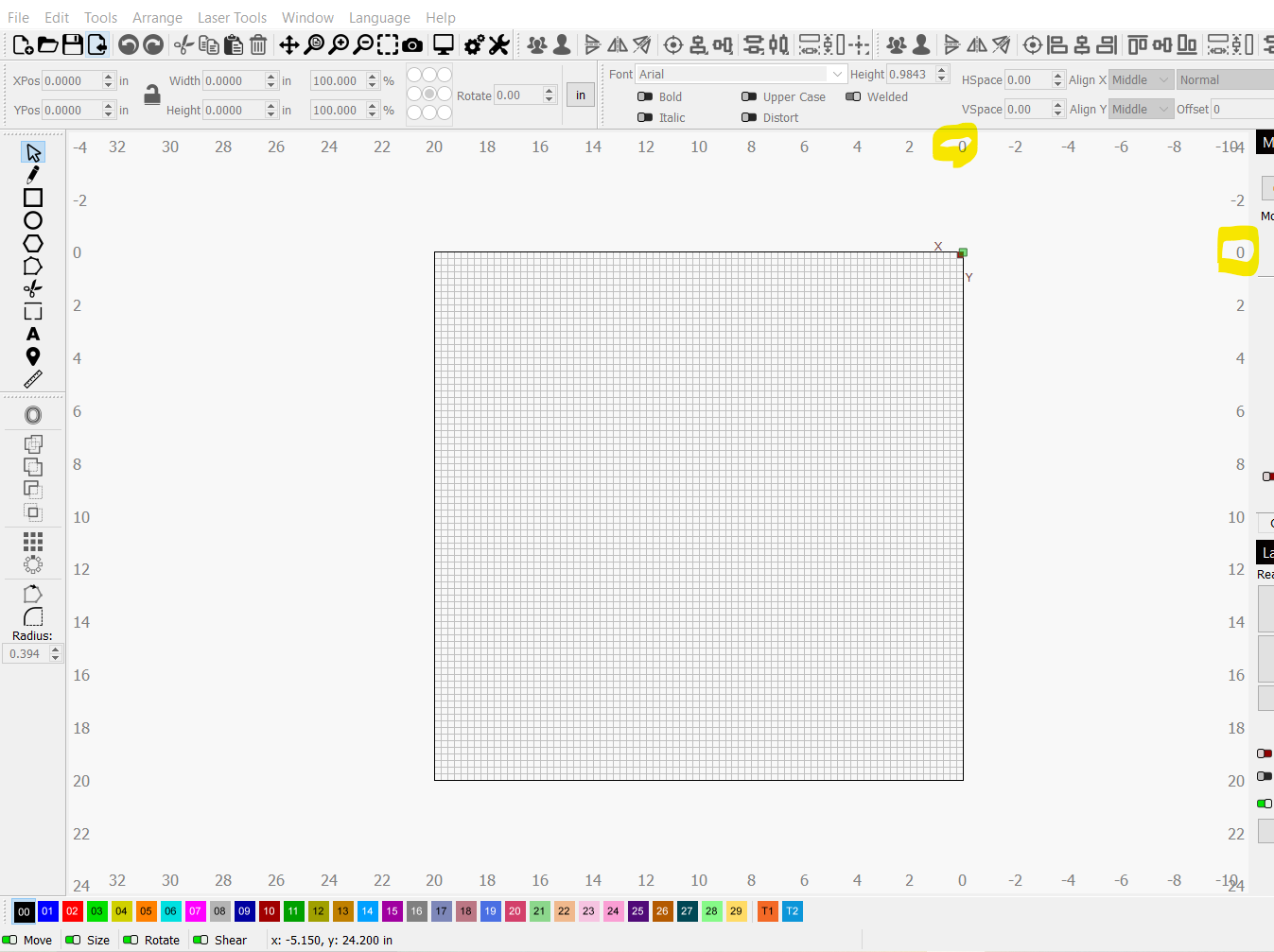

The other thing that threw me off for a bit was realizing that the X,Y zero location in Lightburn was in the upper right hand corner - not the bottom left like we are used to in CM.
I added a Saved Position setting in the Move menu so that after I Home the machine I can move it to the center of the workspace - which is where I center my design project (Job Origin) using Absolute Coordinates.
After making these changes I can go back and forth between Lightburn and CM with no issues at all.
