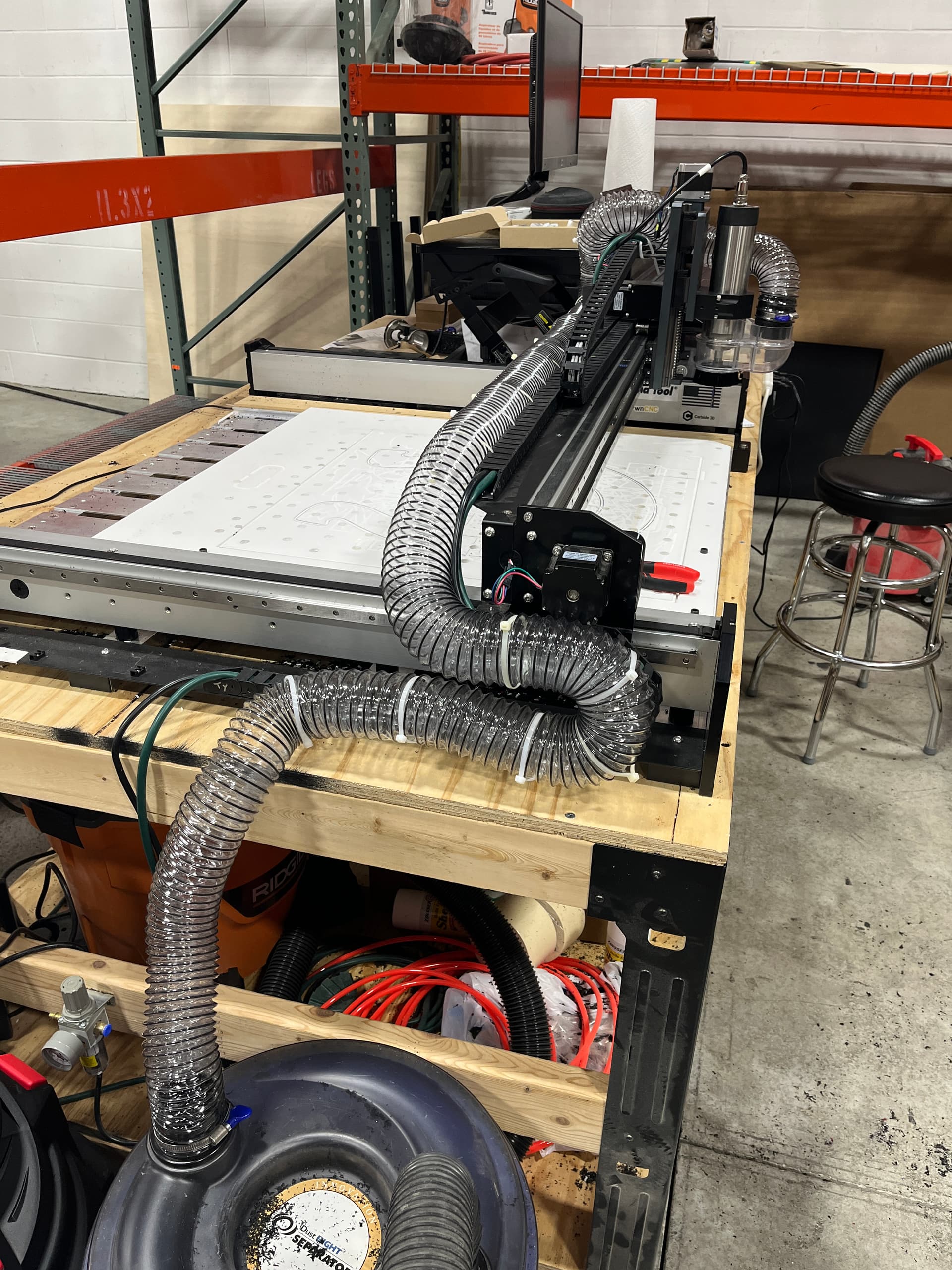

Running dust hose with drag chain
Had the bright idea recently to just route my dust collection hose alongside my drag chain. I’ve been using a C Stand and suspending the hose above, roughly centered, but I hated working around it. So we’ll see if this will work better.
Clever idea!
Keep an eye on those tight bends for buildup though.
Be aware that the dust hose will build a static charge, so make sure the dust hose does not come in contact with any wiring. Even if it is working now (summer, hot, humid) know that it could become an issue in the winter.
If it’s the type of hose that has a metal wire support, grounding it can help a LOT with static.
