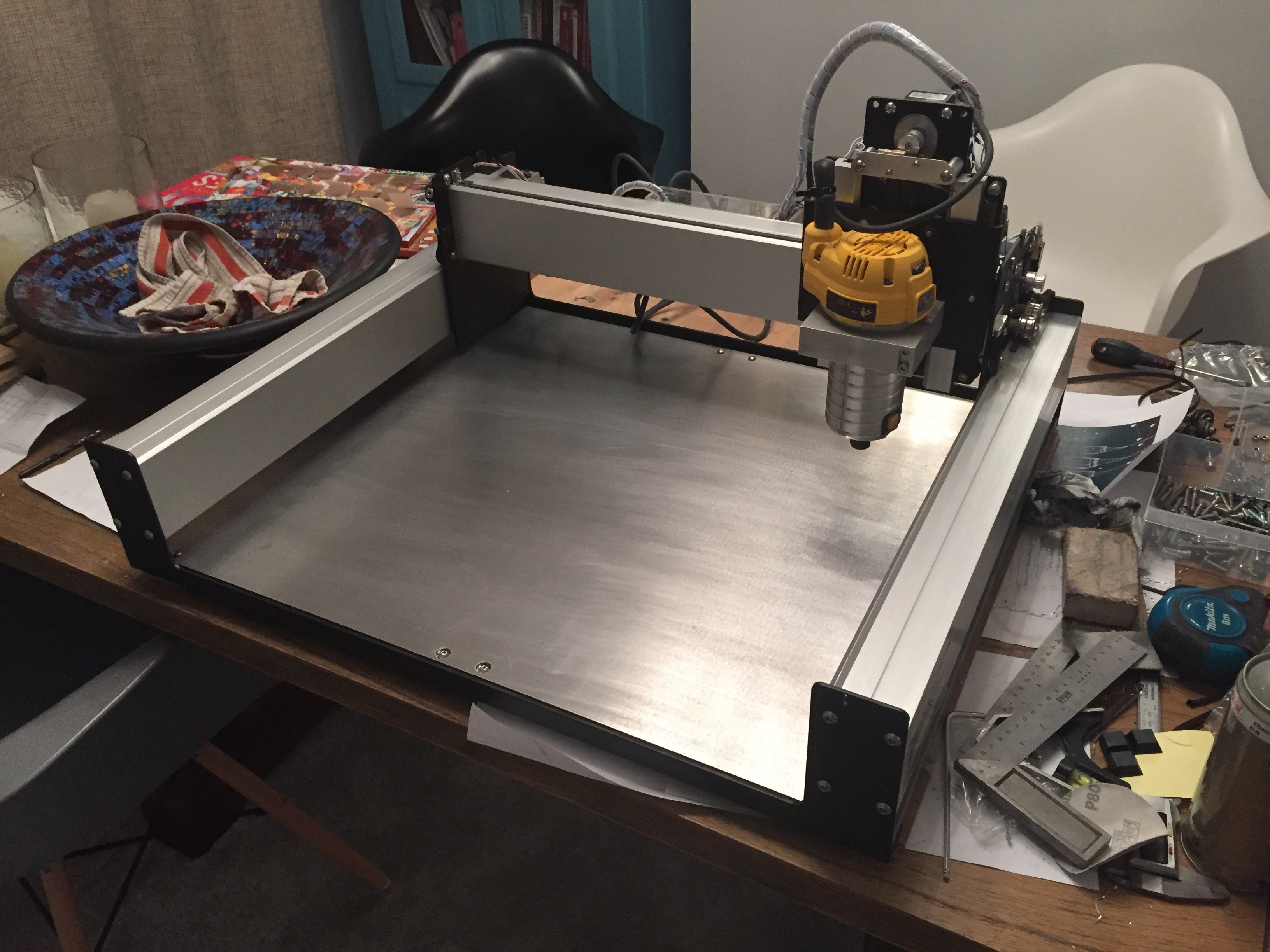

Following on from my post about buying a shapeoko metal bed and files I finally decided to take the plunge and make my own. I did want to have one CNC’d but it was too costly.

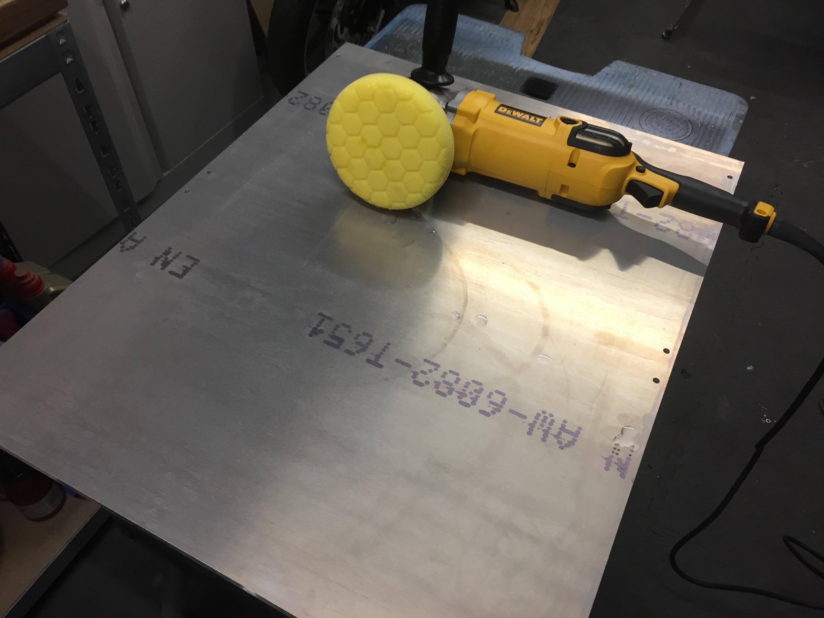

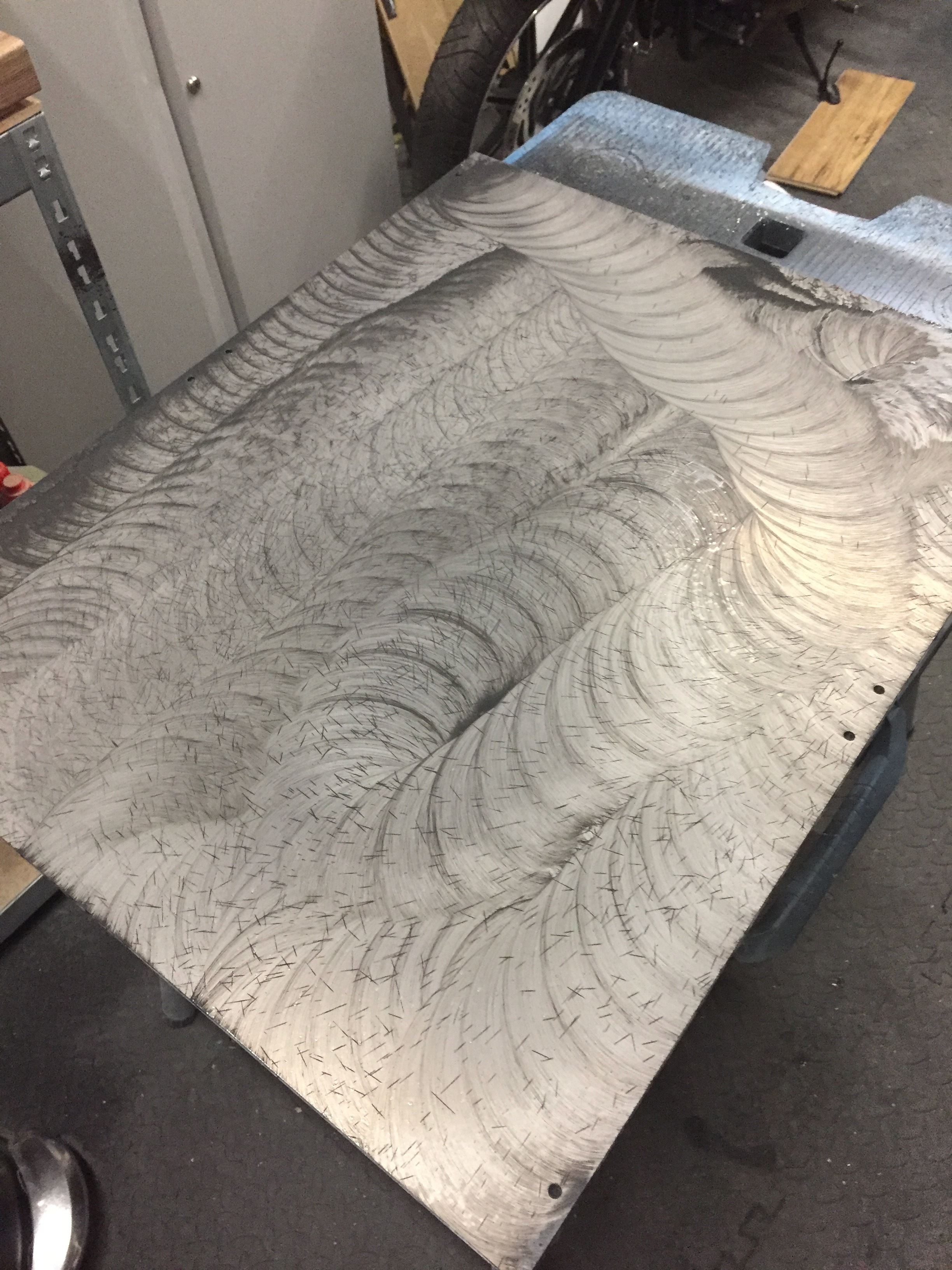

I started with a piece of 720x580 12/13mm aluminium that was cut by a local supplier. From there gave it a quick polish then drilled the mounting holes and put the shapeoko frame back together - only recessing the 2 front centre screws - then I drilled 88 pilot holes, then drilled to 5mm, then tapped with a M6 machine tap.
All in I spent about 2 hours drilling the 88 holes - the boring and tapping only took about 30 min which I thought was pretty quick. I went through 6 3.2mm drill bits, and charge cycles on my 18v 4ah dewalt.
Here are some pics of the build -
The best bit is using my DTI the base only have a 0.2mm variance across the board. It also only cost me £75 in materials and £ 10 in misc bits - like drill bits.
I will post results tomorrow from my first tests, but so far I’m impressed - if I was able I probably would have bought the one offered by carbide (it’s great value if your in the US)n - but this was a cool project and by far the largest bit of metal I have worked on.

Looks great! What kind of aluminum did you use? I’ve been thinking of using cast alumunim tool plate, Link Here
His looks like 6082-T651, but that’s just my guess based on the printing on the plate.
6082 is harder than 6061 and more wear resistant. Both are available in T651 temper which means it was heat treated and stress relieved by stretching.
mark is correct.
tool plate would likely be better, but it’s harder to get over here

Looks great man. I recommend facing that plate with your machine to ensure the plate is square to everything. If that makes sense.
I haven’t bought a plate for mine yet but I think I am going to extend the y of the table out beyond where the factory one stops. This will require me to cut the brace but I’m ok with that. This way it will actually cut its advertised work area.
Well, if one is willing / able to use fixturing wax or double-sided tape, one can get at the full work area.

Hmmmm that is a very interesting option. I did consider just using 20x80 extrusion but I don’t trust its rigidity or flatness.
I did that to my wooden one but found it actually make things worse. I have measured this one with a DTI gauge and it’s within 0.1mm/0.2mm all the way across - for my projects thats fine.
