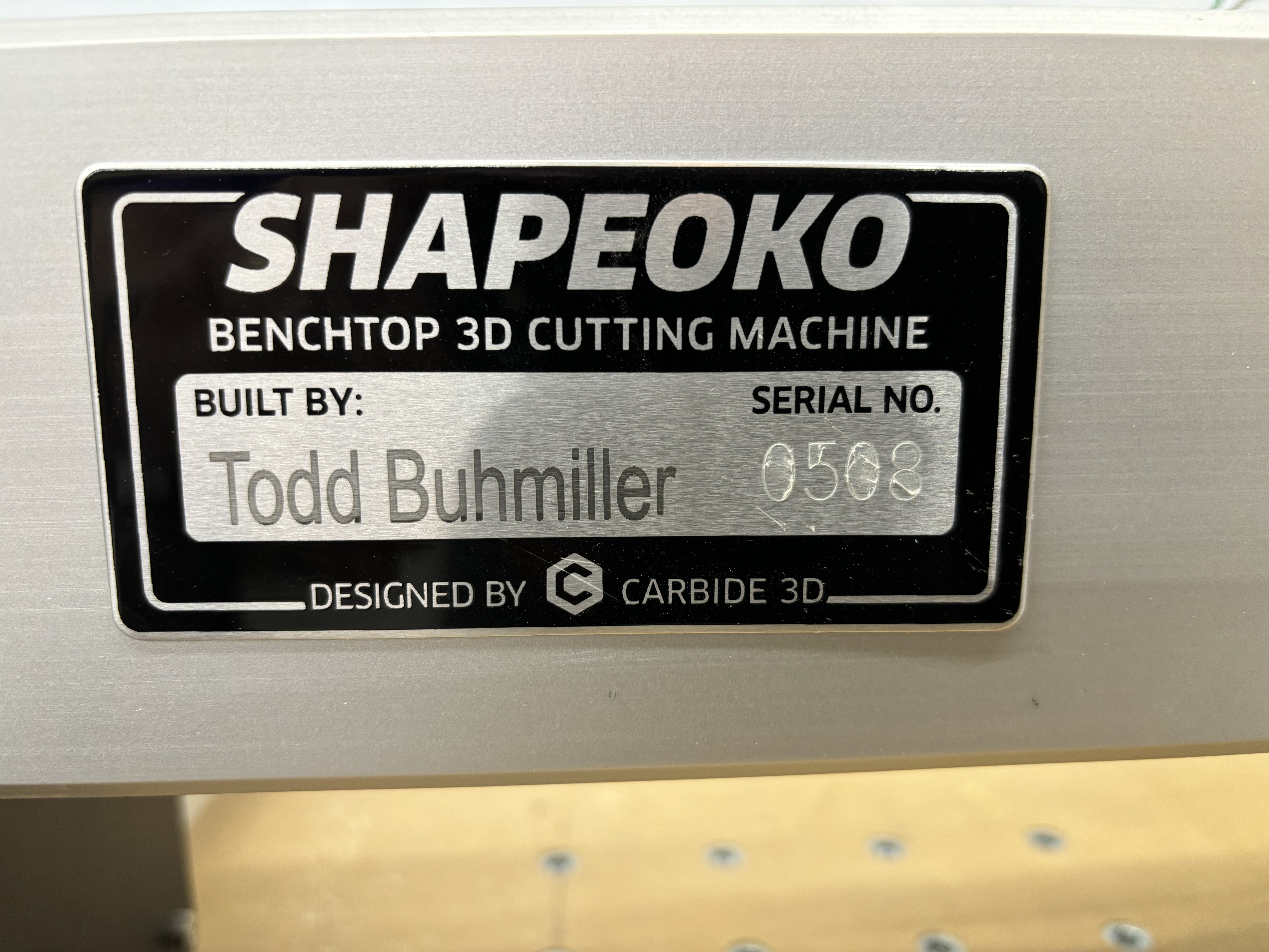

S3 Standard serial # 508

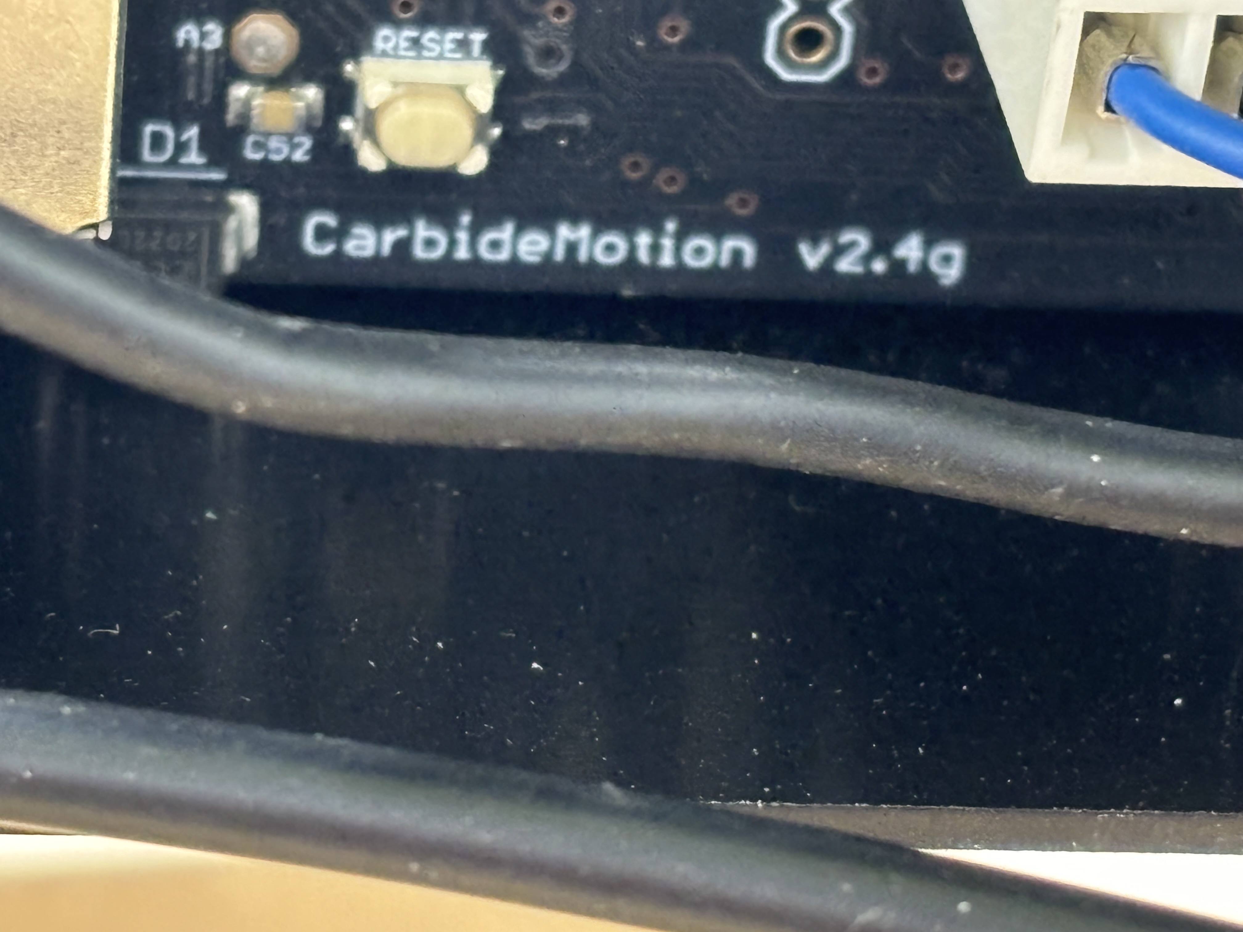

I have a S3 Standard serial number 508. I have a new motherboard (version 2.4g).

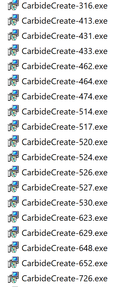

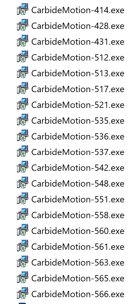

If you need an older version of CM I can put whatever version you want on google drive but I would recommend updating your SO3 while you can. The SO3 is not made anymore but C3D still supports it.

We will see. Thanks for the software .exe’s unfortunately I can’t use them as I am on a Mac.

I started with the latest versions of both Create and Motion. I found out with Motion when I go to initialize, it is looking for proximity switches. My machine is so old SN 508, that it was before proximity switches were added.

I purchased a new motherboard one that is ver 2.4g.

Thanks Will, I do have a new board, version 2.4g, or are you saying I need a newer board than the one I just bought?
No, the new board should be good to go — just since it has Grbl 1.1 on it, don’t use it with CM3 — until you have homing switches in place see:

Thanks, I will try all of this today (provided I can find the switches) and let you know how it goes. I know it has been a long time running, but I am excited to finally get time to make it work and play with it. By chance do you know what the last serial number for the Shapeoko 3 Standard was? I am curious now to see how many were made after I bought mine, a million years ago! Ha ha
I have a high four digit at home — but we stopped doing serial #s for the Shapeoko line for some reason (Nomads still have serial #s) — as for how many have been made, no idea, save that it’s
