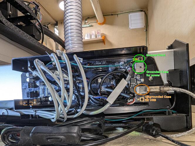

I also noticed that the case around the USB connector on the control board is not grounded. Seems like it should be. Any EEs here that know why it wouldn’t be?
Hi Jeffish. I already tried a second double-shielded USB cable, routed the USB cable away from the power cables, tried the second USB port on the notebook, and tried a different notebook. No success. Is there something else I should try?
EE here, but not the one who did the board. There’s a USB isolator right after that connector to break any ground loops between the computer and the machine. We do not ground the connector because that would potentially create another, negating the point of the isolator.
