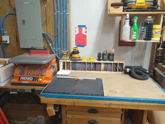

Here is the finished storage rack with most everything in place. I know it is a lot of sand paper but I go through a good amount of sand paper in a year. I live in the country and when I need something I cannot just run up to the store and get it.
The table the storage rack is sitting on is my sanding station. There are 3 drawers. The top drawer has chisels and cutting instruments. The second drawer has all my other sanding sheets and accessories. The third drawer has my hand planes.
The bench has a torsion box on top of it and is quite handy for having a flat surface. I used poplar trim around the outside with a masonite top. I have a heavy piece of paper on top to protect it from spills which I get regularly. The masonite top is replaceable if needed. It started out life as an assembly table but proved too small for many projects. Things in your shop should evolve over time.
Not shown in the picture is a 4 foot long power strip to plug things into. This is handy for the sanders and for charging up lights and other things around the shop.
