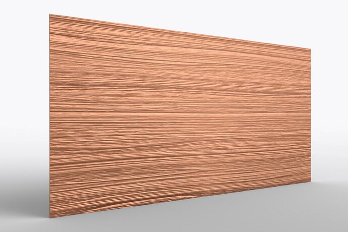

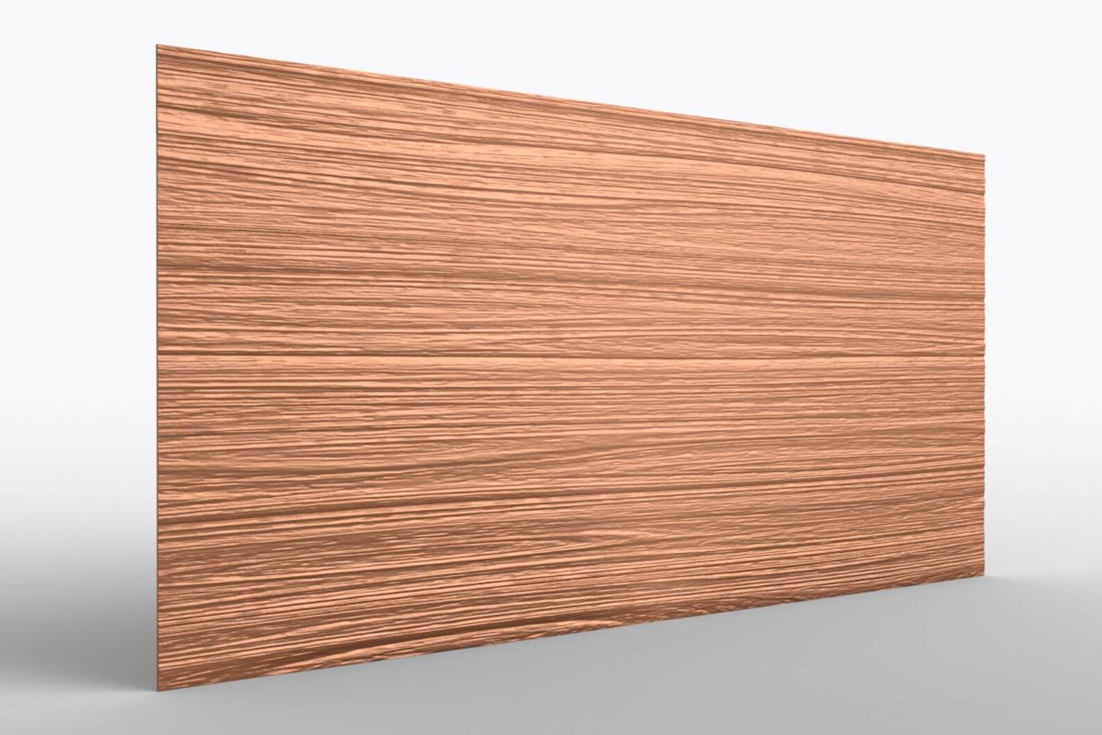

What about this? 48 x 96 inch
https://www.etsy.com/listing/1803538943/

Nice! That gets me real close. Thanks for this. Another option I’ll definitely be looking in to!

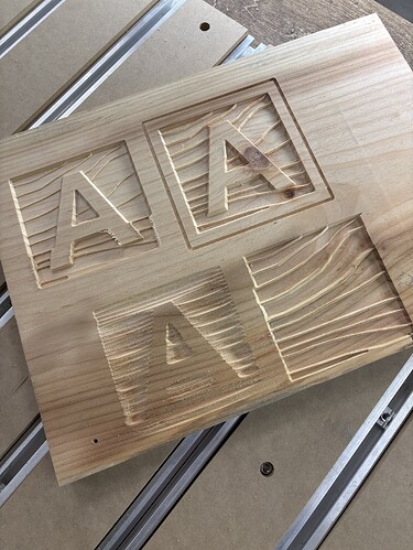

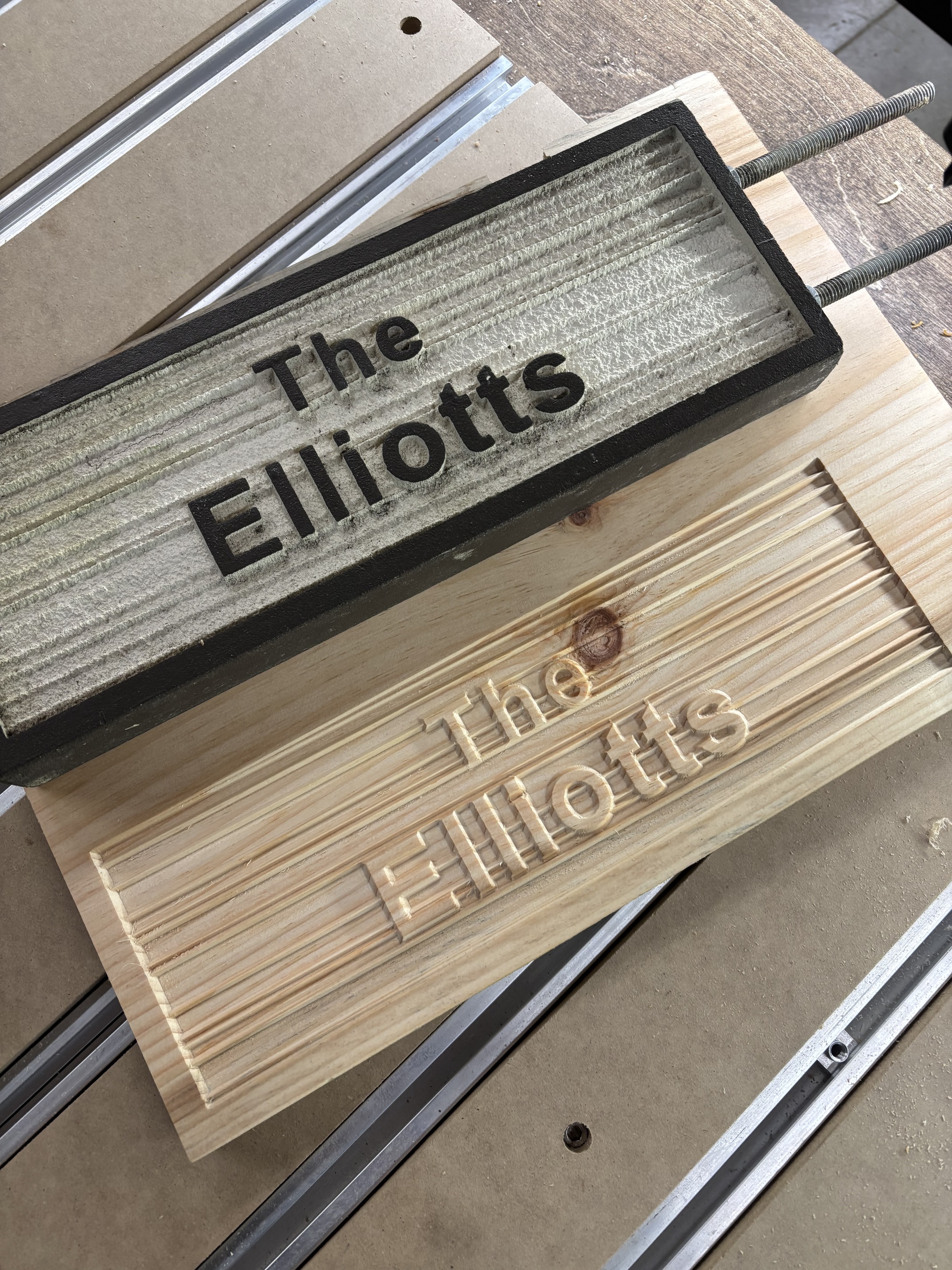

After much research, frustration, hours of video watching, trial and error, a training session with Tyler, I have my first viable product for sand blasted woodgrain look! I am very satisfied with the end product…well at least this first mock up. My first end goal was to emulate one of the name signs that I will be producing for a country club. And this was the very reason I decided to purchase a CNC in the first place. (Note, I currently have 11 signs lined up to do before having produced 1 finished product :flushed:)
It isn’t the end product for sure (I will eventually have it looking LIKE wood)!
Here’s to having hours of fun on the Pro 5!
My trials:
My success:
Many thanks to ALL those who have helped me get to this point!!
