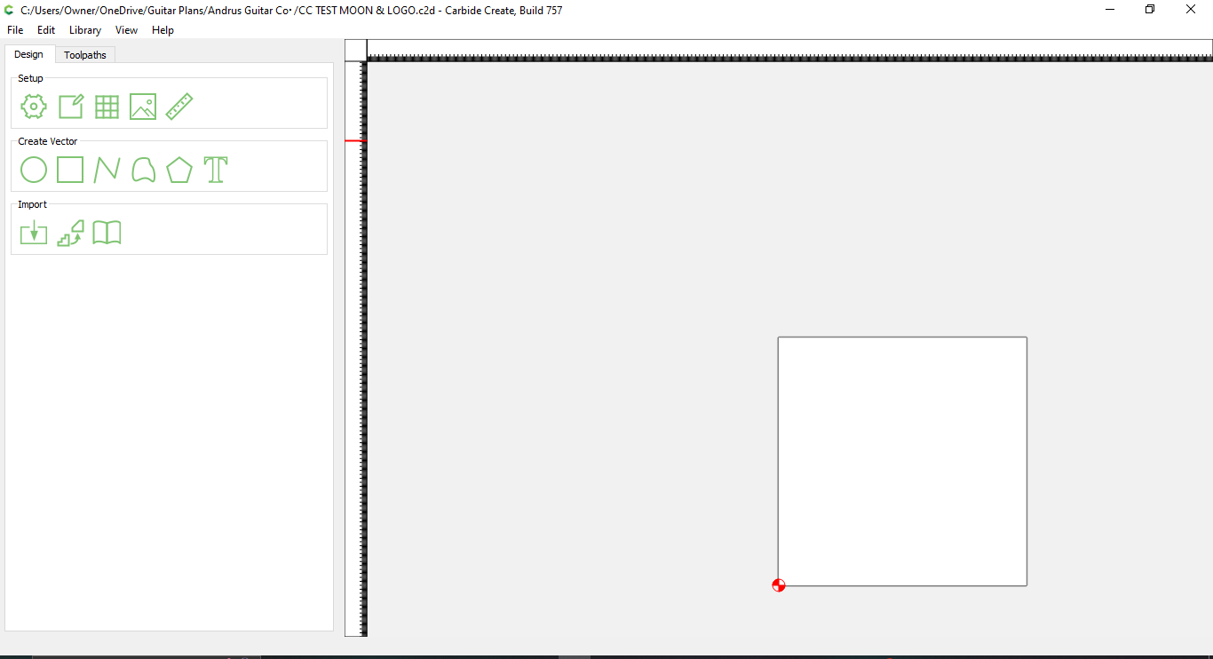

the problem is that when i try to open the file in Motion it tells me that only files created in v7 can be opened. v7 is the only version I have installed. and I’ve uninstalled and reinstalled it.
also when i try to open a file I’ve created with Create in Create it opens blank with a new size and a 64th inch grid.

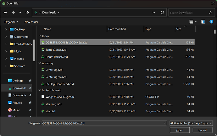

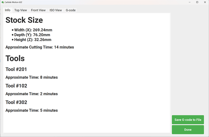

I downloaded your file and verified that it opens okay in Carbide Create:

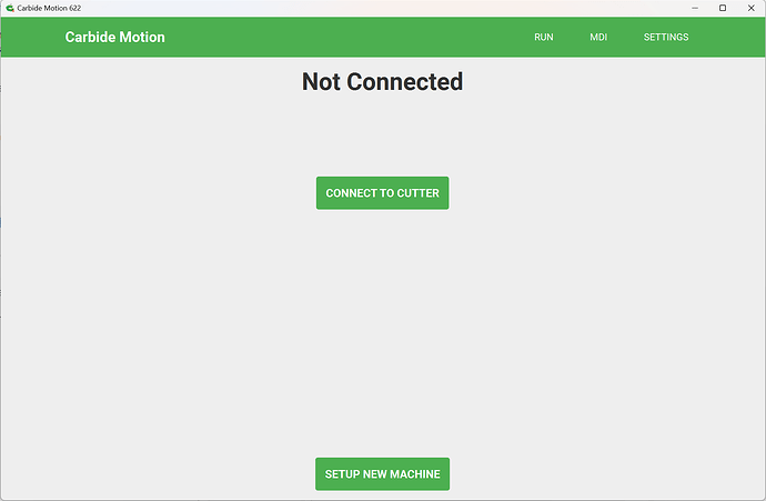

launched Carbide Motion:

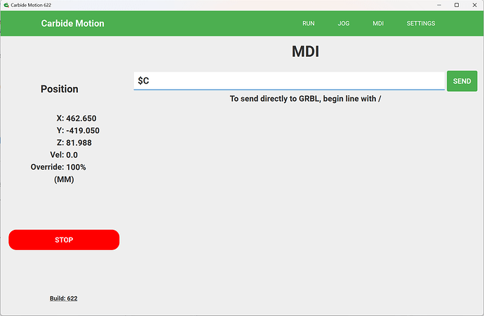

connected, initialized, then put it into Check mode:

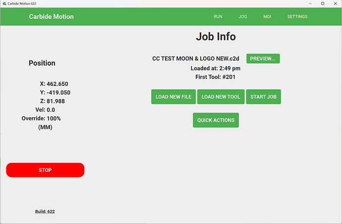

loaded your .c2d file:
which loaded as expected:
and ran

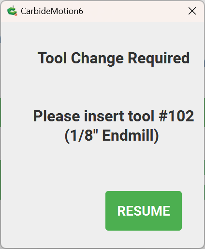

requesting tool changes as needed:
to completion:

I’m running it from my connected laptop. this is what I get when I open that file.
I can’t figure out what’s happening. I downloaded the software. made that file. saved it and reopened it. I didn’t fiddle with any settings or anything.
I’ve got CC build 757
CM build 618
on a windows 10 laptop.
file stored on onedrive.
It’s the onedrive isn’t it?

I’ve got it working. I had to copy the file from OneDrive to my desktop and it all opened and works. I had thought that OneDrive worked like a local drive and downloaded the file locally but evidently it doesn’t. Once the file was opened from my desktop it worked just like it did for you.
