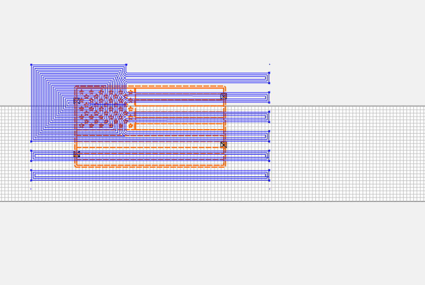

when I change the size of a project the toolpaths do not follow. Do I have to define them always from scratch with a new size of the project, or is there any way to keep the toolpaths connected to the project as designed?
You mean, when you change the project size in the job setup?

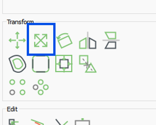

Yep, I use some different stock sizes for some flags, and just need to adjust the project size to the next stock size. Therefore I use the transform tool to scale the project
but the toolpaths do not follow:
I’m convinced I forget something.
Wait for the file to recalculate toolpaths, or save, close, and re-open.
Maybe we forgot something. After scaling, hit the cursor right, then left to move the vectors and trigger a recalculation.
Thanks again! I know what I forgot: I disabled some toolpaths, because they have to be cut all separately for each color. And then scaled. If -even after scaling- the toolpaths are reactivated, all was adjusted nicely.
