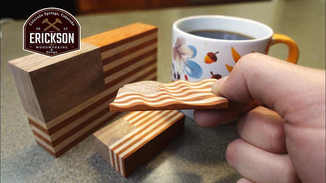

I guess I was bored in the shop and had a ton of 8/4 left overs from a recent project so why not make a ton of smaller American wavy flags :man_shrugging:!
These two are 1/4” and 1/8” width stripes. Using 8/4 material….roughly 2” thick, I was able to make blocks and then cut 1/4” and 1/2” thick finished pieces. I can yield quite a bit from each block. Then off to the Shapeoko to cut the profile, then finish the stars with my laser.
What am I going to do with all these??? I have no idea lol!
Super fun to make. I’ll cut the wavy profile into the smallest flag tomorrow. Excited to see how it turns out.
Cheers!

Are you painting the stars white?

Now I’m thinking why not do a 1/16th width stripes.
I’m loving the profile :nerd_face:
Off to the laser to burn in the stars.
@cnackers right now I’m painting the stars. Thinking about inlaying them, it hurts my head thinking about how they will be distorted.

Figuring out the 3d inlay hurts my head as well, i’ve tried a few things ,but haven’t come up with a good solution yet.
Here was a final gift I used the smaller flag in. Turned out really good and they were really happy.
Also, posted a new video on the process for this.
