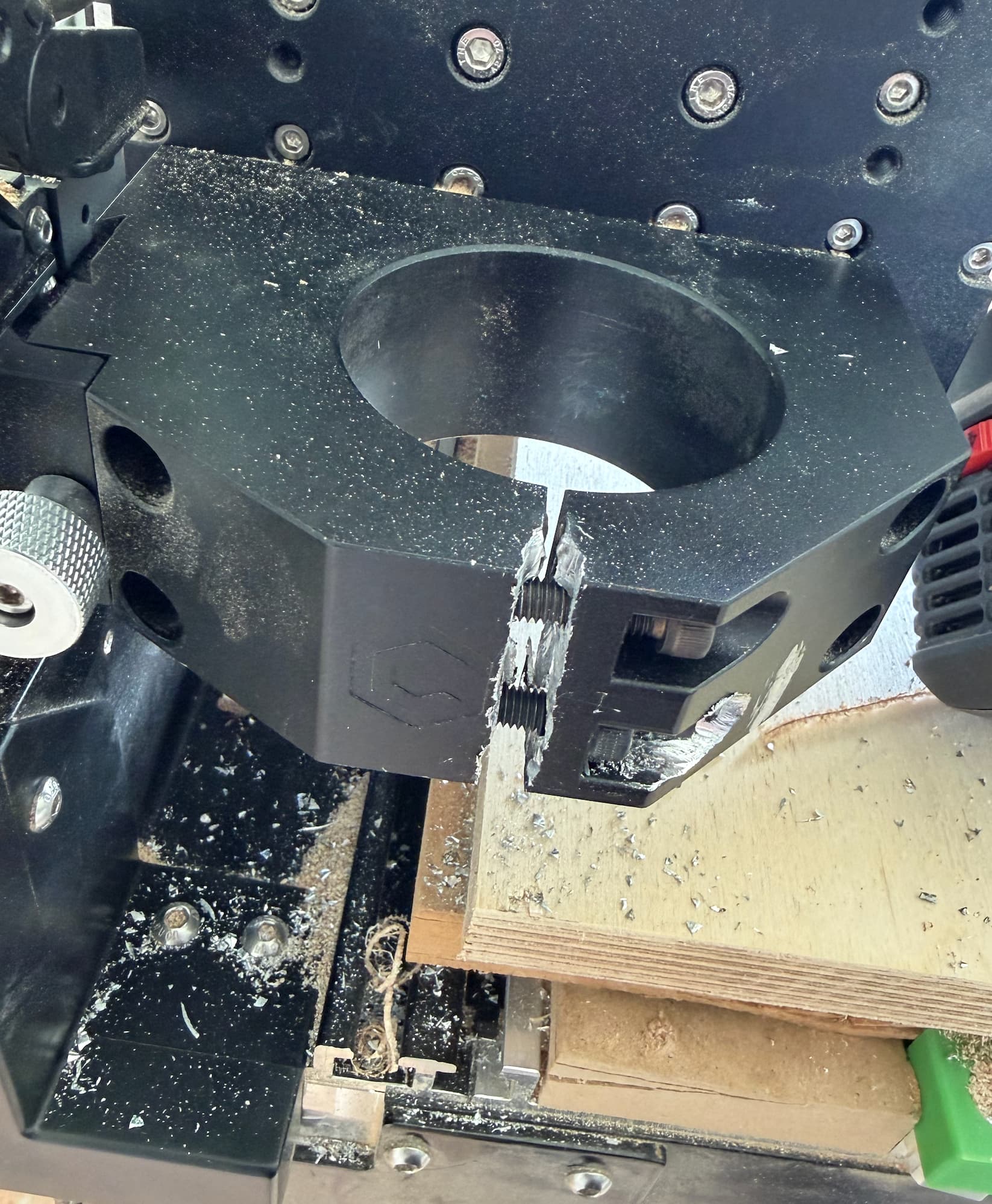

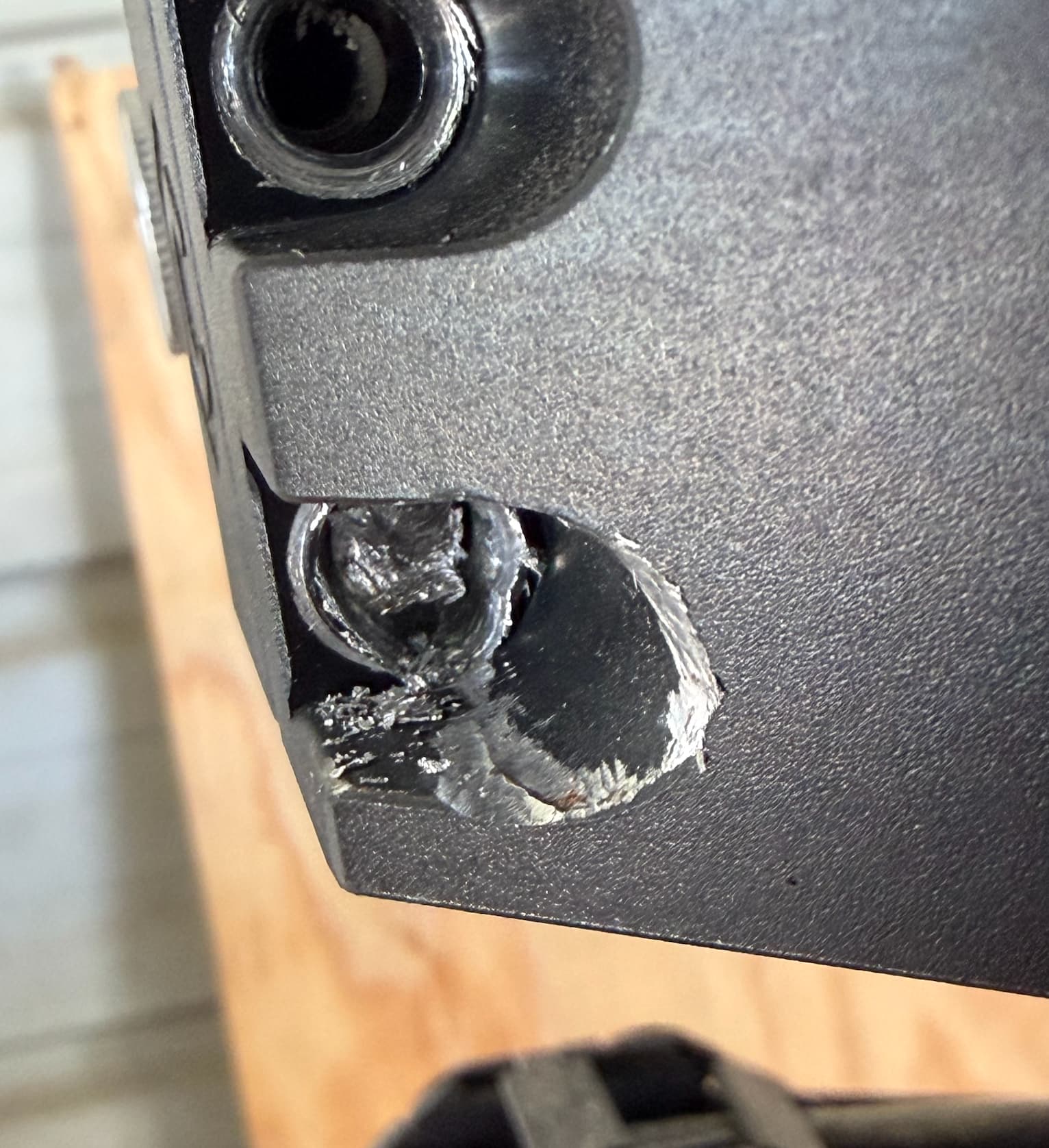

Pro tip from a two week old Shapeoko: apparently, one of the skills you get to learn early is screw extraction. This is a Shapeoko 5.1 Pro 4x4, roughly two weeks old, and unfortunately it has been a frustrating start. First, the Carbide Compact Router that came with the machine died when the spindle simply stopped running. I already have a warranty claim open, which I appreciate, but that does not exactly help me finish the project sitting on the table. While troubleshooting, I installed new brushes to see if that would solve the problem. It did not. While tightening the router back into the clamp for a test, one of the two clamp screws sheared off flush with surprisingly little effort. I broke out a screw extractor kit, only to discover that the recessed area around the screw leaves very little room to get an extractor and tap wrench into position. I moved to a left hand drill bit in reverse, but that did not move it either. I have contacted several local machine shops, but nobody seems to have time to deal with it right now. I understand that equipment breaks and problems happen, but between a failed router and a sheared clamp screw within the first two weeks, this has been a pretty disappointing introduction to a brand new machine. I bought it specifically for a 180 board project, and so far I have managed to cut five boards. Hopefully this is just a rough start and not an indication of what ownership is going to look like long term, because right now I have spent considerably more time troubleshooting this machine than actually using it.

I have run into a similarly recessed sheared screw. I made a 3D printed bushing that worked well enough to get a center hole drilled. 12 pt sockets will drive taps, and extractors.

I had to do some serious surgery just to get a pair of needle nose pliers in there and turn the bad screw out, and even then, it took a ton of heat, patience, and persistence. Still dont know if it will hold anything…
