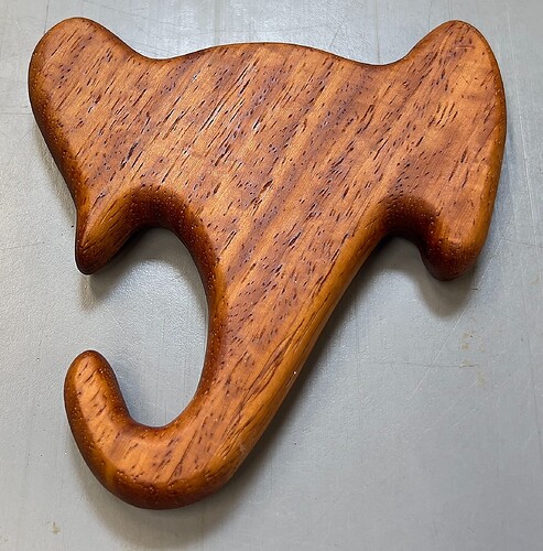

The first rattle turned out great:
And notice the resaw enabled pretty decent grain matching on the edges:
The alignment holes make all the difference - glue up was painless and perfectly aligned, so only a light sanding was needed to remove excess glue squeeze out, then round over all the edges on the router table, then finish sand everything. Using a pure tung oil (food safe) finish.

PPS: Carbide Create was great to use for this project. Simpler than Fusion 360 and the ability to easily modify the depth of the toolpaths meant I could dial in exactly how deep to cut the contour out. I was actually able to just touch the first layer of blue tape leaving an unmarred MDF piece underneath.
