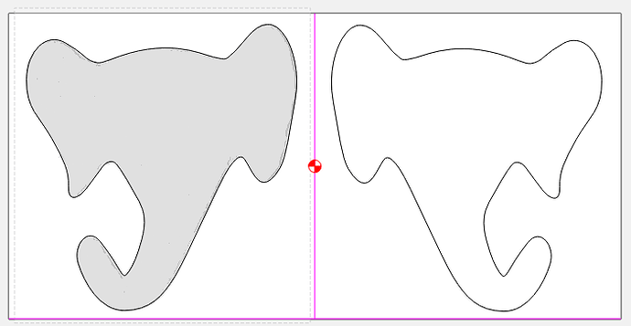

Ben, because he cut it like a box with an interlocking lid, the “registration” is built into the design.
The only trick, then is to line up the two halves.
If you make one edge, and one adjacent edge straight before slicing, then you could set both halves up using a Center zero. (Pink lines being your ‘bookmatched’ edges.)
Yeah, that’s what I was talking about with the “align the two halves so that it appears as a single board.” But, I think I just need the one straight edge - the one I’m flipping across. And then pick either the top or the bottom of that edge for my registration - right?
Setting the origin at the center as shown should work for the flip, and since you want a seamless wood grain along the edge you would instead add holes for dowels, or, glue a matching piece of wood to one side (to function as dowels) and machine it away, leaving only the buttons.

I cheated on the clean-up — exported as an SVG, used Inkscape’s Path | Simplify command a few times, re-imported, then tidied up a tiny bit — correct that re-drawing would have been faster than doing this by hand.
Here’s a file which has the circles for the dowels in place, but which would need adjustment in terms of toolpaths/thicknesses:
