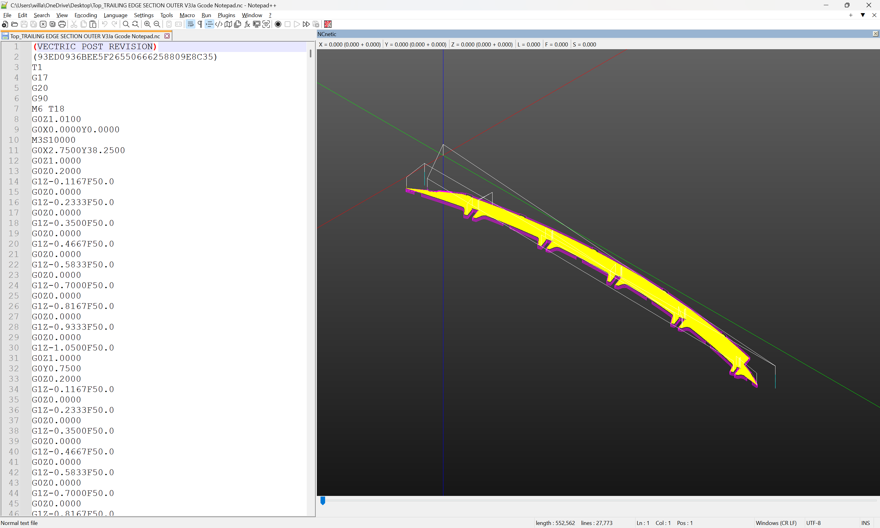

Wow, I just learned that Notepad++ has a gcode preview plugin!
Is there anything similar for VSCode?

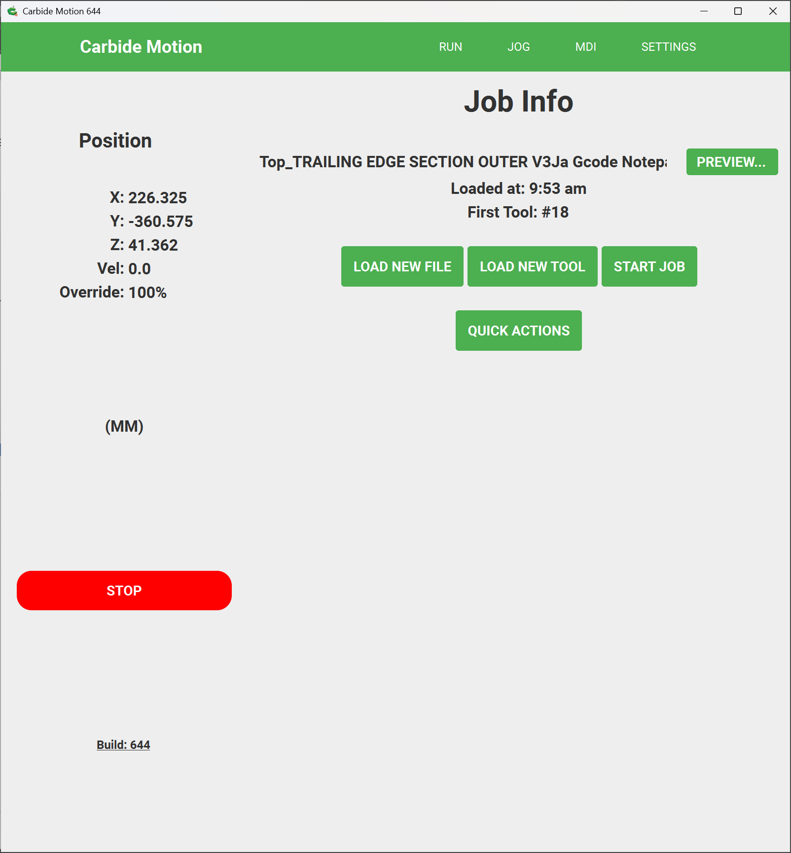

I just tried to run CM and a file off a usb to eliminate the wi-fi or sending the files to another computer in the shop. It still CM crashed when opening the file.
I also noticed some posts with the same issue.
I attached the notepad gcode for the part I am having the crash on. As I said it worked before.
I have sent in every BugSplat report for every crash, have they been looked at???
Office computer Attached:
Top_TRAILING EDGE SECTION OUTER V3Ja Office Computer.zip (96.2 KB)
and Shop computer:
Top_TRAILING EDGE SECTION OUTER V3Ja Gcode Notepad Shop Computer.zip (96.2 KB)

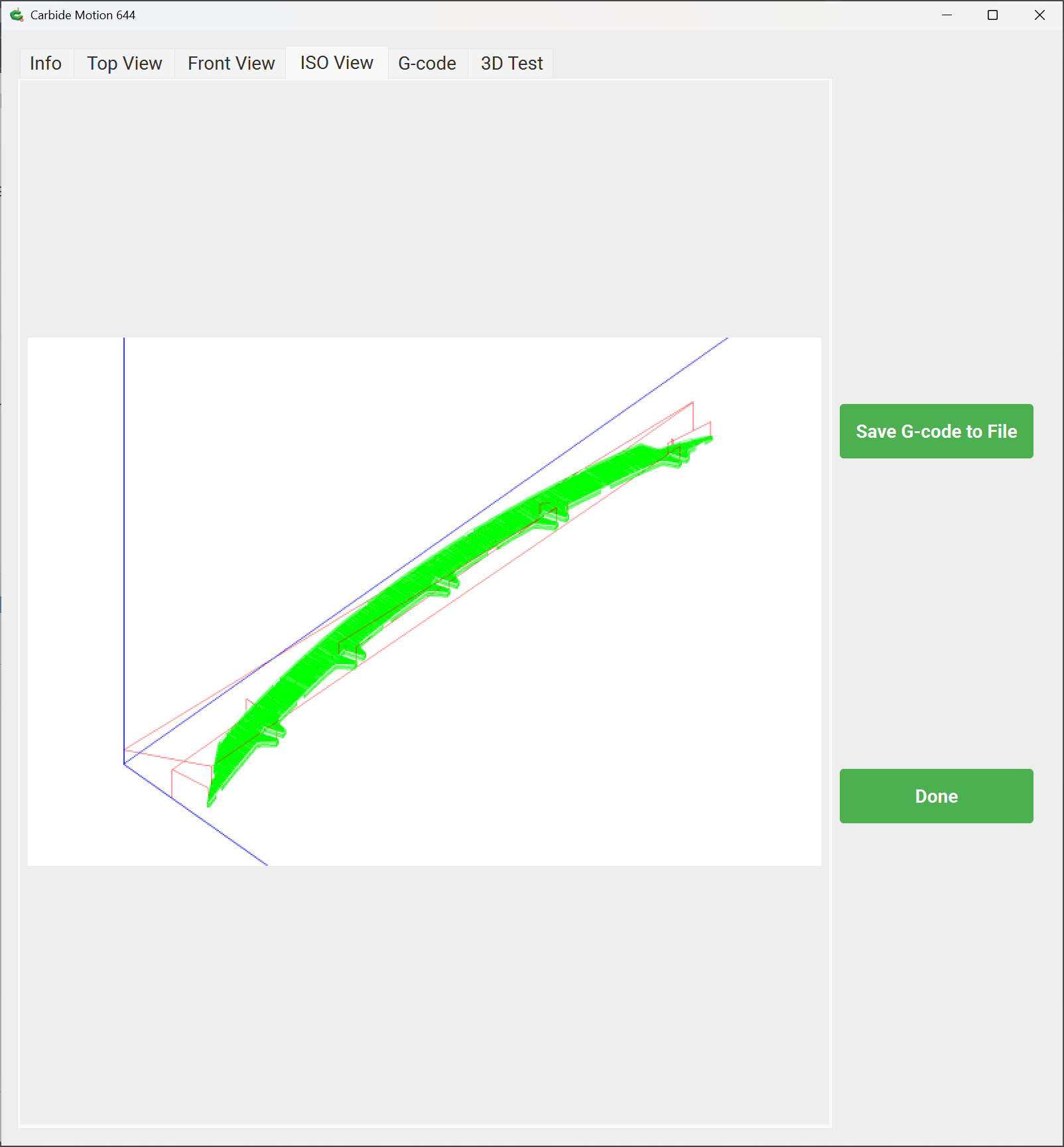

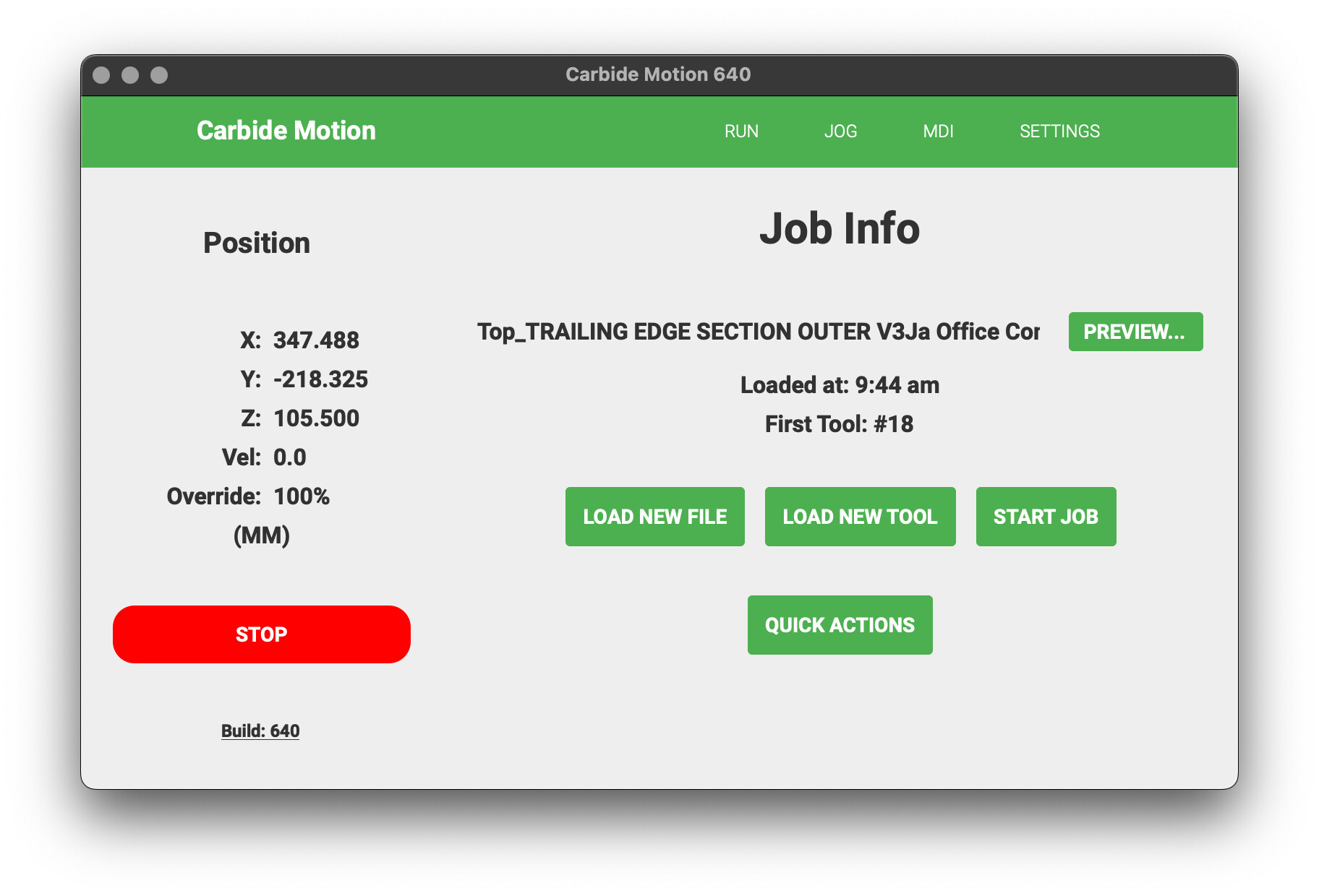

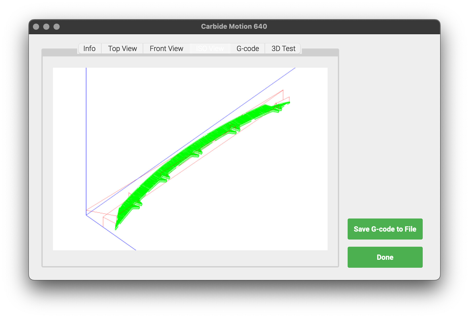

I downloaded the .zip files, unzipped them, and changed the file extensions from .txt to .nc leaving them in the “Downloads” folder (to which the account I am using has read and write access).
I then powered up my machine and connected to it and initialized, then I loaded each file:
so the files seem to be fine, and the problem would seem to be with your computer or account or where the files are stored.l
Vectric affords a “VTransfer” utility — perhaps try that?
I am going to re-try the above with my Windows machine, but I’m sure the results will be the same.
Another thing to try — create a new user account and install only Carbide Motion to that account, and try copying the files to the Desktop and running them from there.
Again, with the files downloaded and the file extension changed, they preview as expected:
and load:
and if I put Carbide Motion into Check mode by sending $C using MDI, run as expected (except the tool change happened too quickly for me to capture that).
