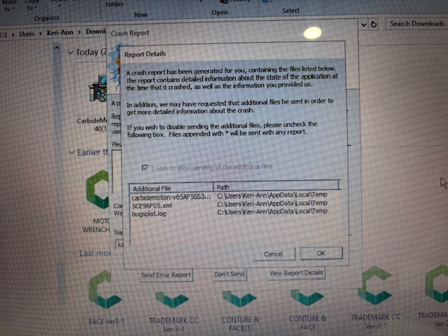

I did look at it. Was not that helpful to be honest. I just tried to run an older Carbide Create file that worked 2 weeks ago … it crashed CM as soon as it started to load. Bugsplat file send, many of them.
Frustrated,
KAP

I’m going to delete that image from your post since it has your e-mail address in it.

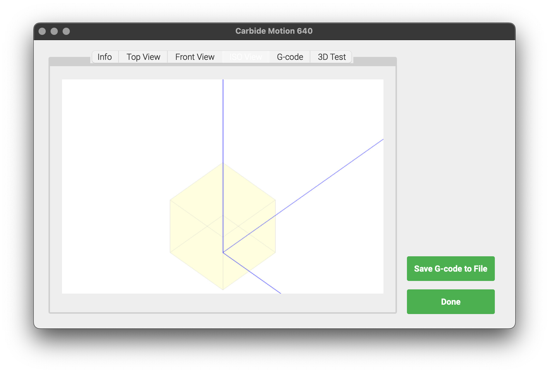

Here is a basic file:
which has origin set at bottom for 25mm stock
which has a toolpath which just barely makes a dent:
test_drill_0_01_bottom_25mm.c2d (44 KB)
and the G-code:
test_drill_0_01_bottom_25mm.nc (510 Bytes)
previews as expected:

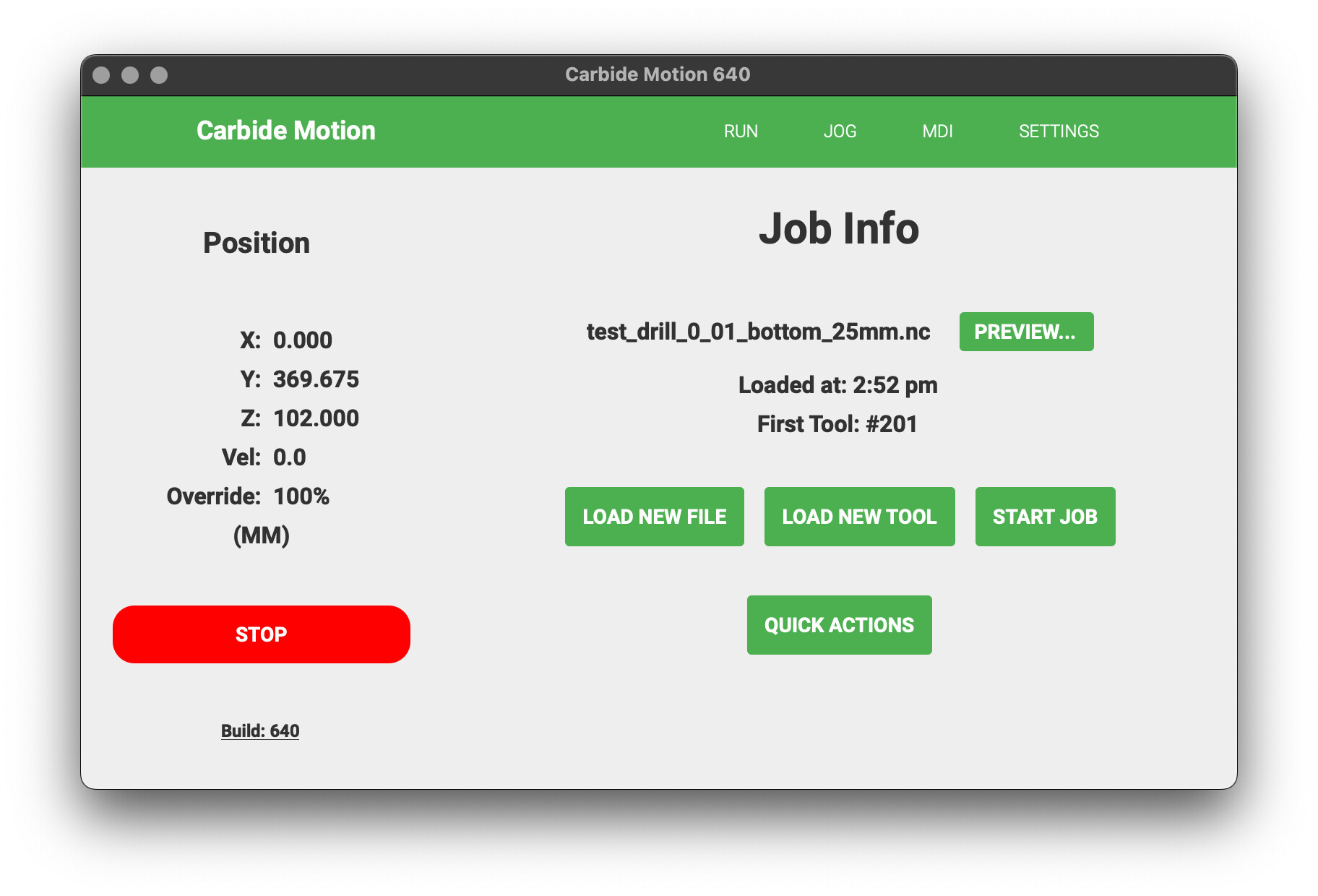

When tested in CM640, both files:
load as expected, and when tested, ran to completion.

The screengrab shows the preview from Carbide Motion generated after opening the file.

Yes. Your file loaded with processor I specified on CM 640. No crash.
