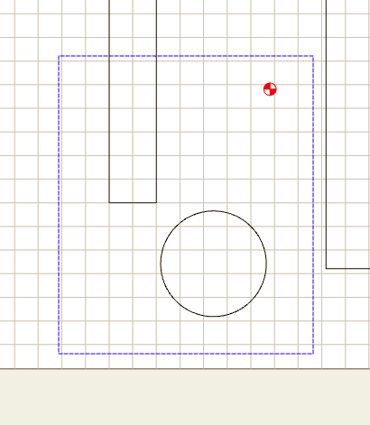

Click-and-drag should do it, but the region you create from that has to cover a vector for it to be selected.
Here I did a Click-and-drag. The Blue is the selection region. Once I release the click, only the circle will be selected.
EDIT - actually, part of the figure can be outside the region, but is has to be very close.
EDIT 2 - Now that I re-read your post, it looks like you already knew this. I think this and the multi-click method are the only ways of doing multiple selection.
I think the convention is click and drag right only selects the entire object included in the selection box. If you click and drag left anything within the box and whatever the box touches is highlighted for selection. I think…. Been a few days since working on a file.
There is a difference for sure.
Oh. My. God.
If you click and drag downwards (either left or right), then you select objects that are completely covered (or just a tiny bit outside the selection region).
If you click and drag upwards (either left or right), you select anything you touch.
