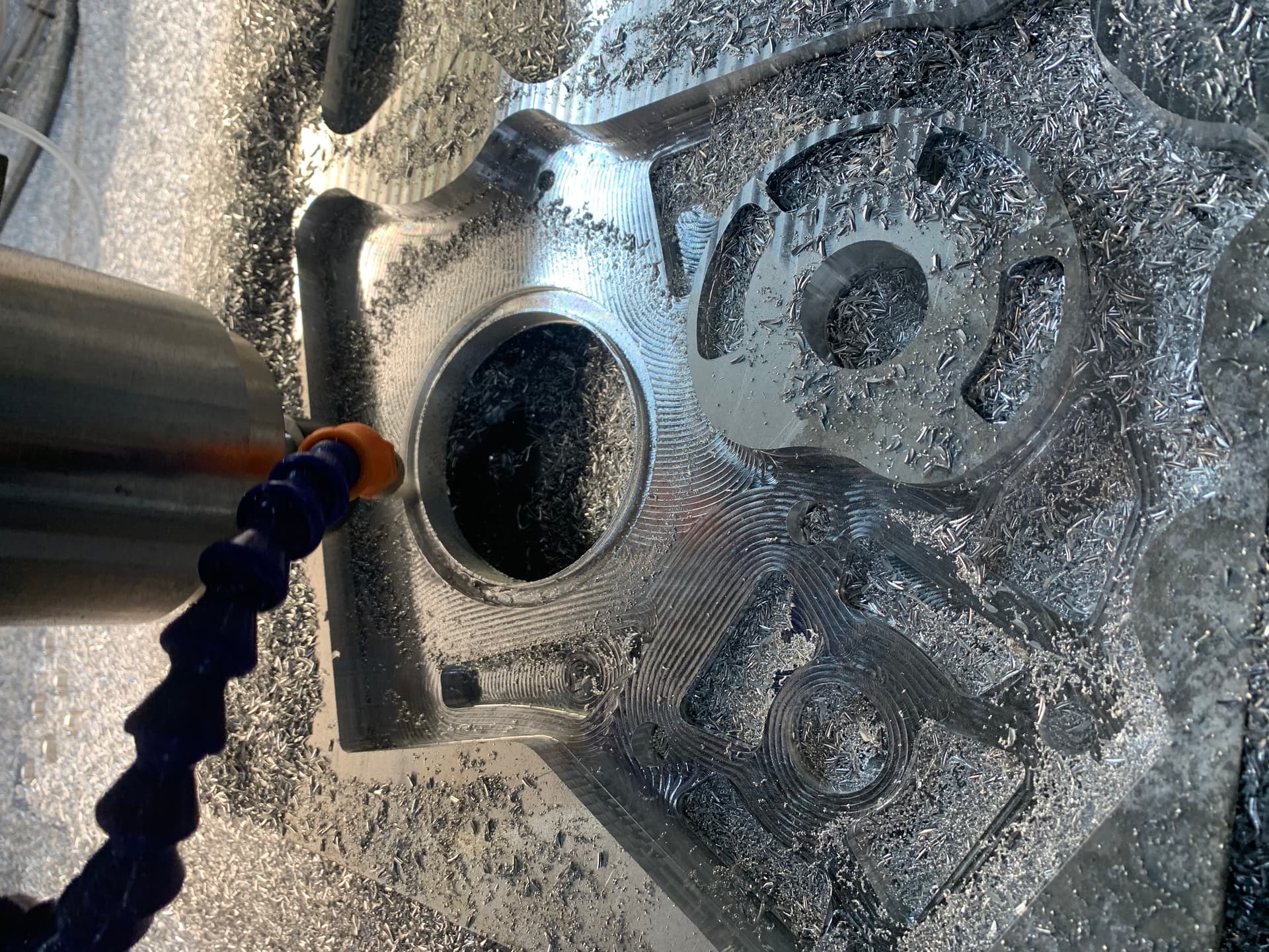

Already working on some of the parts in this design
Thank the lord for mid process dimension checks
I originally mirrored the bottom plate to the top and then started making changes. Missed this one but thankfully it was on my notes under critical dimensions.
Op 1 of the big stuff

HDM plunging at over 100 ipm. Helical tools held up so well.

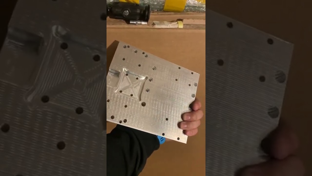

some video of my mounting plate for the spinde to the z rail. kinda fat might need to go on a diet.

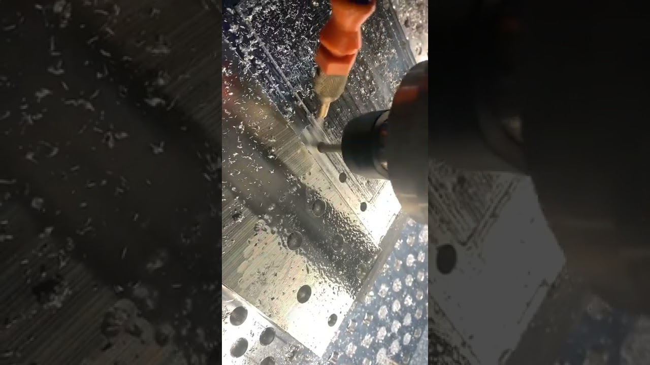

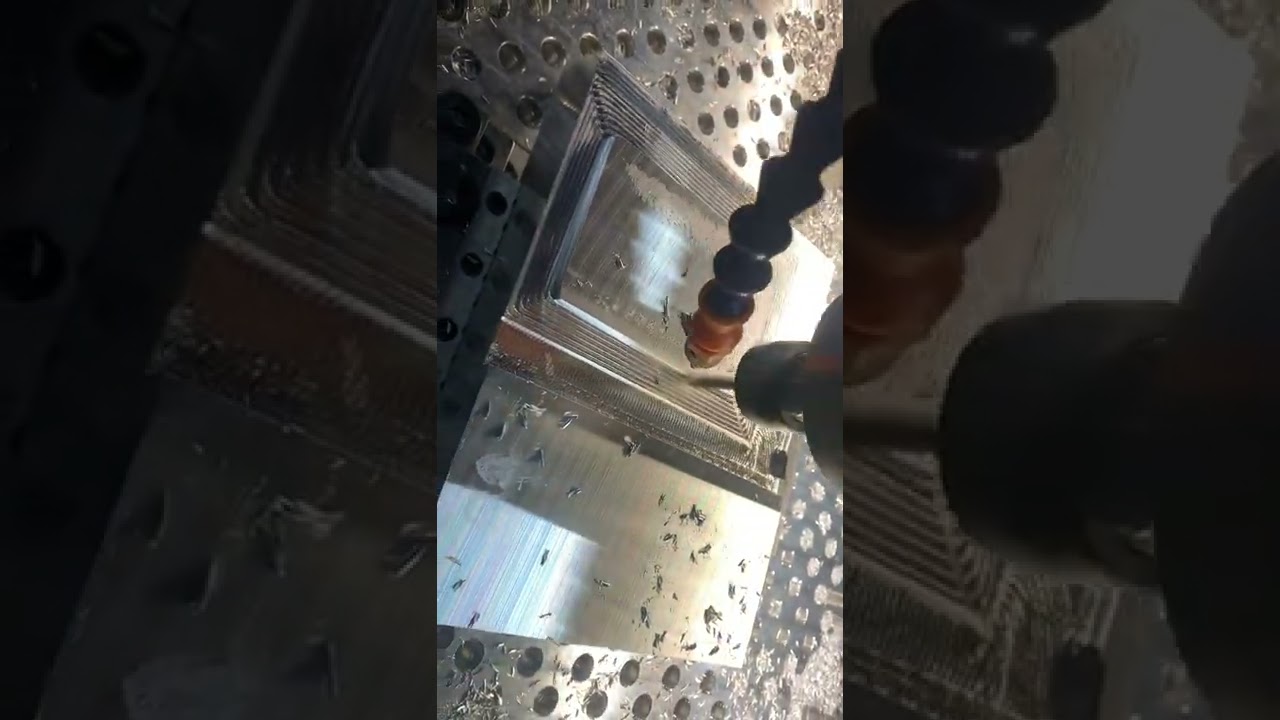

as well as some video of it being machined.
8lbs removed out of the z axis starting block
