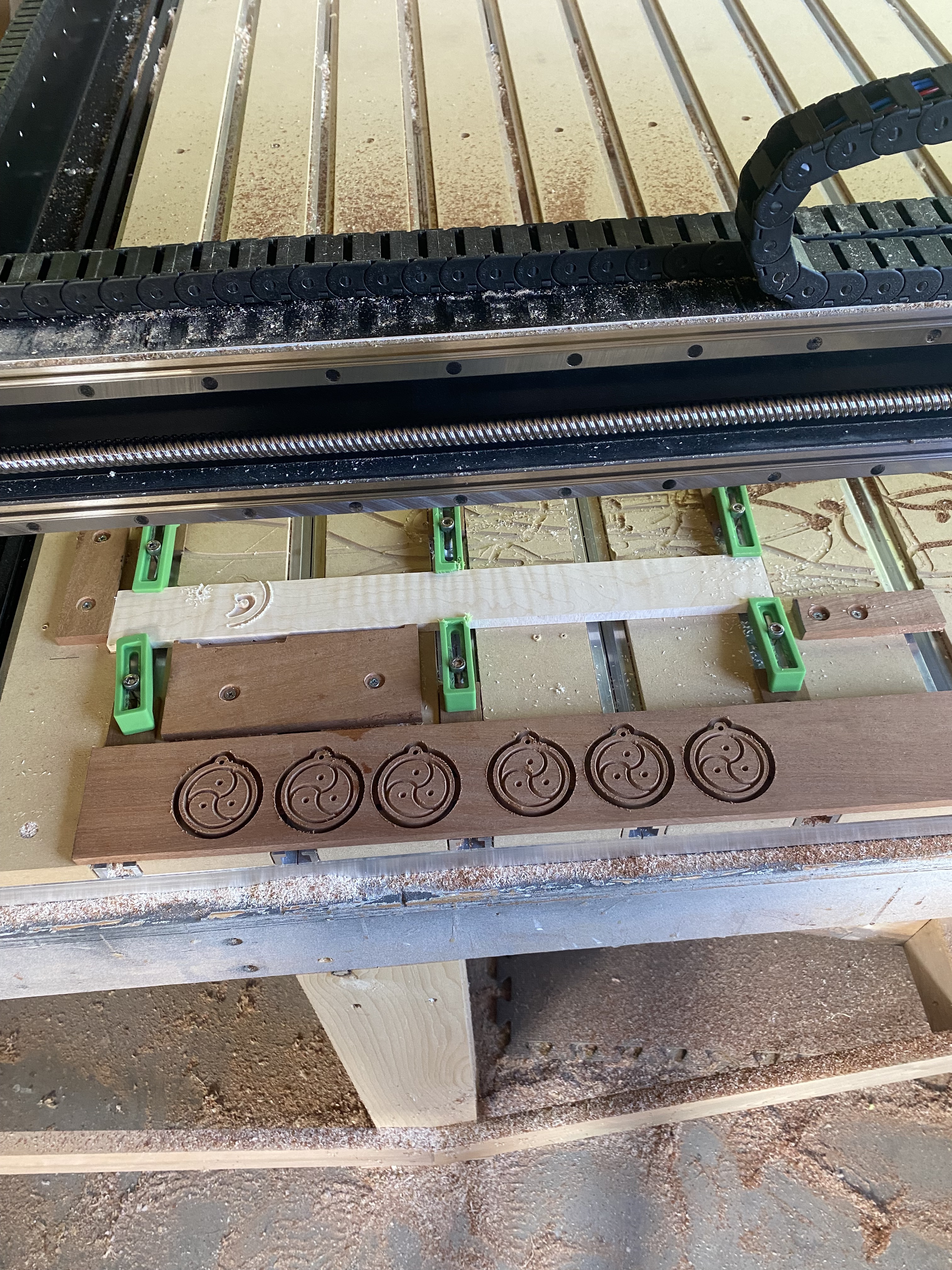

here are the 2 files the first one or the pocket side came out right ill post the pic of it done.

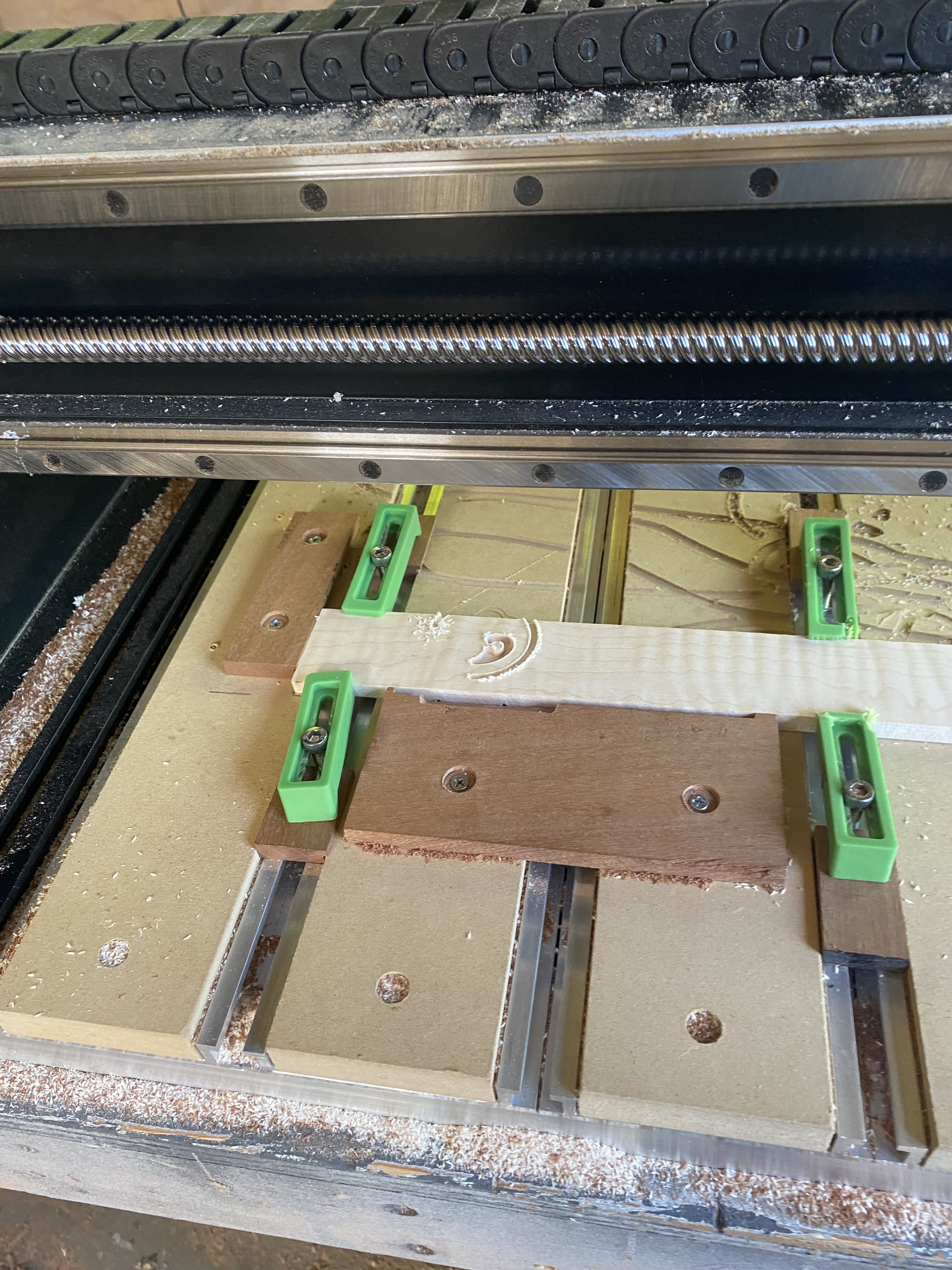

the second pic shows how i clamp and also the way the machine cut wrong on the piece still clamped.
I reset the X Y and Z to zero using (against recomendations from the forum) the bottom of my stock as my zero.
i followed the tutorial and used the paper feeler gauge to set z to the base of my machine.
im not sure how you mean to say how i handle my tool changes ?
the process seems same as when it works though. I turn on CM it tells me to put in the bit it wants first then it sets the height on bitsetter, then it has me turn on the router and then off to cut. if there is a tool change in the file then the machine stops and raises up and asks to shut off router then repeat the process to set the next bit.

Just looking at it the only thing I see is that the material height is not the same between the wood for the pocket and the wood for the plug. Seems like the plug material is to short for the plug. Maybe someone else sees something.

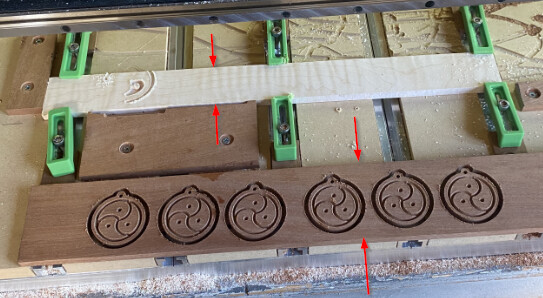

Your inlay stock looks quite a bit narrower than your pocket stock. Yet in your design you have them both set to 2.75 height, and the vectors are about in the same spot.
Sorry guys Iām getting a bit spun. I was having a lot of problems with the inlays but at this point the machine is completely missing the wood on the top half of the cut can you see that in the picture of the light colored wood?
I made this exact file yesterday and have an awesome pendant that came out of the file but I only made one at a time
And today when I went to make six at a time by copying pasting in those same files, the first one came out fine and thatās the one on the darker wood and the second missed the wood on the top half of the cut.
Also, when measured with a caliper, those differences between the woods that you see in the Files shows the same on the calipers, theyāre actually different by that much
These 2 widths (Height in the CC file) are remarkably different. The lighter wood for the inlay would need to be about 2.1" to get the entire inlay on the wood.
In the first pic, with the darker wood below the clamped lighter wood, the darker wood has the pattern one way and the lighter wood has the inverse of that pattern. I am meaning that the design looks to be:
- flipped 180deg in either the X or Y axis, and
- it appears that the parts that are cut in the darker wood are left āraisedā in the lighter wood (i.e. a dot cut out in the bottom set is left raised while the surrounding is cut in the lighter wood).
Is this intentional? It is as if the lighter wood shows the cuts from the backside of a 3d āshellā of the objectā¦
Yes, the flip is intentional you have to mirror the image when you do an inlay because you flip it upside down
I was going to suggest a scaling issue, and it kind of is. Itās just the wood was scaled down, not the model being scaled upā¦
Yes, the widths are notably different because Iām cutting the pendant and the image out of the darker wood ās and only the image on the inside out of the lighter wood
I believe the lighter wood on the inlay side of those two files should be 1 3/4 of an inch. I guess in width is what you would call it up and down in the picture though.
