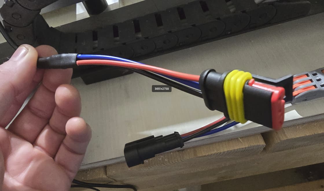

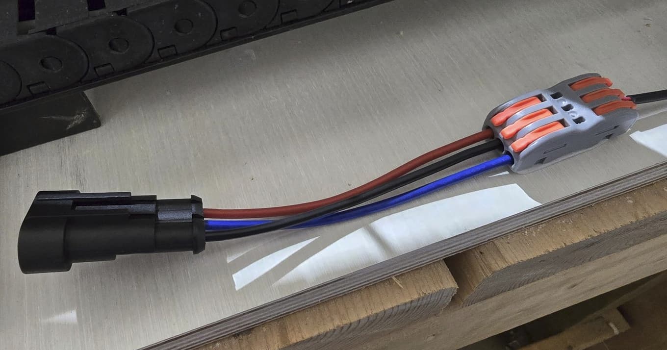

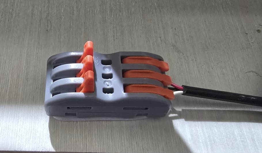

The first step for me, was to make their existing probe harness something that I can use for multiple probes. The PGFUN probe came with a locking 3 wire lever nut splicer. I added a little double sided tape to secure it, and spliced the probe wires into this. To allow me to quickly connect the different probes I purchased some 3 pin automotive wiring connectors. Here’s the basic setup for the connectors:
Lever nut splicer hooked to the probe harness wire coming from the board:
Quick connect female so I can swap probes:
My bitzero cable with the male connector:

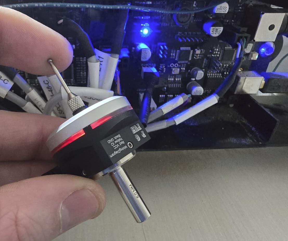

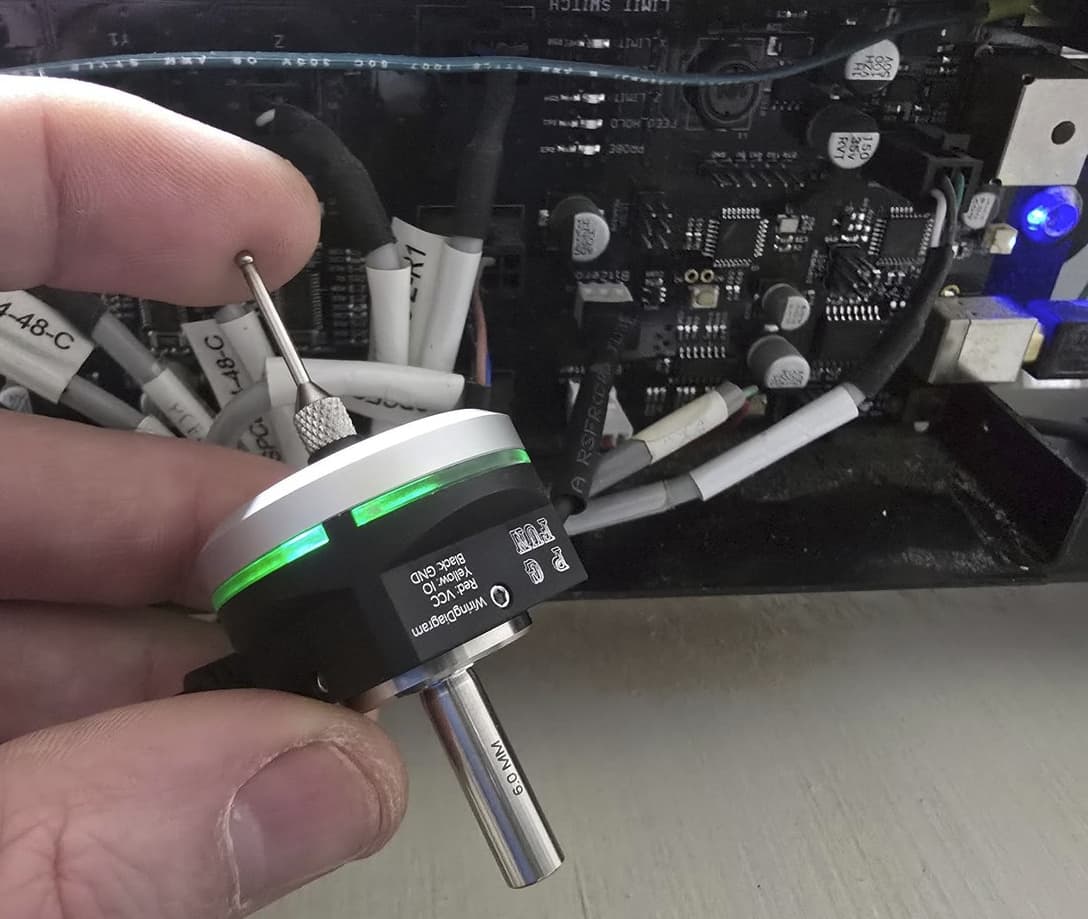

Well I have some good news. The PGFUN touch probe does in fact operate off the voltage supplied by the C3D bitzero circuit (5v) and I was successfully able to power and test the nominally open version of the probe. So just a reminder, the nominally open probe sends 0 current on the signal wire until the probe is tripped, then it sends the current that is powering it, so +5v.
Here is the probe hooked up to the bitzero circuit (red wire = 5vdc, black wire = ground, white wire = signal/IO)
And when triggering the probe, note the blue led on the control board indicating probe:
So that’s a wrap, I have a fairly easy quick connect to switch between my bitzero probe and the touch probe, as C3D would put it “plug and play” … also they did at least silkscreen the basic info for the circuit on the board, I hadn’t noticed that previously. But we’ll never know if the probe circuit can handle more than 5v on the IO wire… but we don’t need to worry with this touch probe since it can’t send more than it’s receiving.
