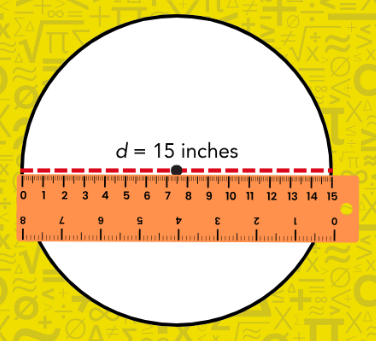

Usually with circle shapes you use the center as zero.
If you have a good quality Center Finder or similar head for a rule the center is easily marked.

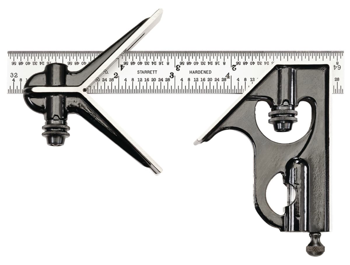

As @WillAdams suggested use a square with the v shaped head.
If you have perfect circle then put the square about 90degrees apart and mark with a pencil and make an X.

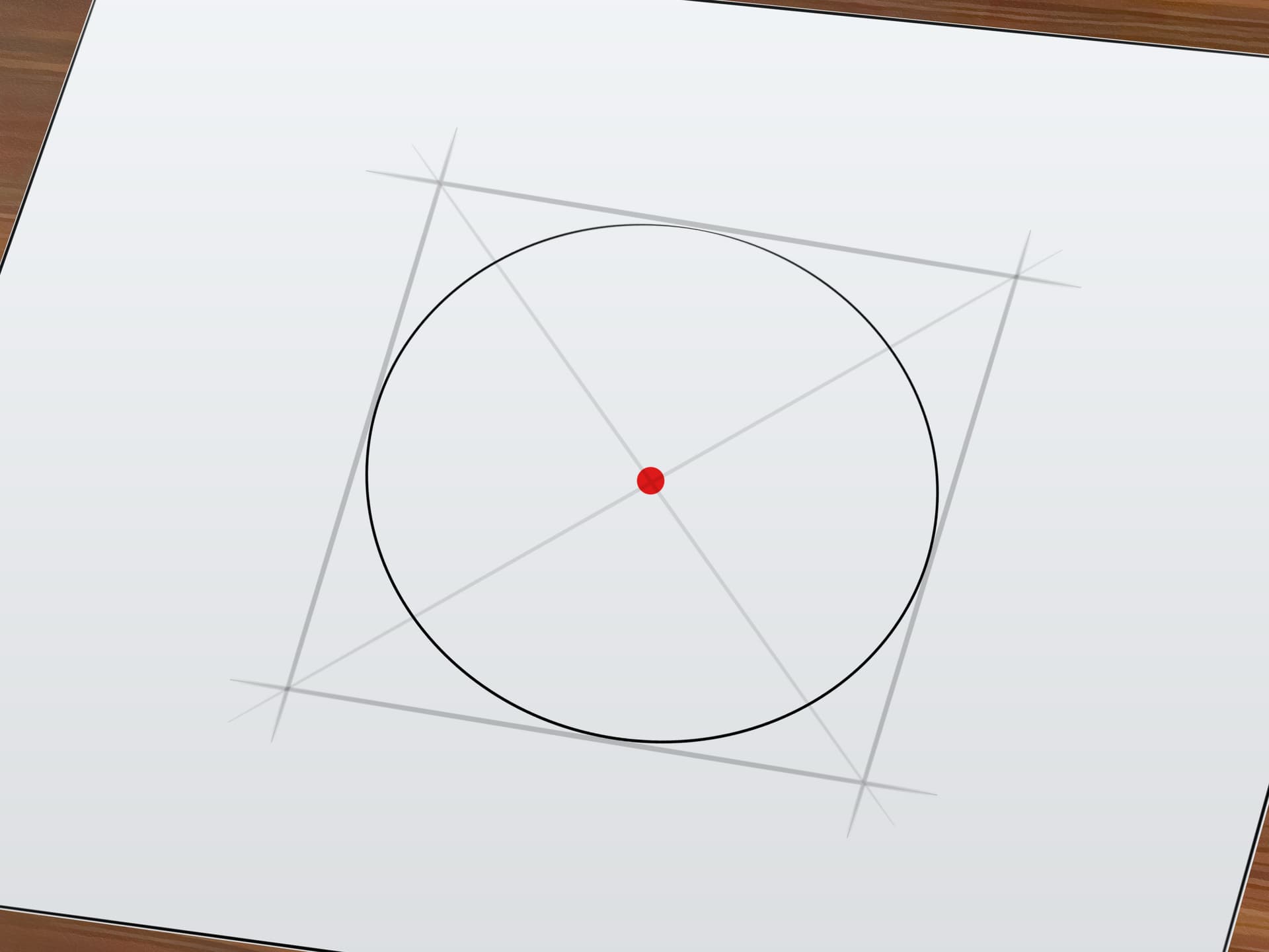

If you don have a square with the v head then draw a square the same dimension as the diameter of our circle. Draw a line from opposite corners and overlay the paper on your circle and punch through the paper with somthing sharp.
I just found a copy of Starrett’s 1980 100th anniversary catalog on the shelf up here in the engineering department. It pointed out that Mr. Starrett invented the combination square in 1877 and it was his company’s first product.
The older advertisements for the combination square were a hoot. They have a bit more at:

I just use a ruler or tape measure & mark the center in several different directions.
It’s close enough the design looks visually centered, even if it is off by a tiny bit.
