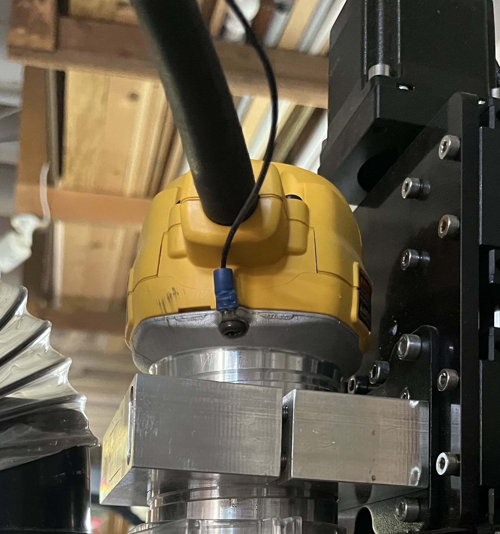

My Dewalt also doesn’t have a ground wire but I added one by removing a housing screw that went into the metal body. Ran that over to a grounded conduit.
I think that 1 change made the biggest difference.

Here is how mine is done.

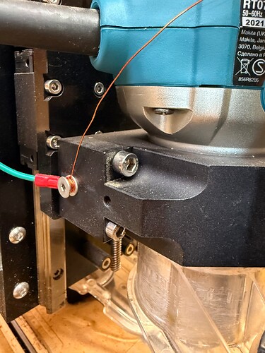

I get disconnects after a minute.
May I ask
I have a copper wire here but that hasn’t helped - it wraps round the hose all the way back to an earth
Perhaps it has to be on the router body like you have?
Where does the other end of your black wire go?
Do you think the wire should be insulated?
Is that an enameled copper wire you have there?
If so, it might not do much.
ok, I will try a “proper” bit of insulated earth cable. You can see from the picture that the black mounting is earthed via the green cable. But does the router need earthing as well or are the mounting and router electrically connected?
The router should be double-insulated (to comply with safety requirements for a hand-held power tool), but the housing/metal body arguably should be connected to ground — the aluminum mount is anodized, which may interfere with that, so the usual approach is to connect the spindle body to the dust shoe/hose which in turn go to ground.
