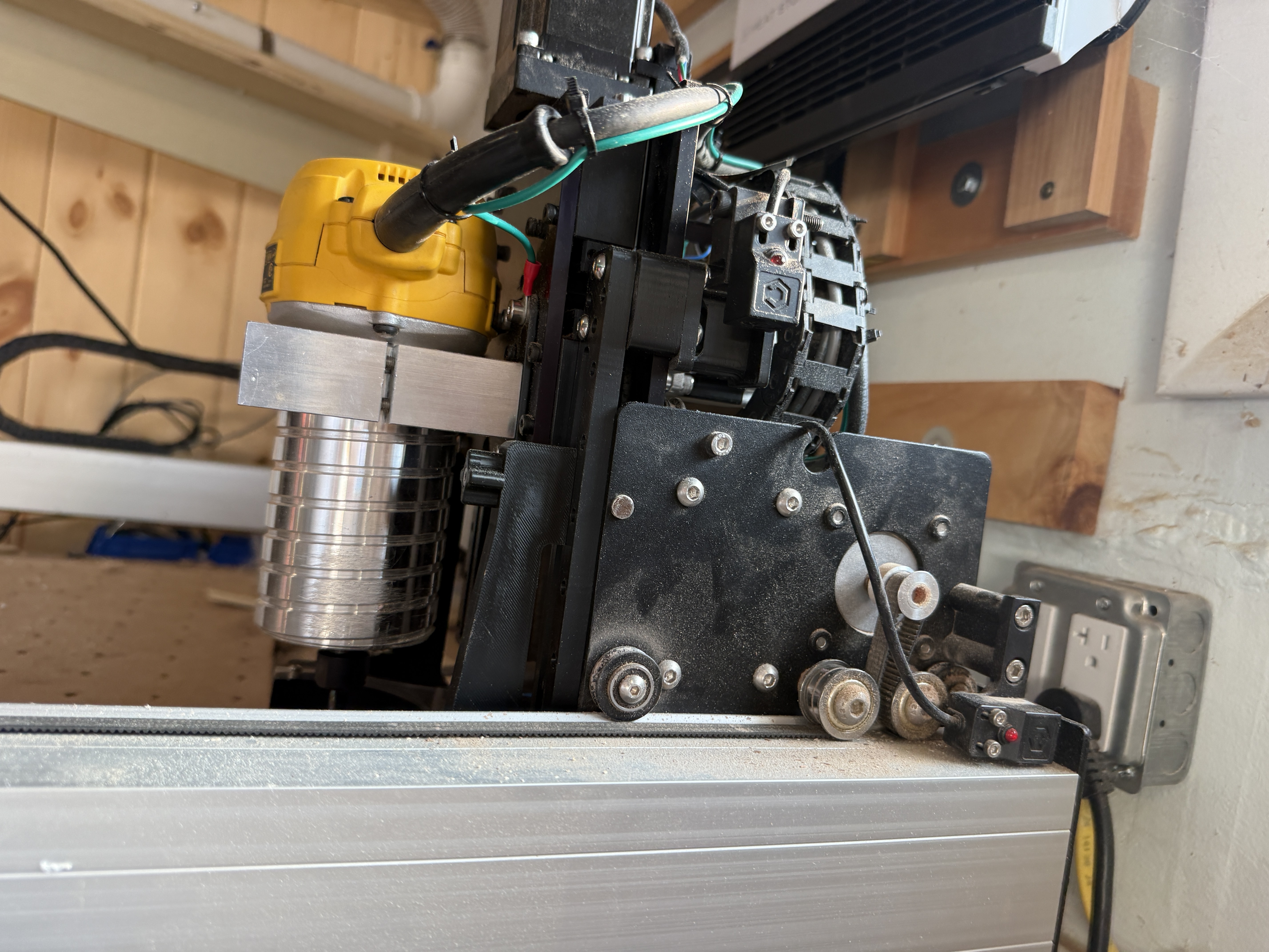

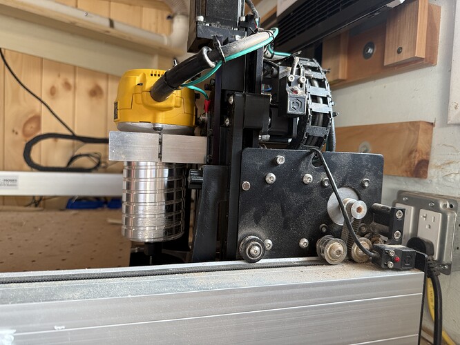

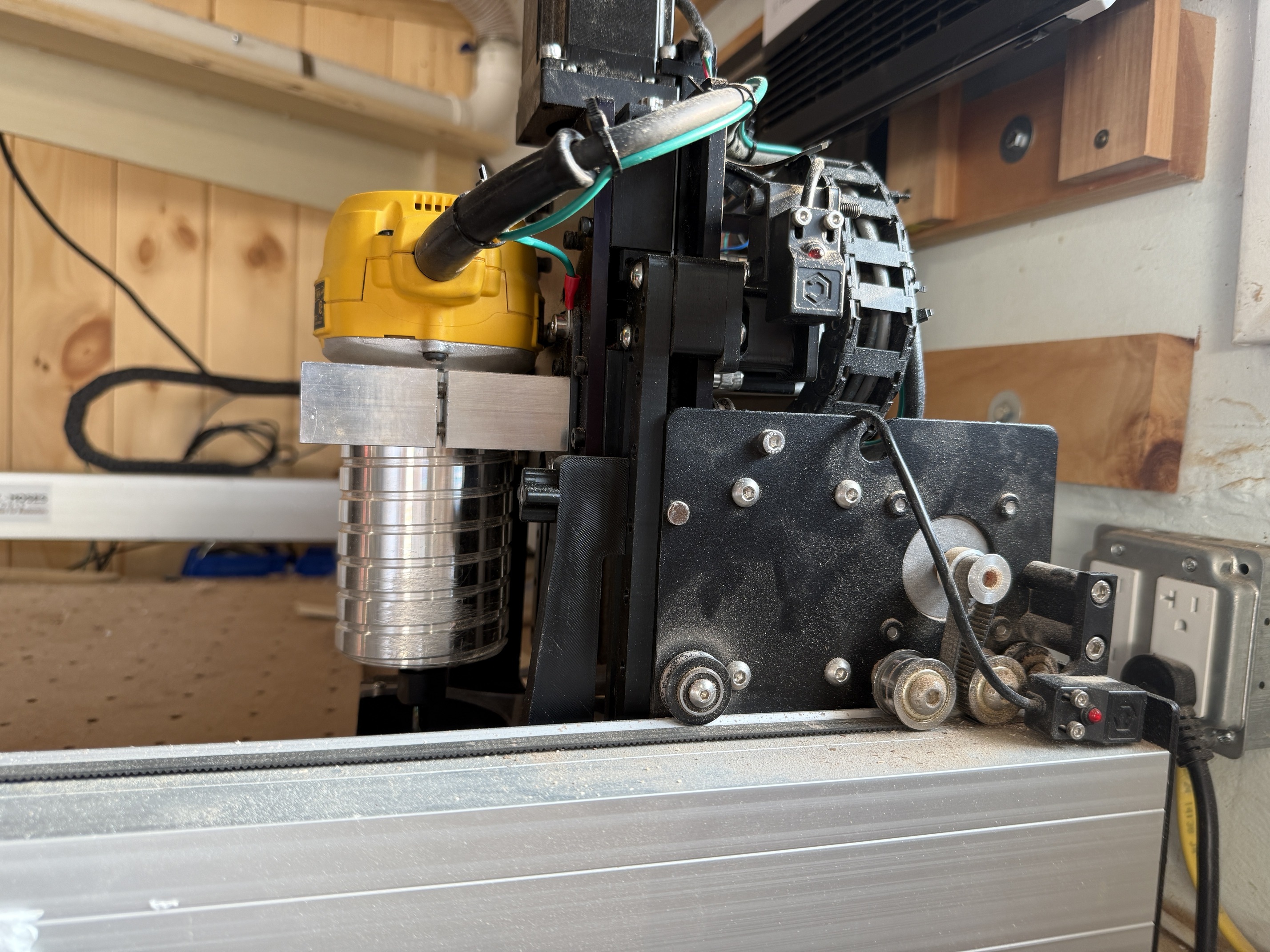

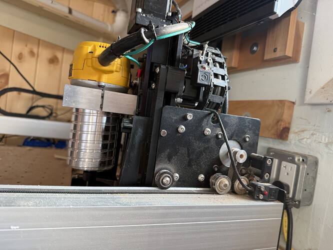

I recently upgraded my cnc. I put in the new PCB with the bit runner connection. I also put on the pwncnc dustboot v3. While initializing my machine, I get a nasty clicking sound followed by a grbl 9 error.
I can’t upload my video, but based on the pictures, do you think it’s my y axis home switch?
How do I fix this?

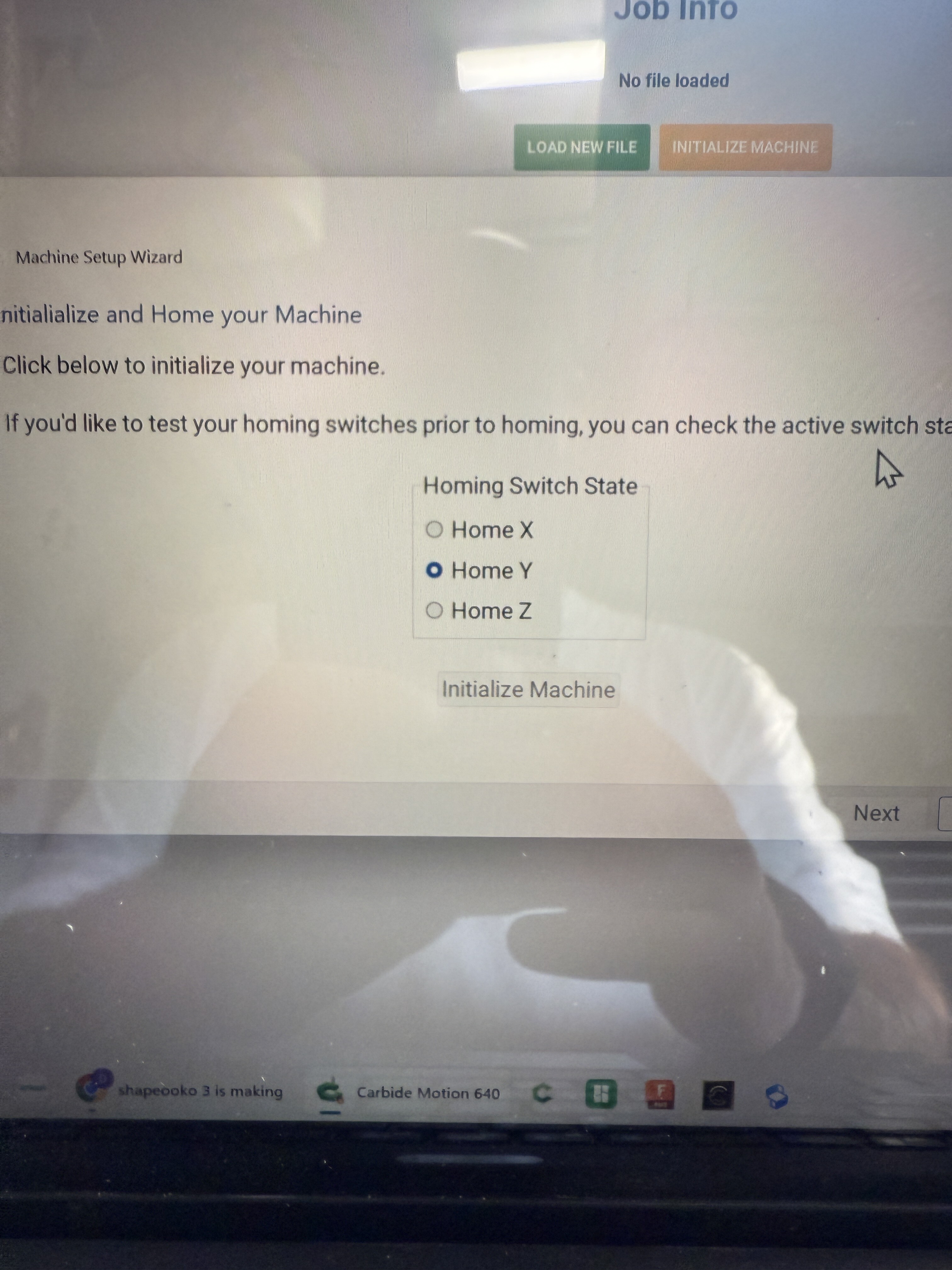

Is the Y proximity switch light up red? It’s hard to tell in the photo. Your screen grab shows it actuated so the red light should be on. If the red light is not I would think the switch is bad. When the switches have the red light on them they should show up in blue as yours shows on screen. My 5 Pro did the same thing on initialization, the switch was bad. Swapped the switch and all was good.
You can down power the machine, slowly move the X/Y axis to the mid point, power up the machine - do not initialize and then check the switches and see if they actuate correctly.
Power down and slowly/gently move the machine to the middle of motion for each axis.
Power up and go to Settings | Debug — is the Y-axis homing switch still stuck on?
Yes, they all turn red when I put a wrench near them.
I was able to fix it. The homing switch was too far away from the x axis rail to have it pick it up.
