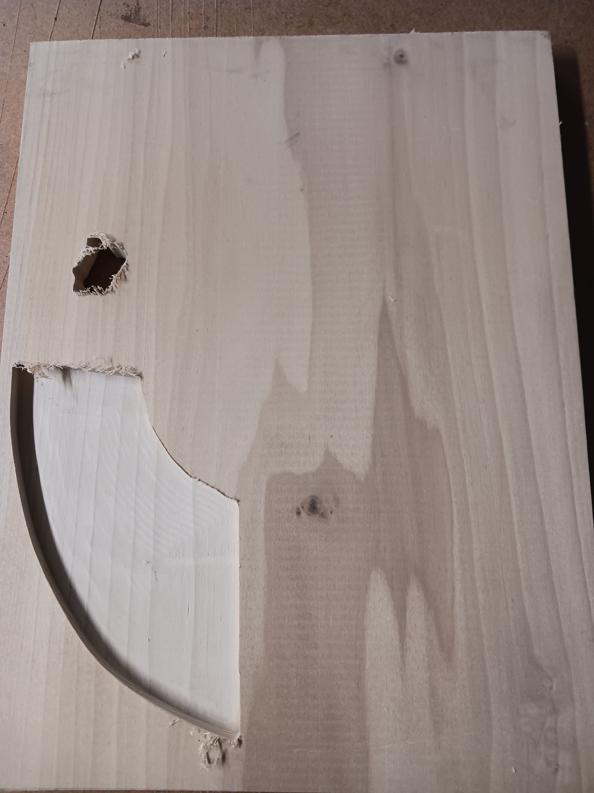

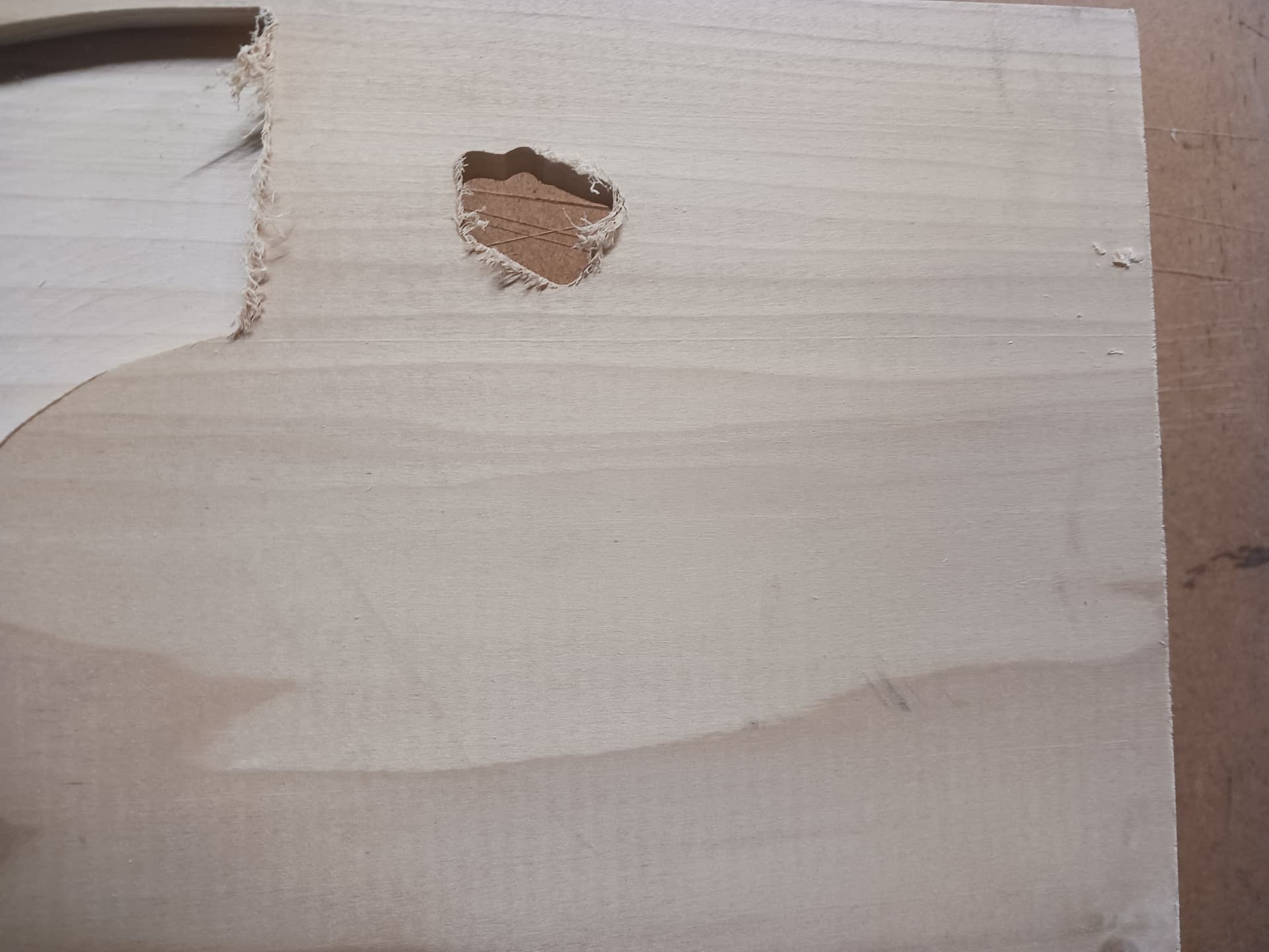

Looking for reason my Shapeoko did something I didn’t expect. I had made a couple of vegetable trays and all went well. Then the other day I was making another and the first partition was cut out as it should, then when I started the next partition the router took a dive into and through the 3/4 inch board in about 10 seconds, leaving an approximate 1 inch hole.
any ideas would be appreciated. Would like to keep this from happening again.

The SO3 is a very good machine but it is all belt driven. So depending on your F&S you can come off the rails and you get your problem.
Check all your v-wheels for cleanliness and the rails. Check their adjustment by lifting each end of the gantry and you should have no slack. Lift the Z and there should be no slack. If either lift then adjust your v-wheels. Look at your belts closely and depending on what model you have basically your finger should fit tightly under the belt at the half way point.
Power off your SO3 and manually and slowly move your gantry forward and back a few times. If you find any tight spots address that. Then move the Z carriage back left and right a few times and same check for any tight spots.
Vacuum hoses that get tangled up can cause you to loose steps. Also your router cord can get tangled up on the top of the gantry and cause you to loose steps.

If your router was not running while it was supposed to be cutting then that likely caused your problem. The Z keeps pushing the router bit down into the material but if the sharp cutter is not rotating and cutting away material it will stall your movement.
If your router is not running during cutting it is likely the brushes in your router. If you have a C3D/Makita router the brushes wear out fast and after about half their original length they get hungup by the little wire inside because it is not long enough to allow the brush to make good contact with the armature of the router motor. The brushes are very cheap and are available from C3D, Amazon and other retailers.
