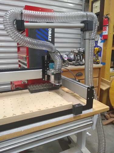

Here is my xl with a boom arm. From the supplemental spoilboard is 27 inches. Obviously I dont have an enclosure but the bottom of the boom to spoilboard is 24 inches. I bought Peachtree 2.5 dc hose that os very flexible. So if you come through the top centered on the spoilboard you should be ok. Notice I have the dc hose tied to the Z motor to keep the hose from getting hungup from flopping around.

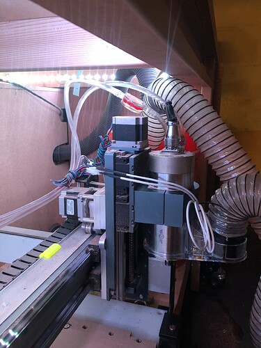

I know we all have shop space constraints, but if there is one thing I have learned while building 4 enclosures for my Shapeokos, is that it’s a really bad idea to minimize the enclosure height (which I did, initially)
  • as already noted, the dust collection hose will be a problem, and you would really need to come up with a very smart pivot ring to NOT have the slack get caught up in the Z axis as it moves
  • have you considered loading/unloading stock from the wasteboard, and simulated doing it with a low enclosure ceiling? it’s the most annoying thing.
  • machine maintenance…there will be times when you may need to access the rear of the machine, so with a low enclosure height you would have to pull the machine out of the enclosure, which is no fun.
  • upgrades: if you fancy a water-cooled spindle somewhere down the line, you will not be able to install it as it requires extra clearance above the Z stepper motor
If you need to do it, you need to do it. But if there is any chance you can fit your Shapeoko elsewhere with more head space, you will be very, very happy you did :slight_smile:
