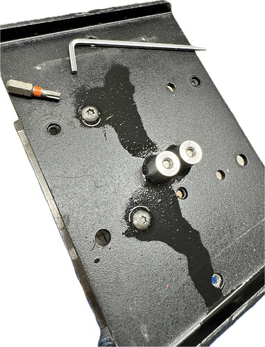

Hi,
I’m in the process of deconstructing my old Z Axis in order to install the HDZ4 upgrade.
And no matter what I tried: I can’t unscrew the spindle holder. Those two innocent screws remain tight whatever I do. Any suggestions? Of course I’ve already stripped the screw heads (remember: I’m supposed to be re-using them :wink: ).
Ideas, anyone?
Thanks,
Christoph

Photo showing the current state of things?
That’s a viable option, nice. But before I shell out another 100+ €: what about just flexing the screwheads off? I’ve got nothing to lose at tthis point…
Some (superintelligent) gentleman gave me the advice to try hammering a tork bit into the hex screw and the bit stayed in place but not even with a spanner was I able to turn this dran thing …

There’s not much (if anything at all) to get a grip on. These are rounded off flat head screw…
I’ll try an extractor…

Look at the tip on the bit from the photo it looks like the center of the tip is out past the teeth on the bit. Grind it flat then tap it into the screws. if you have one of the old time impact nut driver you can use that to bust the screws lose. This is the tool I’m talking about. its a hold down and turn then strike it with a hammer.

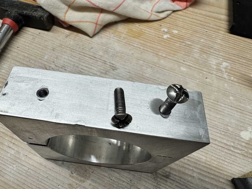

Use a dremel and thin cutting wheel. Cut deep slot. Use the largest flat head screwdriver and make it loosen.
I’ve drilled many of those heads off with a good quality bit. Just use a bit a little bigger than the torx size wrench.

No blood was spilt at all and hardly any tears …
In the end it was the Dremel, a big screwdriver combined with a wrench and (silent) swearing.
Loctite … grey stuff in the threads … :wink:
