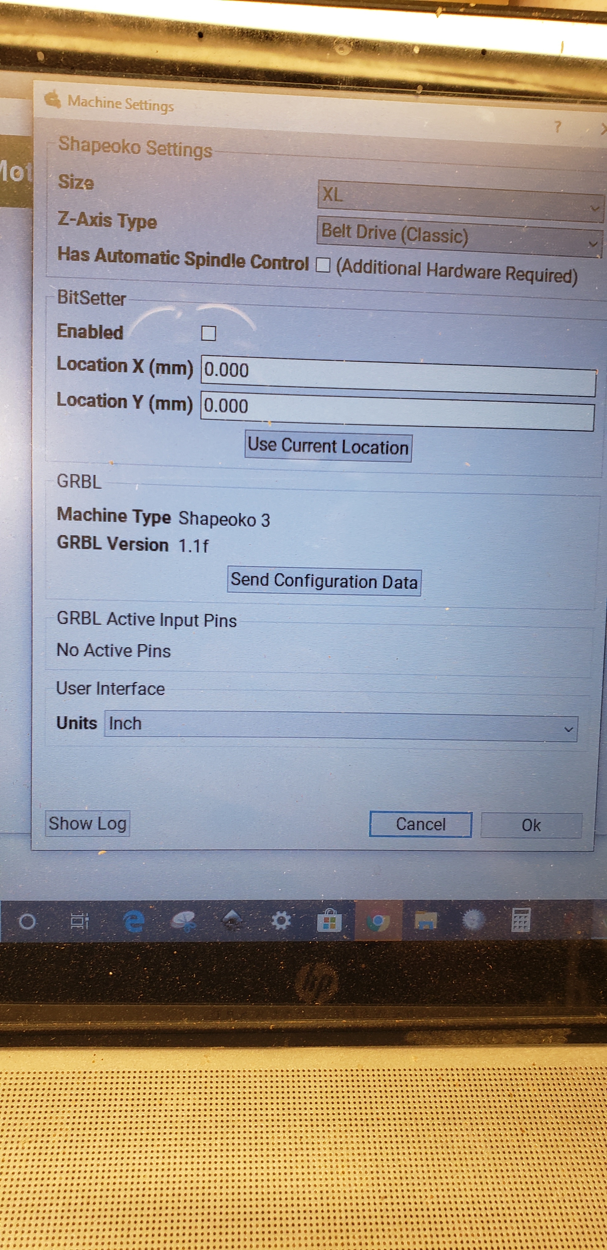

Can you get to the settings screen to see if the Shapeoko thinks any of the three home switches are active?
Where would I find those settings at? In carbide motion?
Yes, in Carbide Motion, go to the Settings page, there’s a pane there where active inputs are listed.
Active pins shows there are none, if that’s what the reference is to
