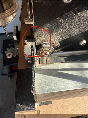

I just built a new stand for my Shapeoko. When I was moving it on, I moved the x axis all the way forward and found that the gantry does not touch the front on both sides. Here is a shot of the left side.

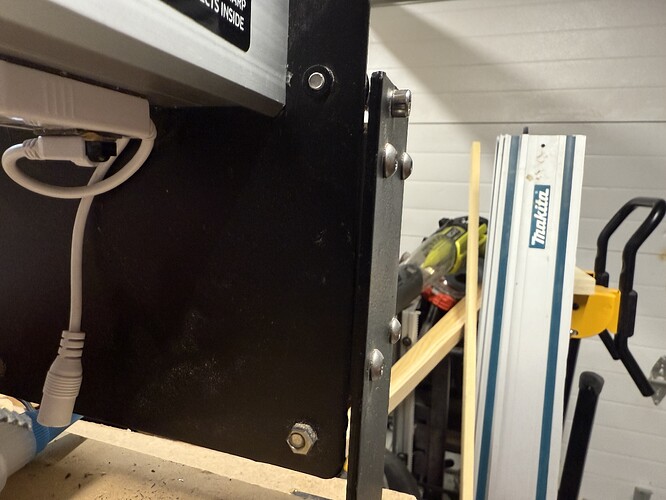

And here is a shot of the right.
It’s about 3/16 off. This might also have been contributing to my previous accuracy issues. Anyone know how I can fix this?

Check the opposite extreme of movement, there are three possibilities:
  • the Y-axis rails are unequal in length and this is caused by that (early machines had rail ends cut by the extruder, normally this is quite square/even/equal, but not always — this is why we now have a CNC machine large enough to machine both ends of a rail)
  • the Y-axis rails are equal in length and the rails/end plates are shaped as a parallelogram
  • both the Y-axis rails are unequal in length and the rails are not square
In my experience, the best approach is to work from large → small:
  • level the table (optional, put a sheet of foam in-between the table and the machine, dampens noise/vibrations, makes leveling easier, addresses sag on larger machines)
  • ensure that the end-plates are level
  • Y-axis rails level and parallel to each other and plumb/vertical
  • gantry level, square to the Y-axis rails and plumb
  • carriage level and plumb
  • Z-axis level and plumb
Shim as necessary to get things to line up.
Shimming in the correct spots will fix this. Here is my post from a few years ago that shows how…

Shims should be placed/sized so as to result in the machine being square — they would only be the same on each side if the rail was cut as an even parallelogram (which is possible, even likely).
Aluminum foil is kinda thin and deformable/crushable. For that reason I didn’t use aluminum foil - I used aluminum from a Coke can, which is .004" thick. Three layers of .004" closed my 1/4" gaps exactly. My two gaps (back left/front right) were both 1/4", so both spots got three stacked shims.
