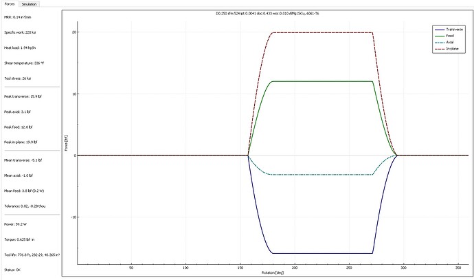

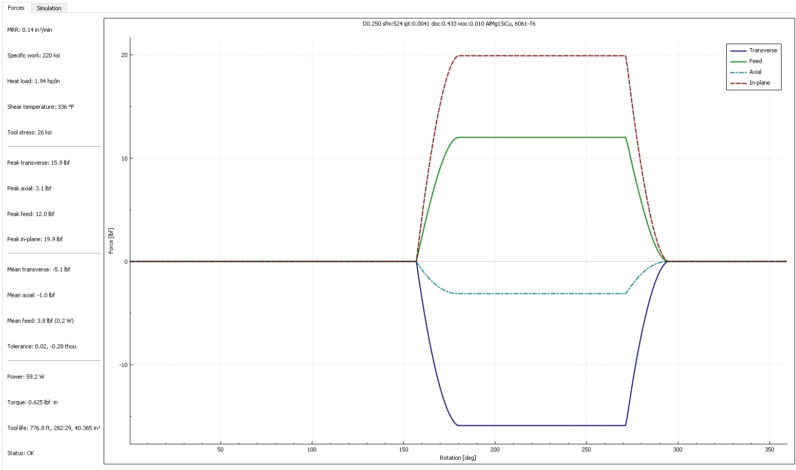

Out of curiosity, what analysis software were you using to generate the above graph?
(seems like it’s Millalyzer)
