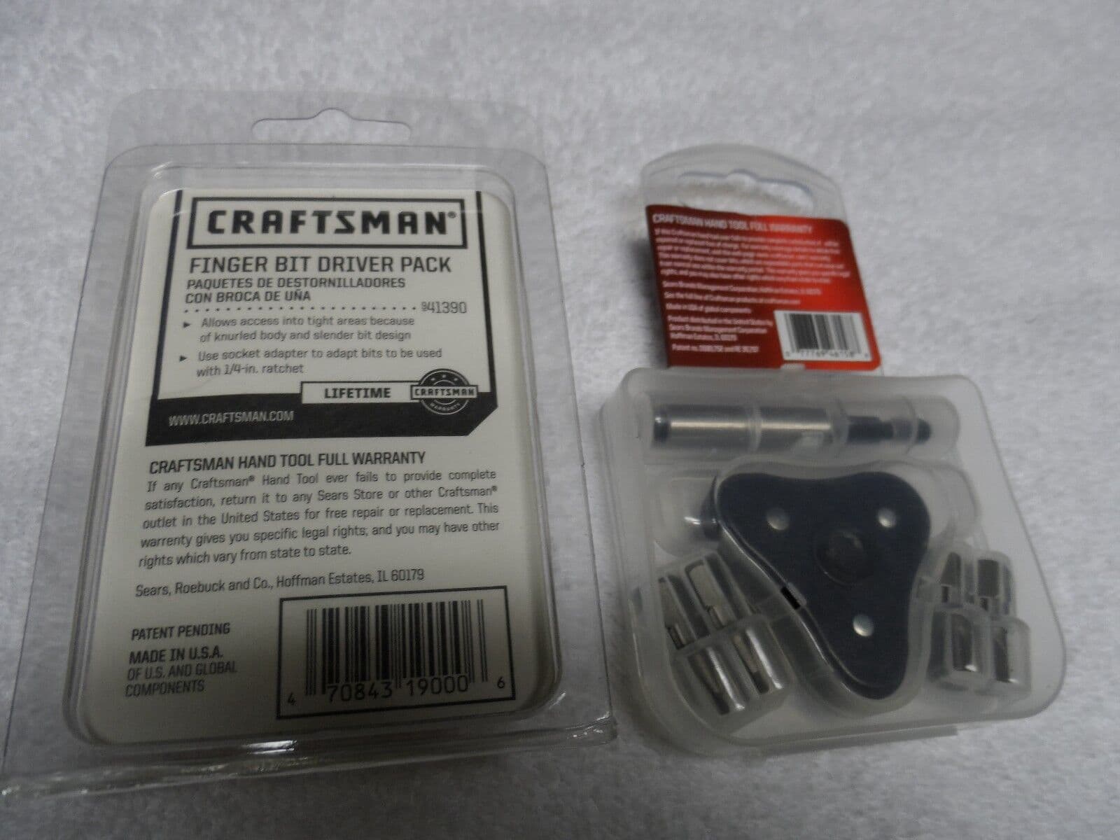

One other thing — either a T-handle set of hex wrenches (Bondhus is one good choice, and I’m currently using a Wiha bit set, though I keep telling myself I’m going to spring for a set of PB Swiss T-handle wrenches) or (or maybe and) some sort of small ratchet.
I used my most-favourite tool ever:
(though mine is a first-gen from the Kickstarter)
to assemble all of my machines since getting it, though for working on workholding I use a “Craftsman 6 pc. Finger Ratchet”:
(long discontinued)
I have seen the same kit under a different brand (presumably the manufacturer, or some other company which contracted for it — if you find it, don’t overpay… if it’s expensive, there are better options, it only makes sense 'cause it was a good value when first released), but probably easier to just get a Chapman Manufacturing Palm Drive Ratchet:
and a set of their bits:
If: #321 Bicycle Set | Chapman MFG – Chapman Manufacturing came w/ JIS bits I’d recommend it, but it offends me that folks offer bike-specific tools w/o a set of JIS bits for working on derailleurs (Silca get a pass since they don’t specialize in bits, and I have a JIS bit set from Vessel in my Altoids case next to it in my small precision tool bag), so I guess:
