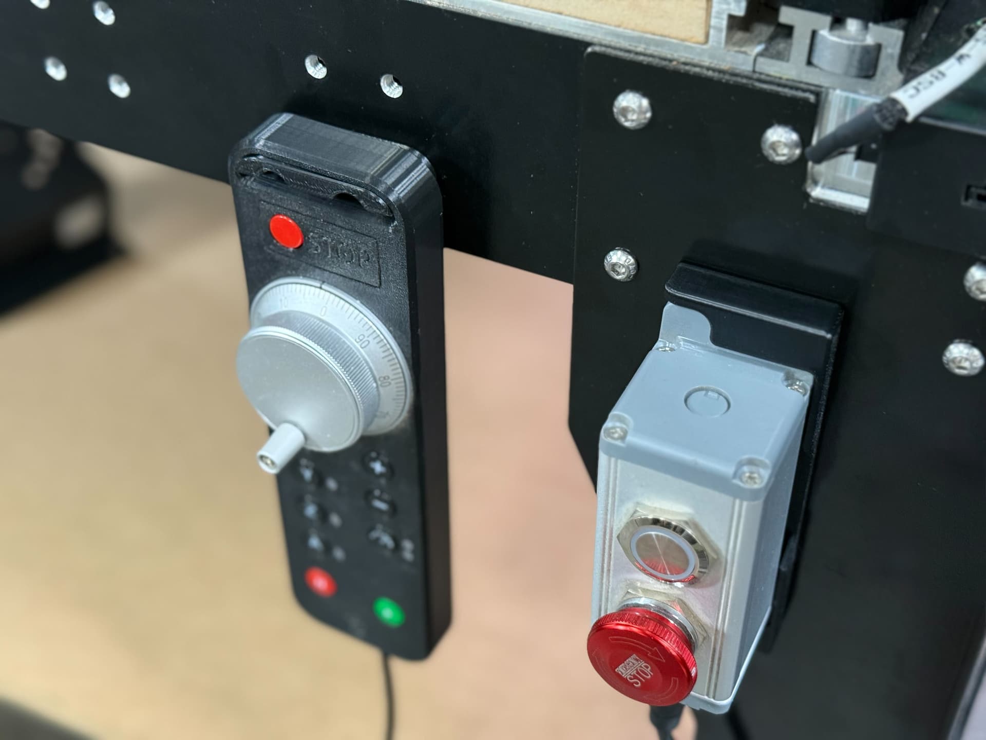

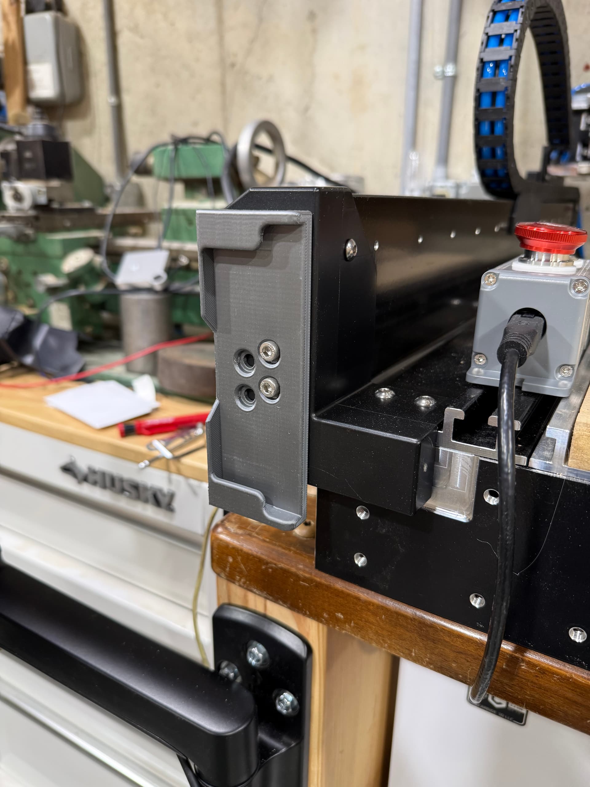

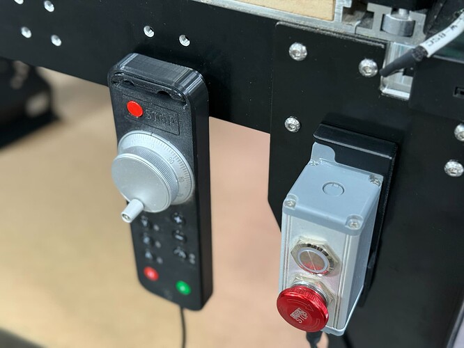

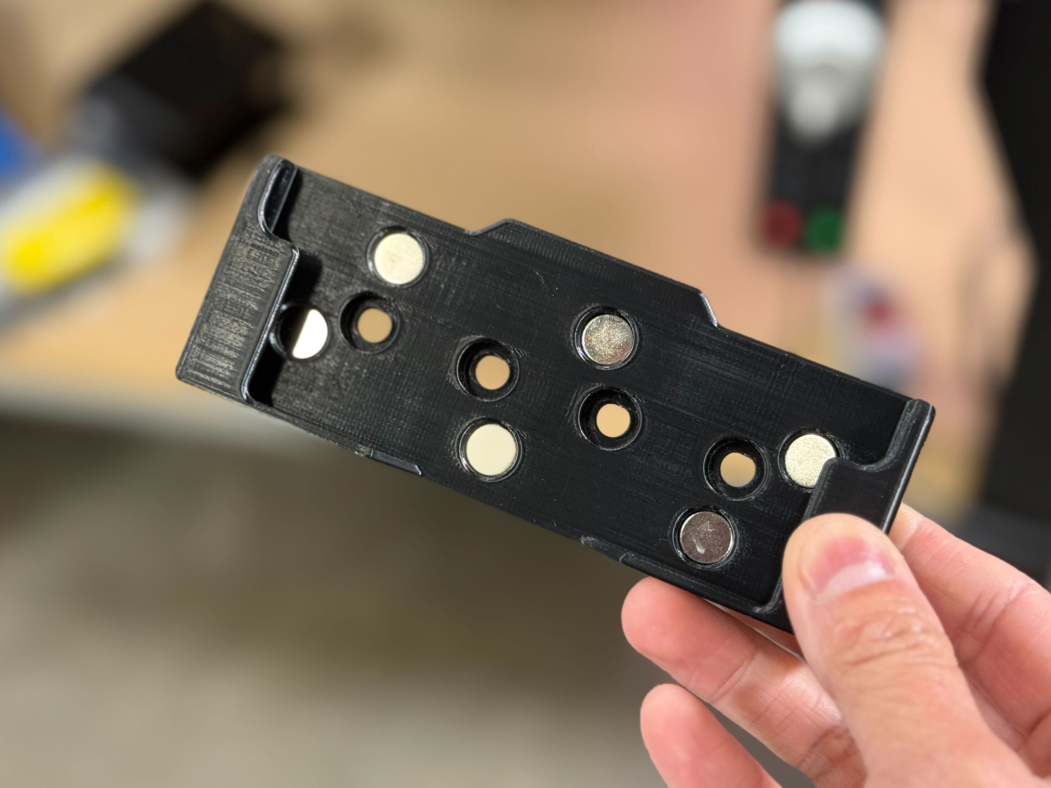

E-Stop Pendant Dock
Ever since we got our leg kit, I’ve thought the steel frame would be great for magnets. So I designed a prototype with 6x 10mm disc magnets (fits 3-5mm thickness). And I liked it a lot, but Rob felt that magnets alone created a risk of the pendant sliding down over time, or falling. So I added recesses on the back of the holder that would sit over the button head screws holding on the leg kit. And then I also added some counterbored holes in it so you could attach is rigidly to the front of the Shapeoko 5.1’s tube frame.
This dock (and hole pattern) is reversible, so you can position it in any orientation on the front-right corner of the machine. When I was working on this earlier, I would slap it on the side of the table, out of view. That position is also good if you don’t want to accidentally bump the e-stop button, but you do you.
I recommend printing it on it’s side (no support needed), and I used 0.12mm layer height (Bambu slicer) so that the holes would print as round as possible (despite the overhangs). The holes might be a little snug for your magnets, so I like to use something non magnetic to help shove them in (wooden dowel, or butt end of a sharpie worked well for me). Glue is optional if your magnets fit as tightly as mine do.
E-Stop Power Pendant Holder.zip (336.4 KB)

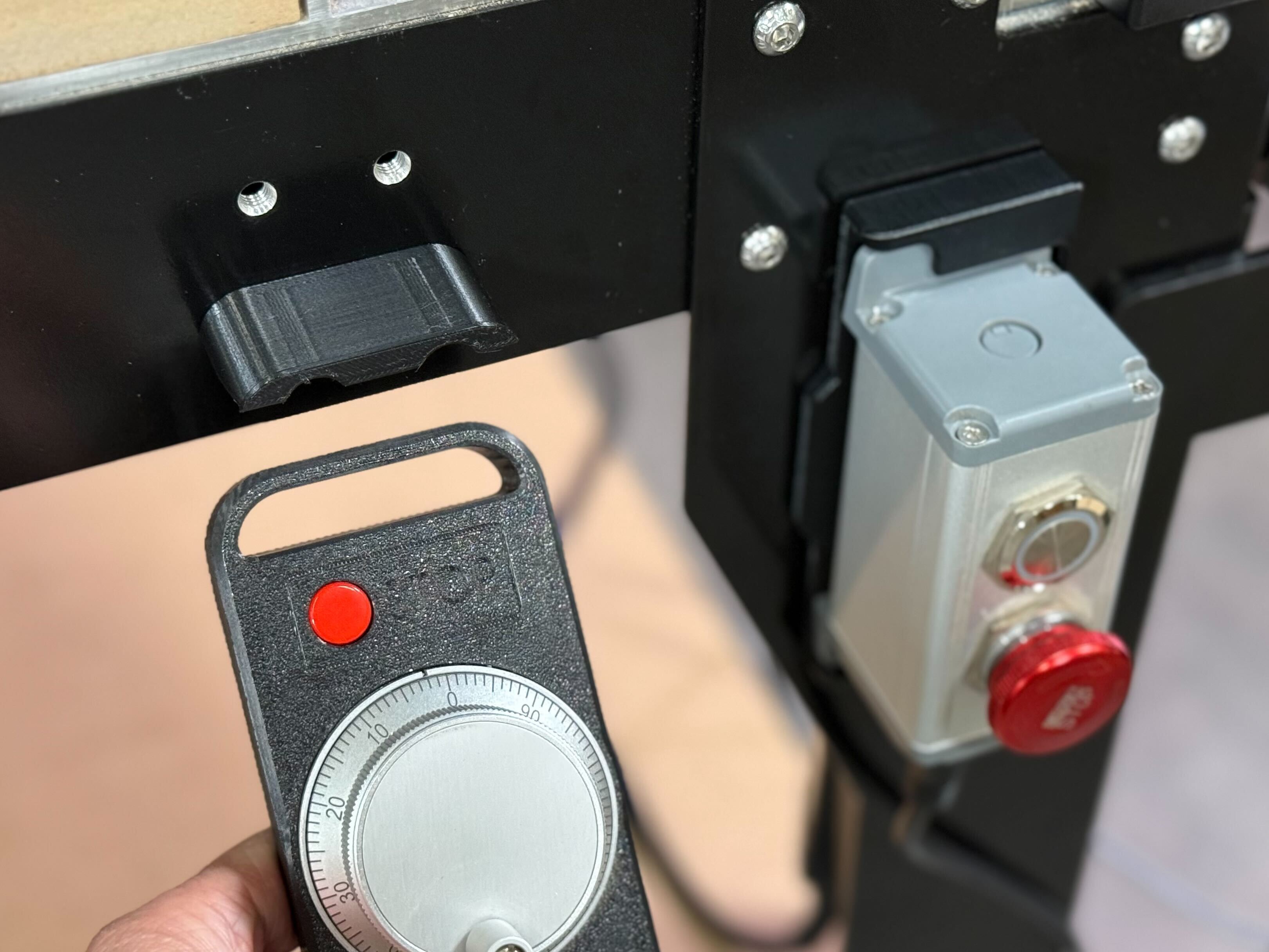

Jog Pendant Hook
I wanted a simple place to hang my jog pendant. I know some other people have come up with solutions, which I’m sure work great as well- this is just my take on it. Bolts to the front of the machine with 2x M6 button head screws.
Pendant Hook Prototype.zip (263.5 KB)

Thank you for these, Winston. Jog pendant hook is on our H2D here at work right now, even though I did not see a Nomad-specific version of the hook… :wink: I think that I can manage to run a couple of Strong-Tie screws through the holes into my workbench frame though…
I was surprised at the gratuitous use of PETG-CF, 8 walls all around and 30% gyroid infill, but then I remembered I had just recently had a mug of strong coffee… :smiley:
You know I like it when subtractive and additive mix. Great, functional designs!

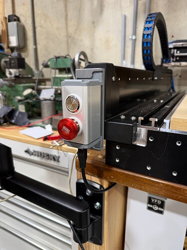

Nice designs, for the E-stop I mounted mine on the outside of the leg, I kept hitting with my leg and shutting down the cnc lol. The only other mods I did for my leg kit was drill new holes for mounting the spindle control and cnc control box to the inside so the machine would sit closer to the wall and nothing would knock into it.

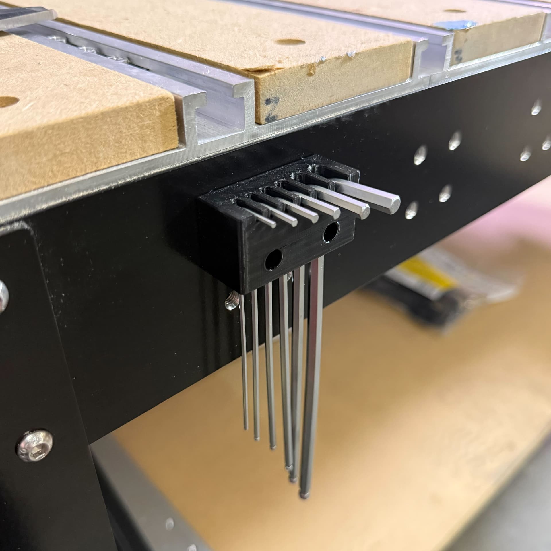

I got tired of tools walking away from the machine, so I made a holder for the hex keys that come with the Shapeoko. Secured with two M6 button heads, and fits the hole pattern on the front base frame tube.
This is a simpler V1. If I end up stabbing my leg too often when I lean over the table, I might do a revision where the heights of the wrenches are staggered and I can rotate them 90 degrees.

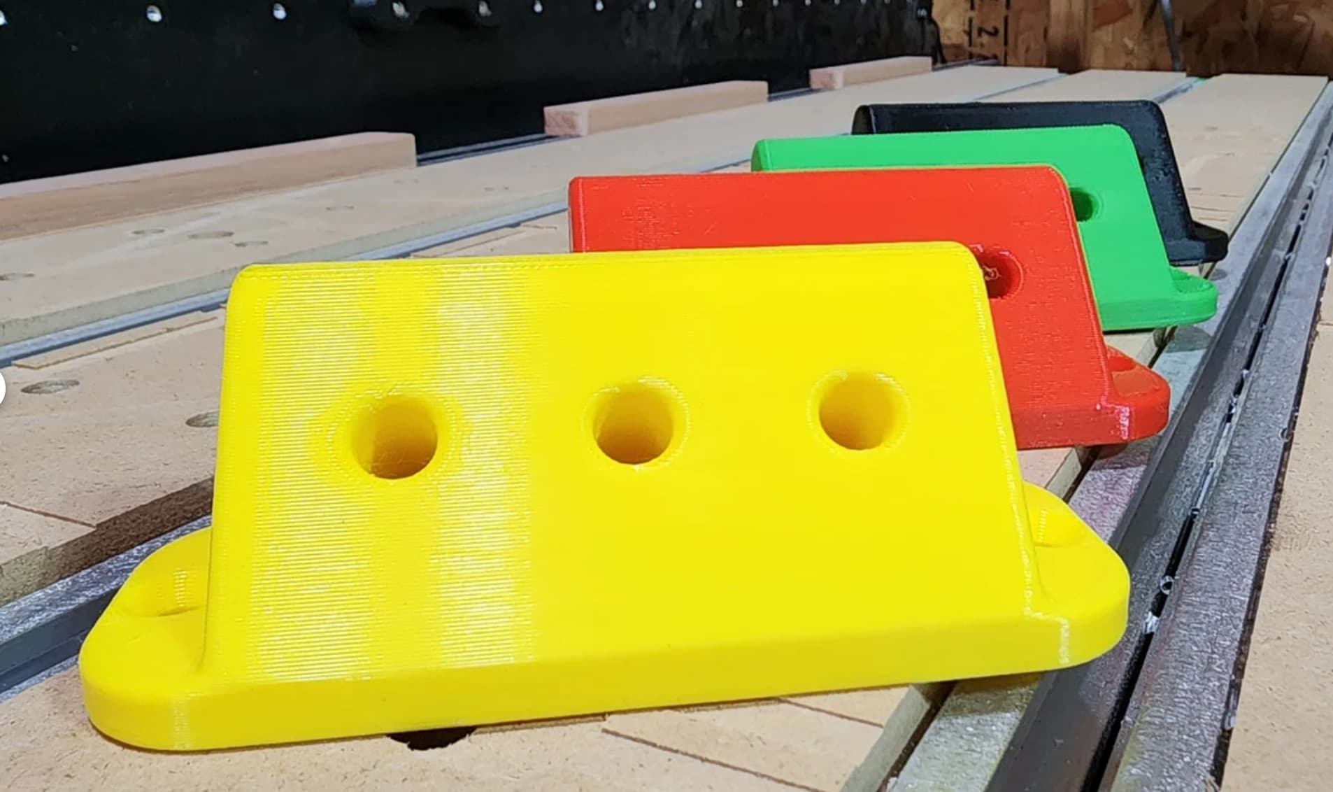

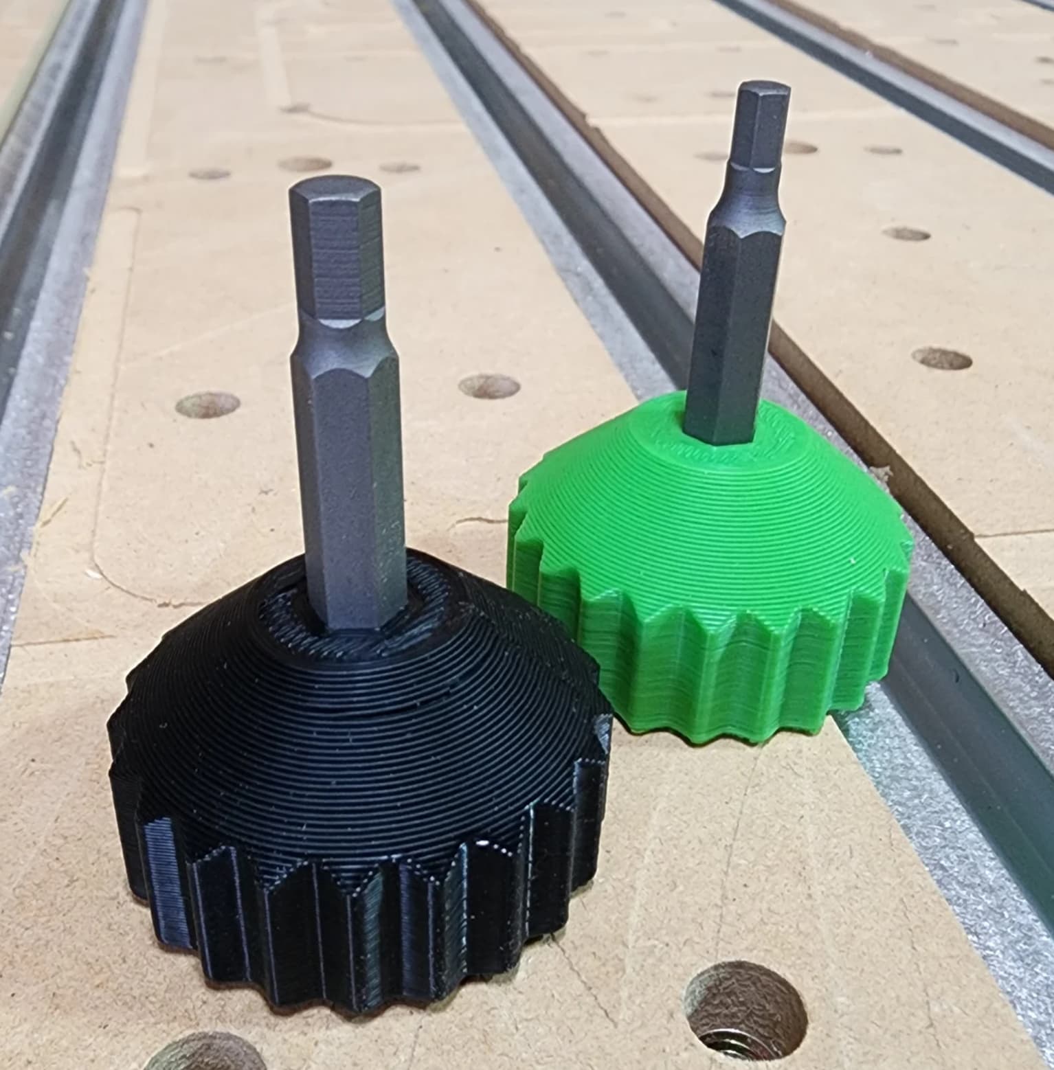

I don’t use ratcheting tools, but I designed/3DP/sell short handles for bits to make things faster. I also wanted to be able to tighten workholding with the gantry in the way of a t-handle, so made these short. Judging by how much I haven’t sold…no one cares. :smiley:

I prefer the T handles, I have learned over the years to spin them faster that I could use a ratchet. It’s all personnel preference.
@SLCJedi
I have tried those short handles and in certain cases worked well. I have to take the bit out each time or they don’t store well for me. Stands too tall in a short drawer or always rolling it seems.

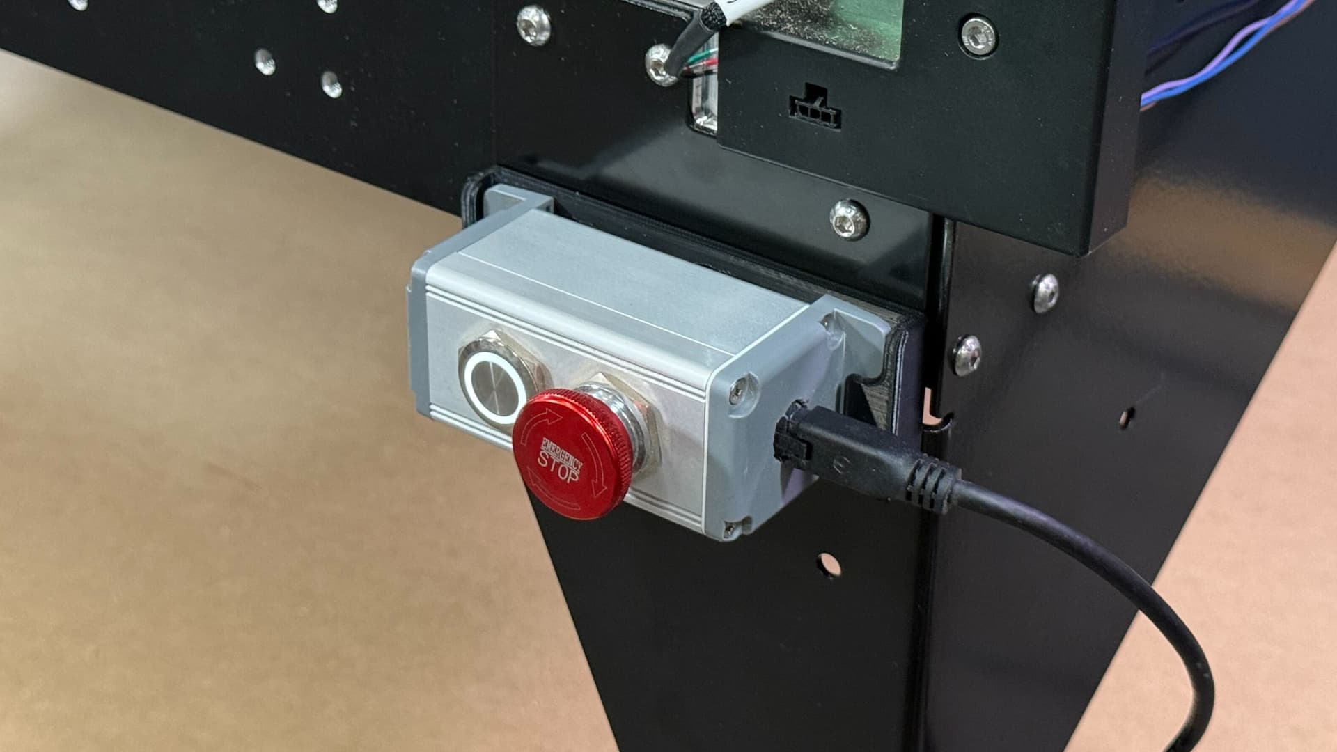

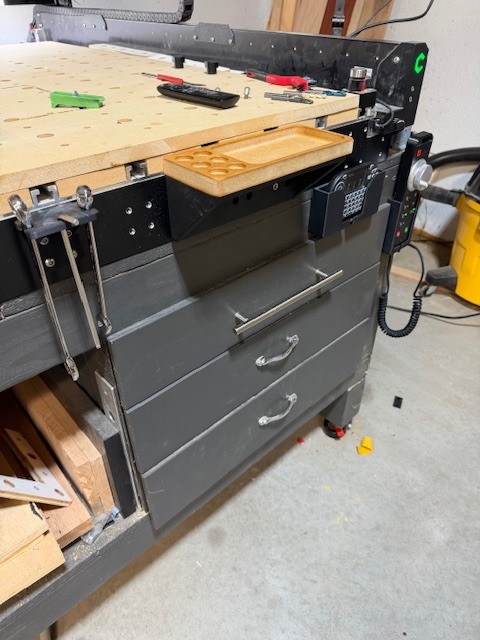

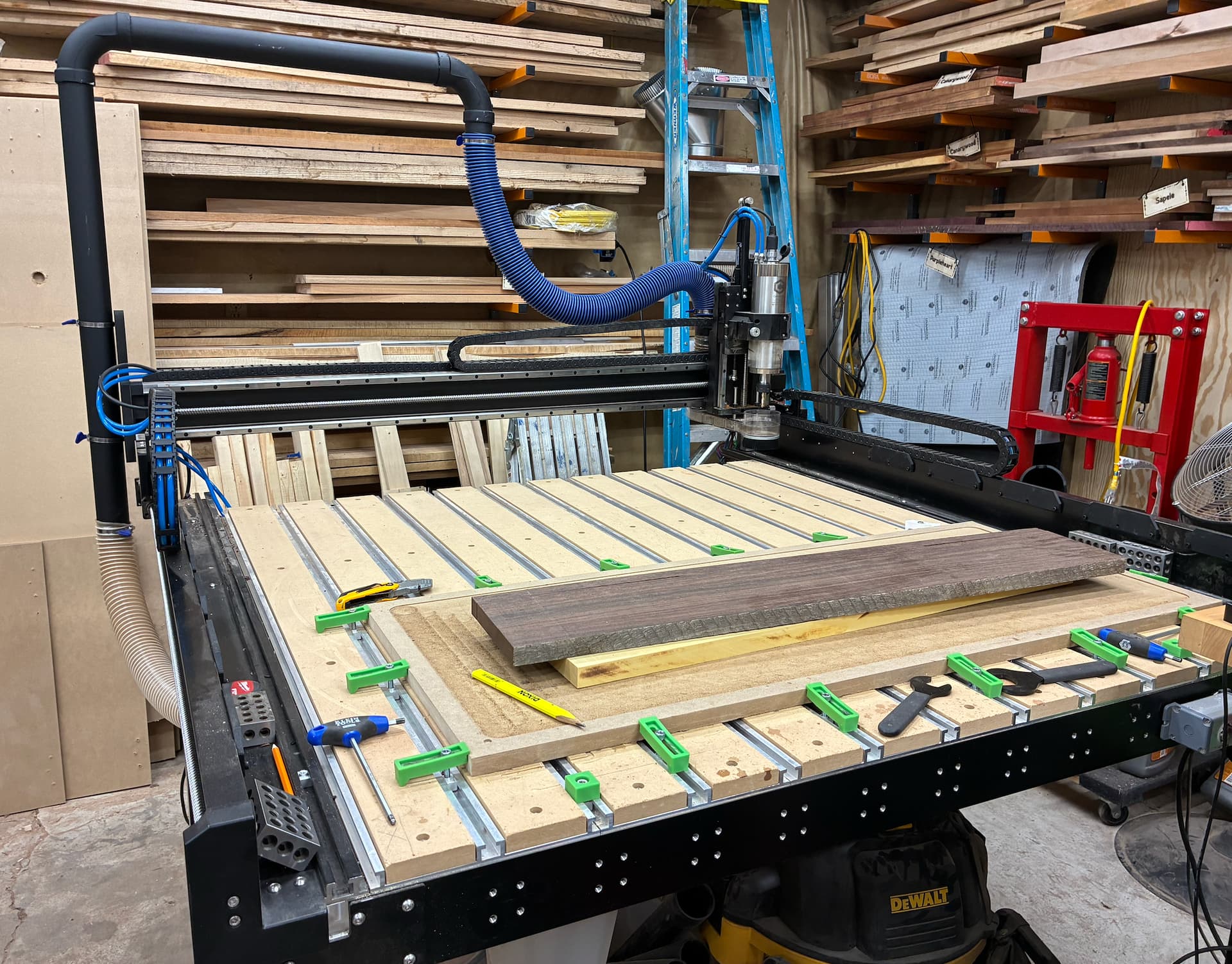

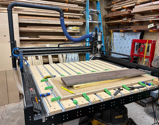

Your pendant dock was a great idea for 5 Pro’s with legs but mine is legless so I modeled one following to yours design for legless 5 Pro’s.
I added a small piece of plywood to the gantry end cap, and mounted the pvc so that it moves along with the gantry. I had to move the VFD to the backside, otherwise the PVC/hose would run into it.

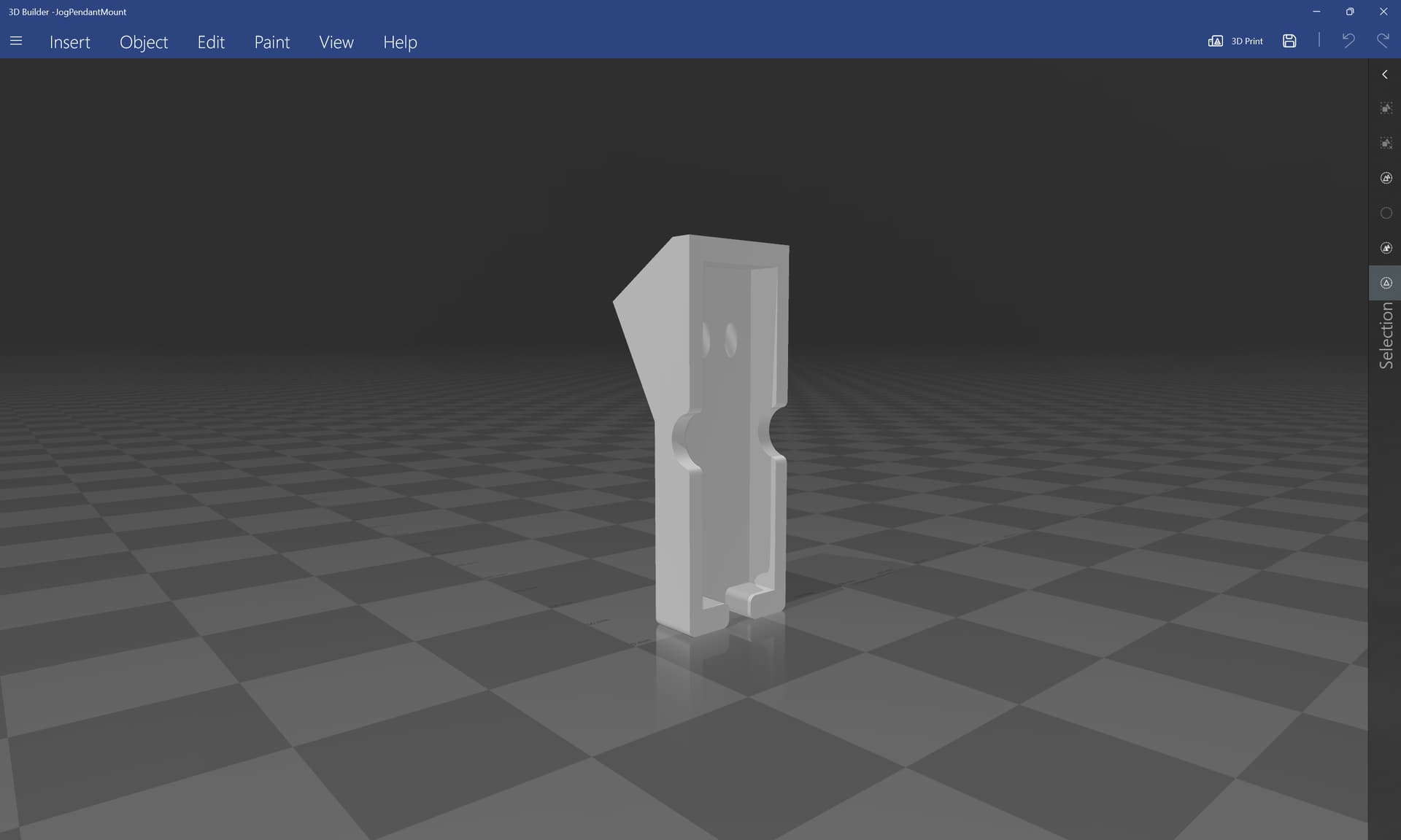

as requested on support…
David Christiansen asked:
Please share my STL file for attaching the jog pendant to the front of the 5.1. I’ve attached the file and am happy to have you share it, modify it, etc. It’s also available in the OnShape community
JogPendantMount.stl (217.7 KB)

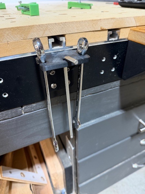

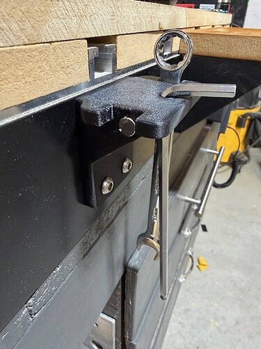

I printed a few items for my upgraded 5.1 rails. I find that I really only use the wrenches and the one allen used for the clamps.
