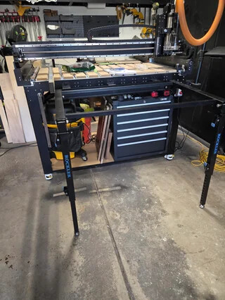

For reasons, I want the machine to not have a shelf (at least not yet), so need to get things mounted on/hung from the legs/Baseframe members…
I didn’t want the full width shelf as I wanted to slide my toolbox in. That’s what I went with the smaller cantilevered shelves on each side. One for controller and VFD. One for vacuum setup and cooling.
I just added a little remote 110v switch that controls the controller block and put it on the VFD side of my table. At least this way, I only need to go to one place to turn everything on or off. The cooler is on that side of the table as well.
It was a bit tight, but I got everything mounted:
Next up is sorting out the wiring and mounting the BitRunner itself and maybe attaching the transformer.
Professional!!!

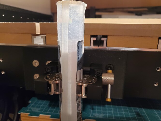

The video (I’m still waiting on the print magazine to show up locally to buy a copy) shows a rather clever front-mounted workholding mechanism, including a technique for aligning it (speed square) and for ensuring a consistent placement of stock when cutting (1-2-3 block), though I’m still a bit baffled by not using the fixture for a second cut…

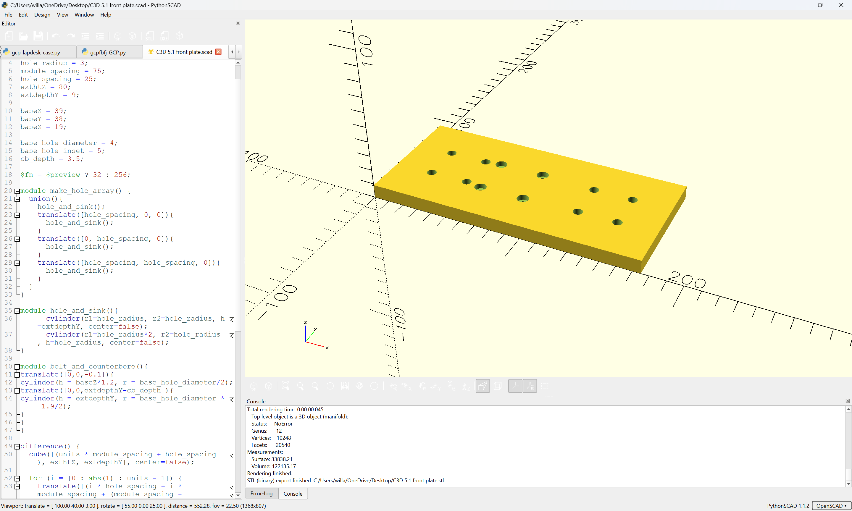

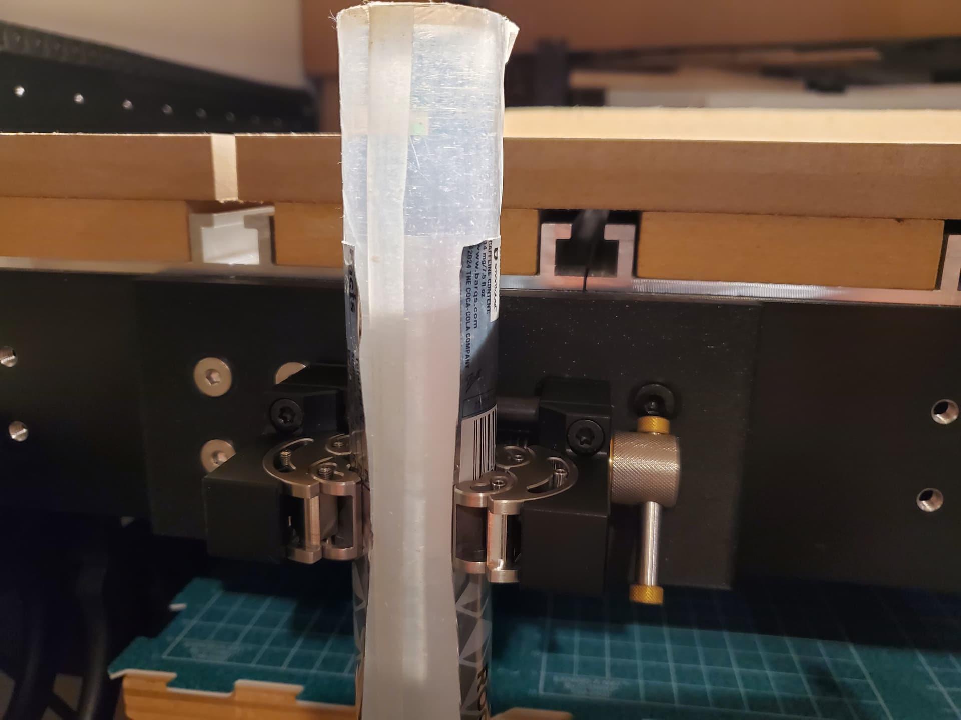

More workholding, worked up an adapter plate for the front holes:
C3D 5.1 front plate.stl (1003.0 KB)
which fits a Metmo Fractal Vise:
and with the vertical jaws:
allows one to clamp things at the front in ways not otherwise possible:

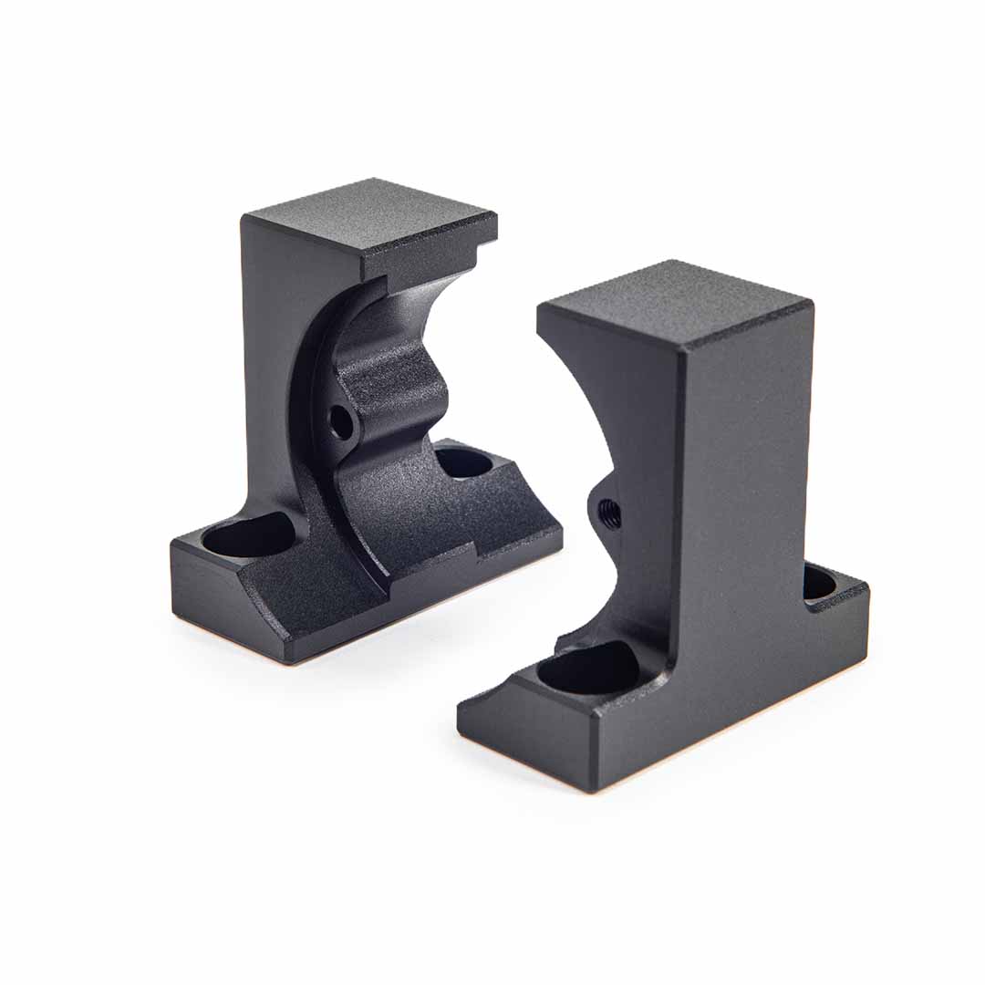

Basically, one uses:
to support material when tiling. Having them front and back would make that a lot more manageable.
