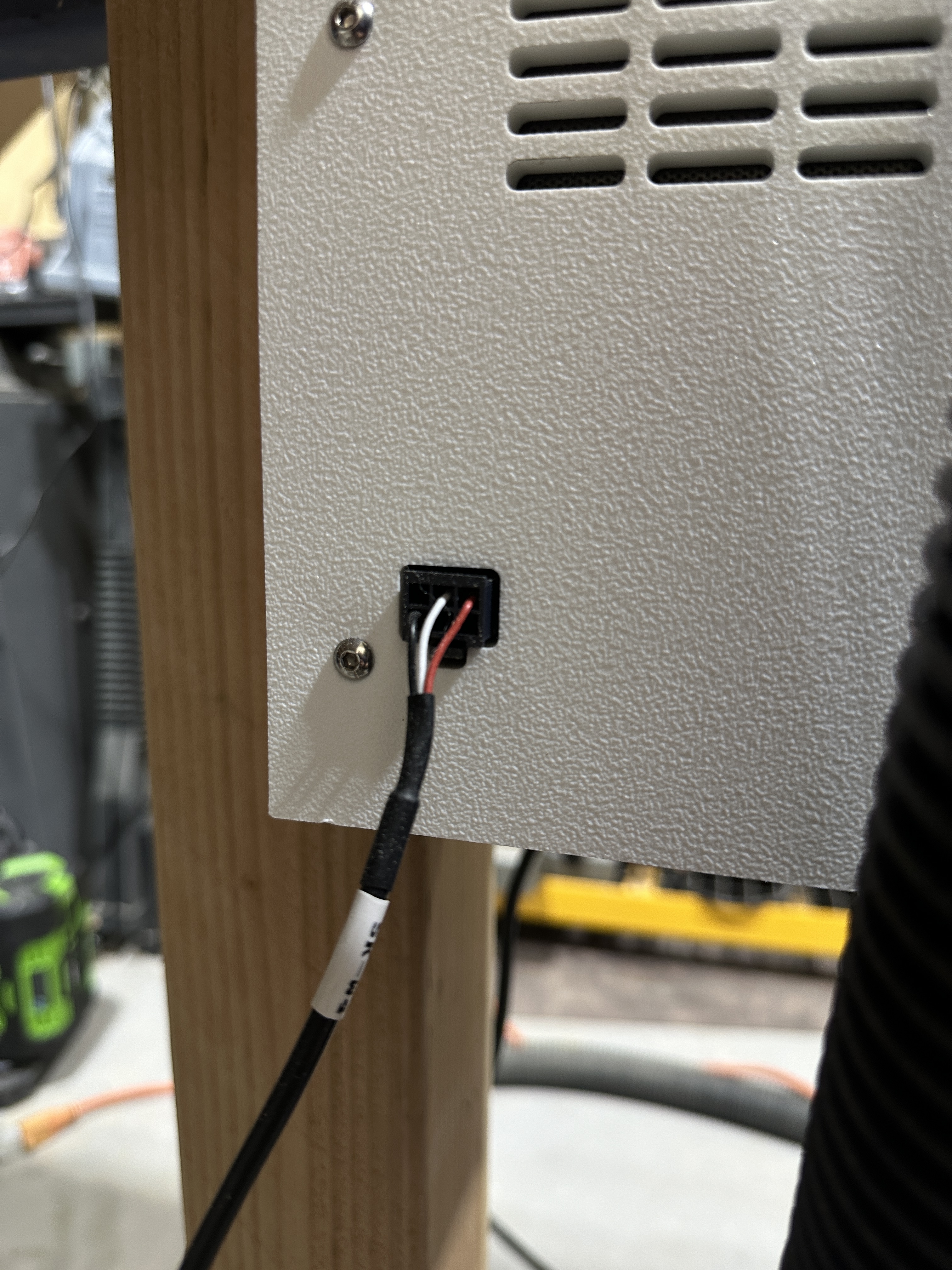

I found one. You are talking these wires right?
I have never done this before, any tips for how I test that?
Yes, If you unplug it from the box you can probe the white and black wire. Black is ground, white is PWM signal, red is +24V.

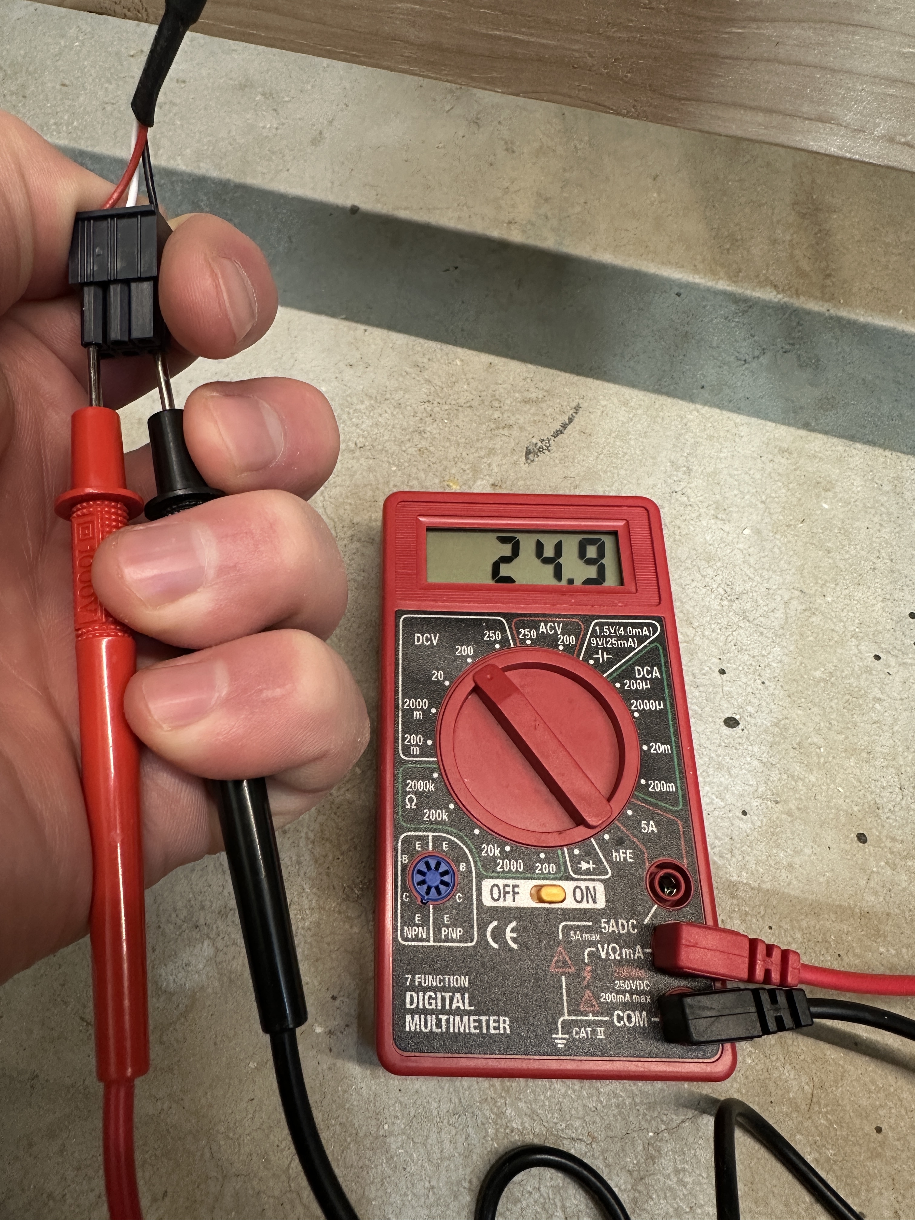

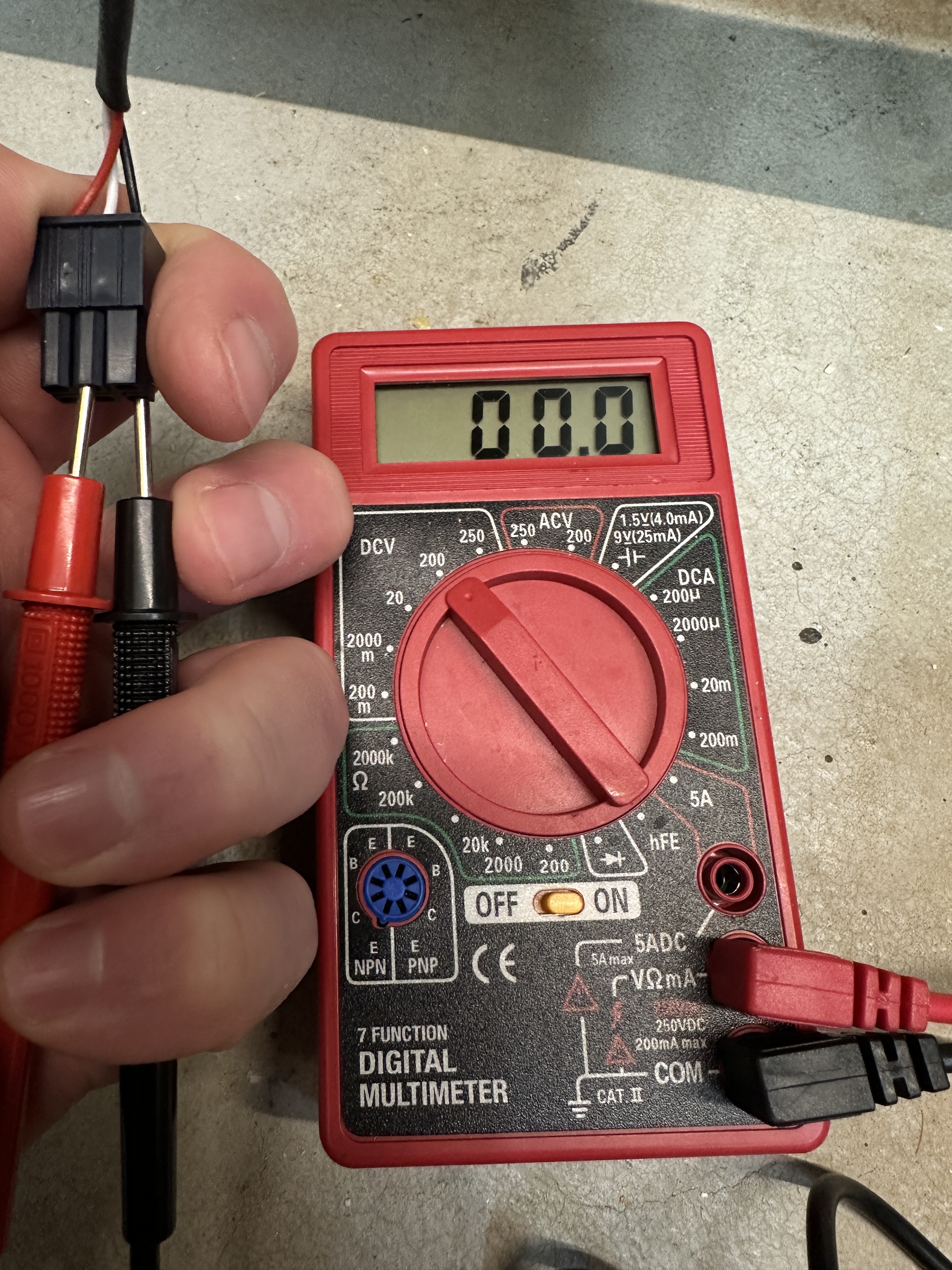

So with the SO5 controller turned on but not connected to carbide motion you should get 0V when probing between white and black. You should also get +24V when probing between black and red.

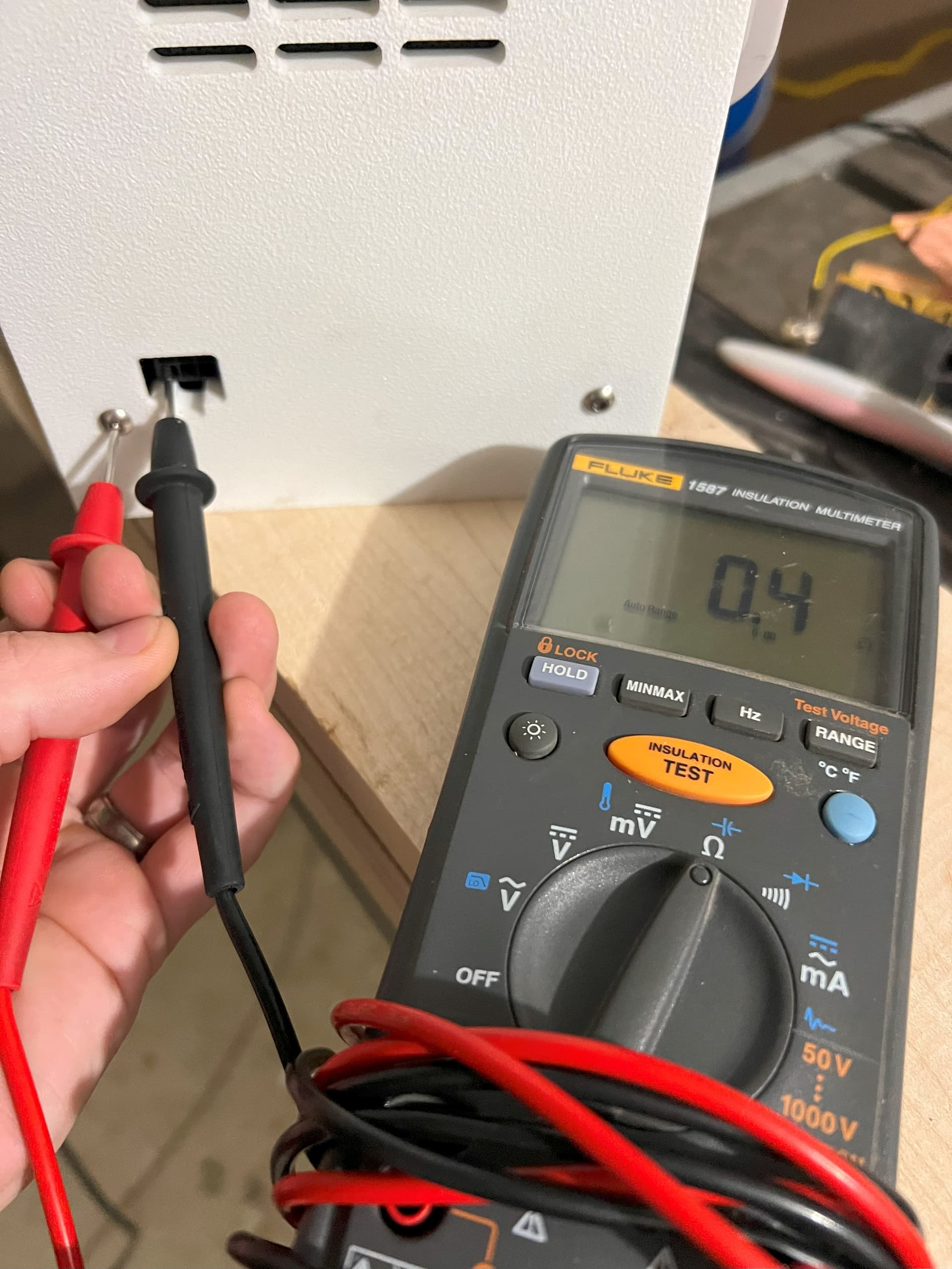

For resistance checks the machine must be turned off to avoid damaging your multimeter. You can put one probe on where the black wire would go into the VFD box and the other probe on the metal housing. You should read less than 1 Ohm and not OL(open lead).
Hopefully I did this right.
Yes that looks normal. You could try setting the meter range to 20 instead of 200 when testing white to black however to make sure you are getting the best reading. What do you get when you probe on the VFD box where the black wire would go and then the other probe touching any of the metal housing?

I just realized I was testing the wrong point on the vfd. This is what I see when I put my multimeter in the way you are showing :
Yeah looks like you have a bad ground inside the VFD. So replacement should fix.
