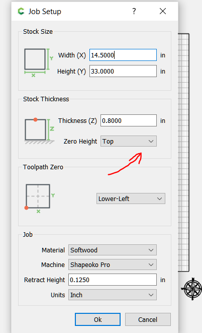

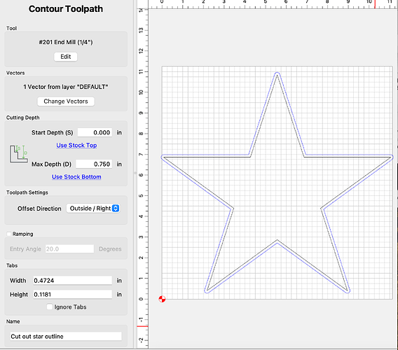

Where do you have “Z” zero set in CC. You can choose top of your stock or Bottom. Zero from what you have chosen in CC.
Let us know

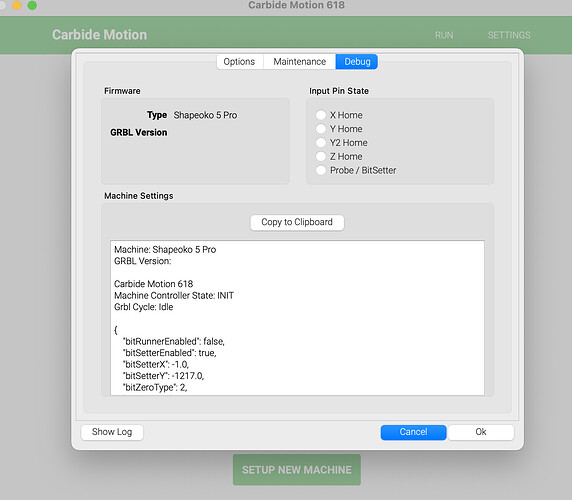

Thank you for your reply! Please see attached.
When programing your cut, in setup you can select where you would like to zero.
If we choose top we zero off top as you did using the Bit Zero. If the program thinks you are zeroing off the bottom it will offset accordingly, thus air cut.
Is this not what you have?

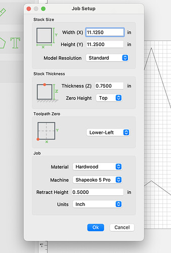

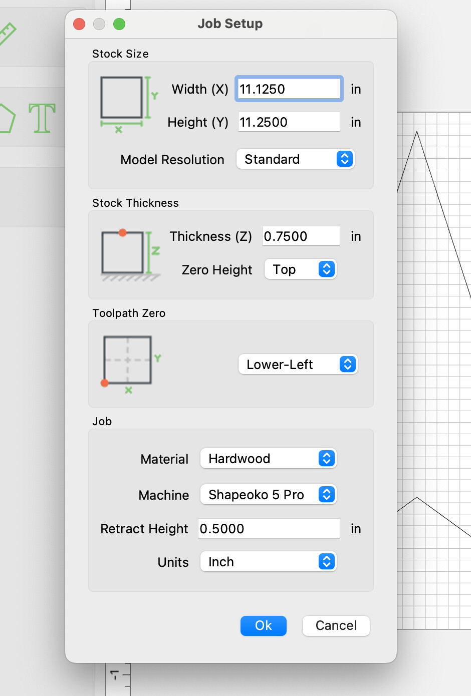

Yes, I have Zero Height: Top

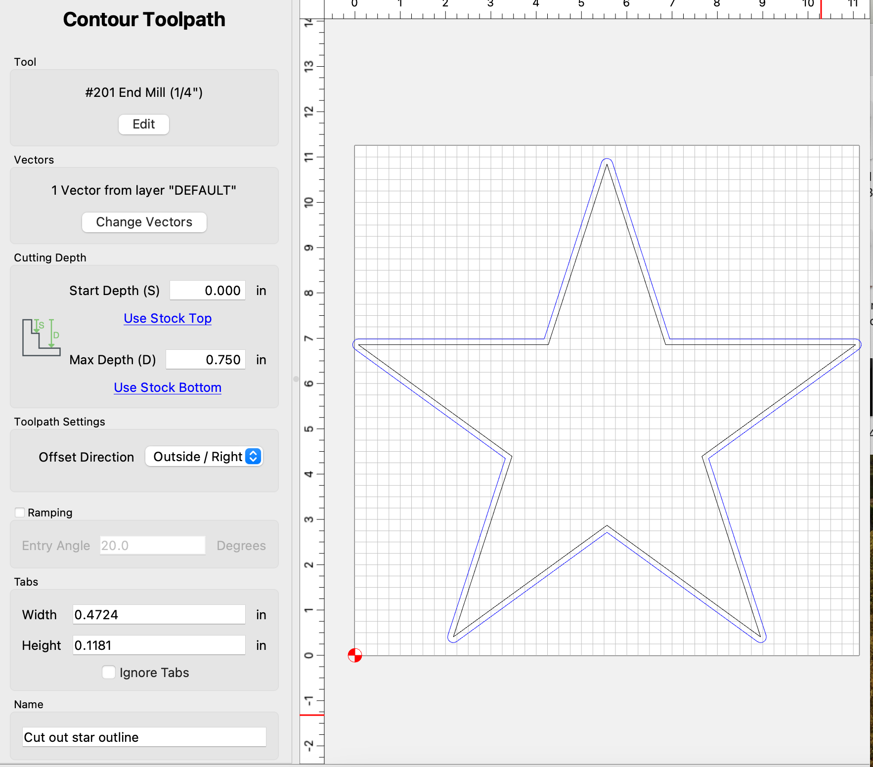

Is there any other place where I can have the wrong setting? Ive tried two different files, a star cutout and a circle cut out. The machine follows the file but makes sure it does not touch the wood, which is so weird!

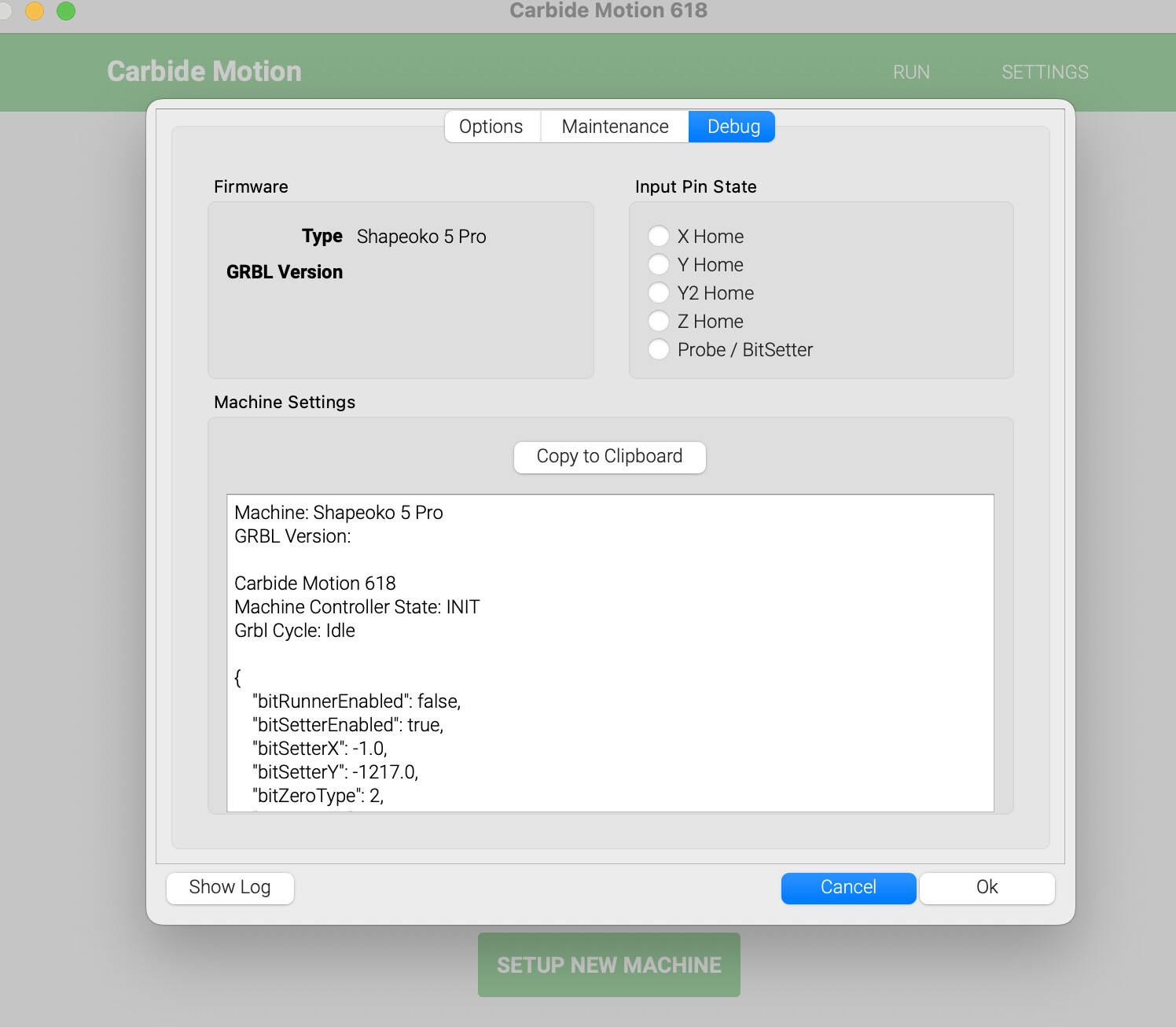

So question, when setting up in CM for a new machine did you select the right machine??? If you chose the wrong “Z” when setting up it might calculate differently
Yes I chose Shapeoko 5 Pro
I am sorry, you did not say you are using the Bit Zero. How are you doing it?
Sorry I am new to this! I don’t have a Bit Zero, I have Pro Bit Setter.

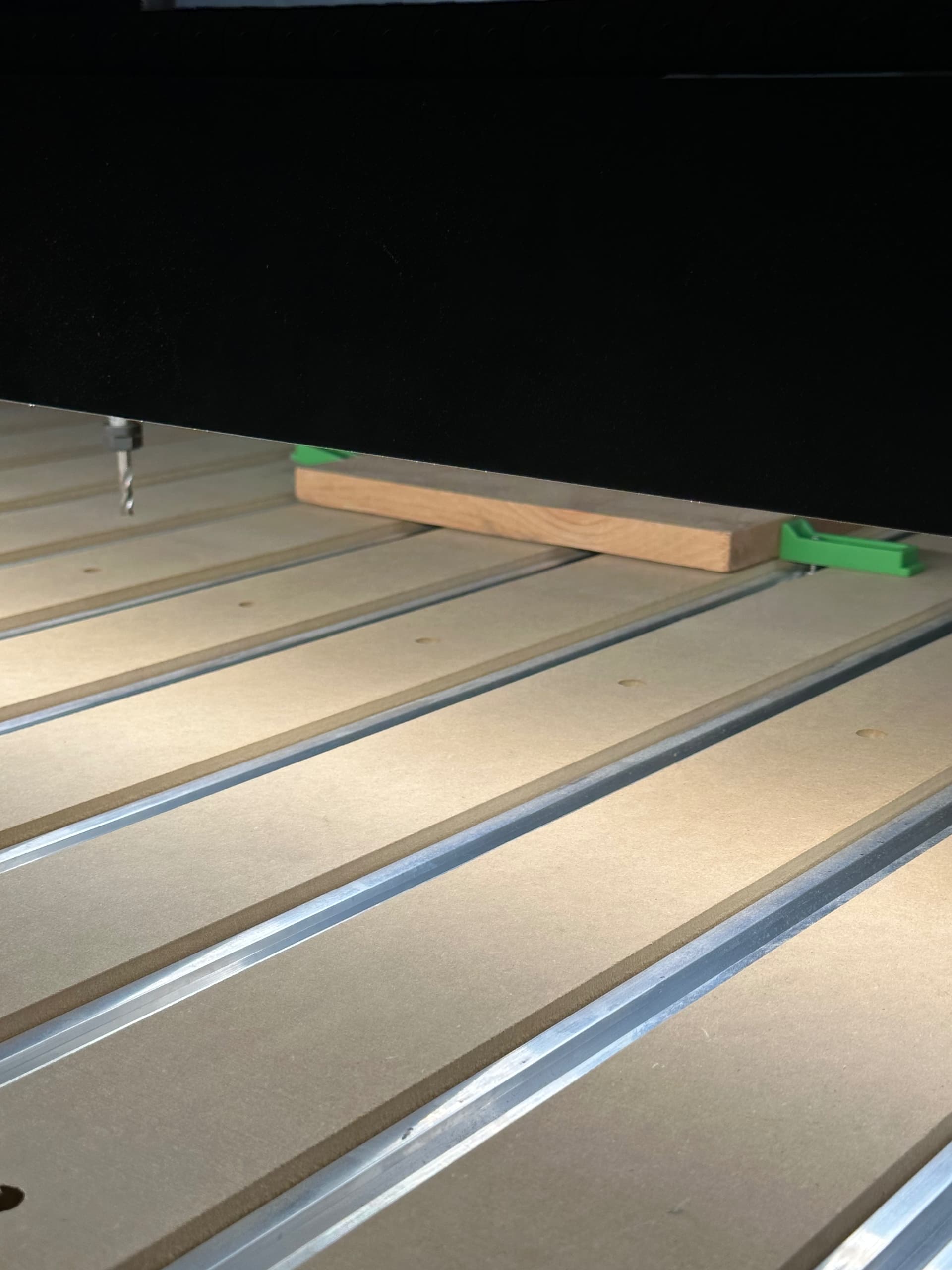

I am uploading the file into Carbide Motion, setting my Z to 0, and then the X & Y according to where the wood piece is placed. After I press “Start job” the machine makes sure to avoid where the wood is actually placed and does the design in the air, right next to it. If I move the wood to where the machine was doing it in the air, it moves away from that spot as well.

Yes, those are the exact steps that I did!!

How high above the part is it air cutting?
Yes I have sent them a message as well, hopefully they respond by tomorrow morning! It is cutting as high as I set it in carbide create .50 inch
