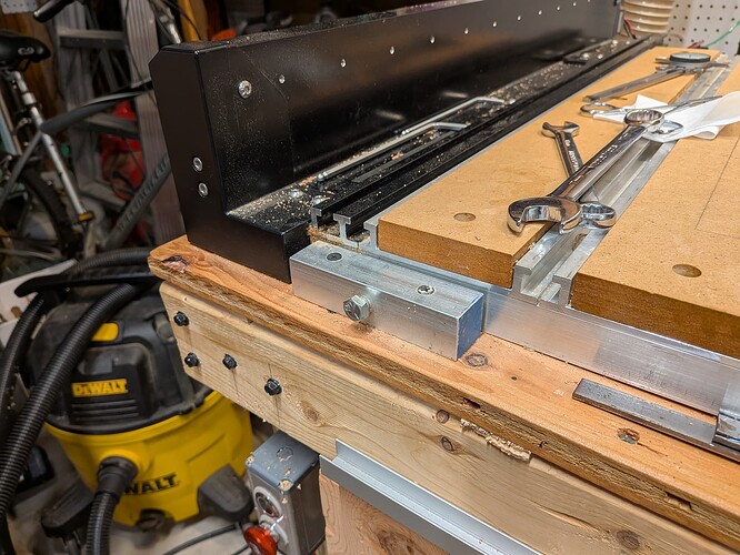

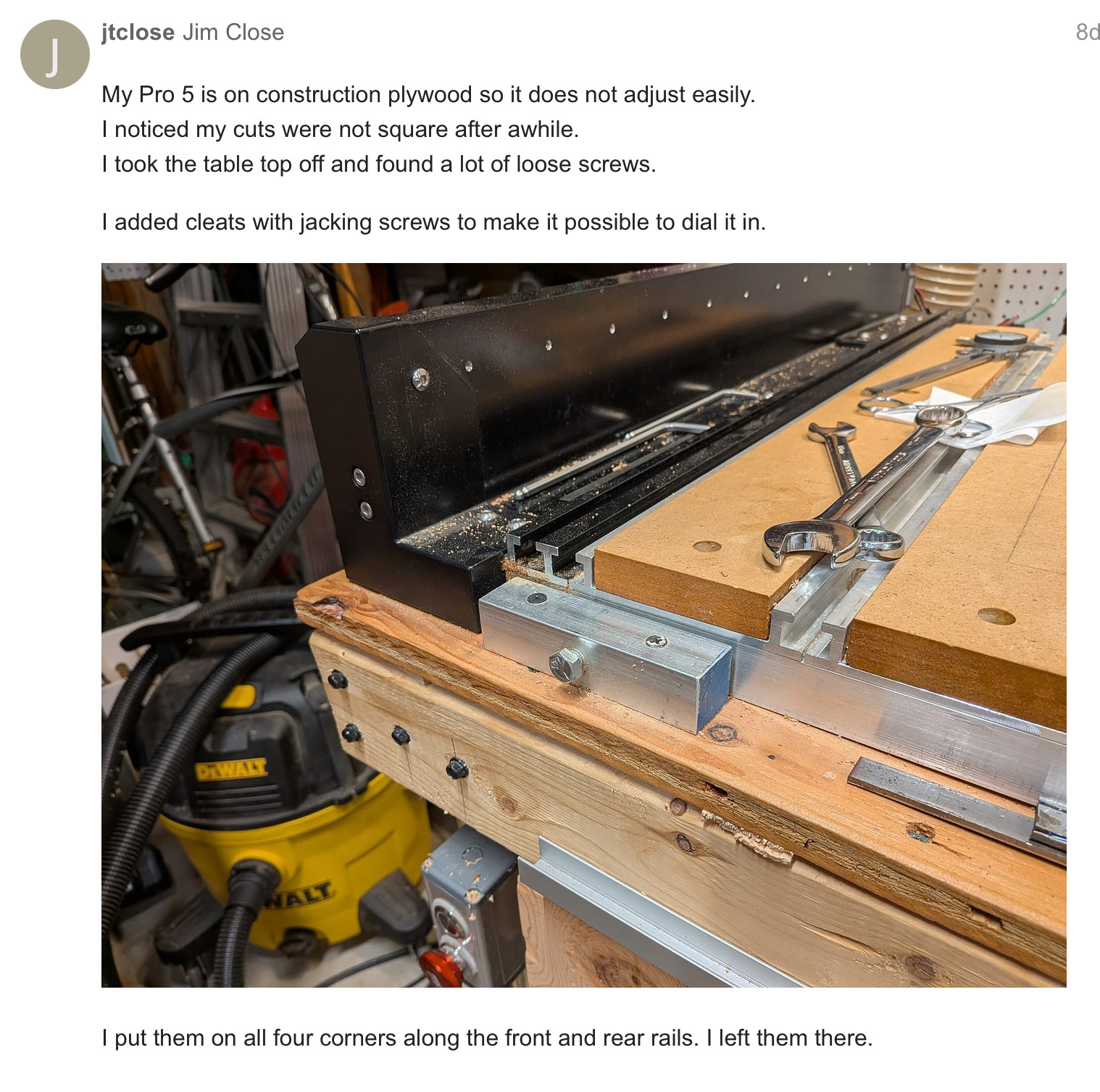

My Pro 5 is on construction plywood so it does not adjust easily.
I noticed my cuts were not square after awhile.
I took the table top off and found a lot of loose screws.
I added cleats with jacking screws to make it possible to dial it in.
I put them on all four corners along the front and rear rails. I left them there.

I made them. You can use wood.
Use a threaded insert for the jacking screw.

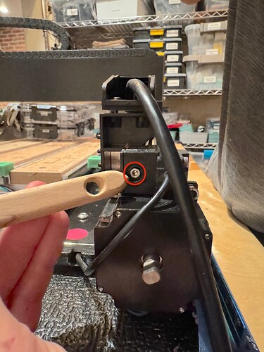

Is this the socket head screw I would adjust?
I doubt that this is your issue as the sides look fairly straight, but it is worth checking for backlash in the X and Y axis.
Yep, that’s the one. I believe it’s an m3 screw, if I remember correctly, so based on the pitch of the screw, one full turn will shift the homing point about half a mm.

Note: I didn’t see the homing switches moving when I turn the micro-adjustment screws, but I understand it’s “micro”.
