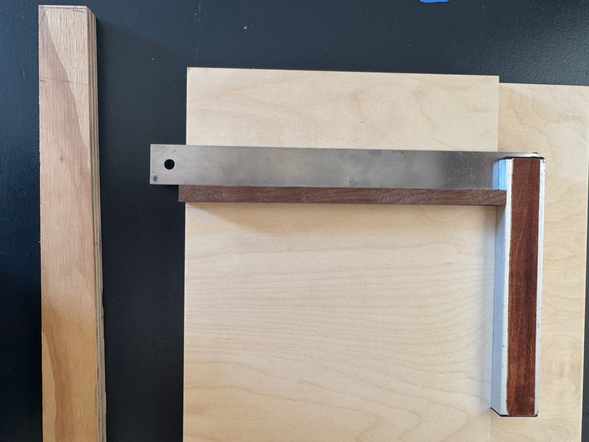

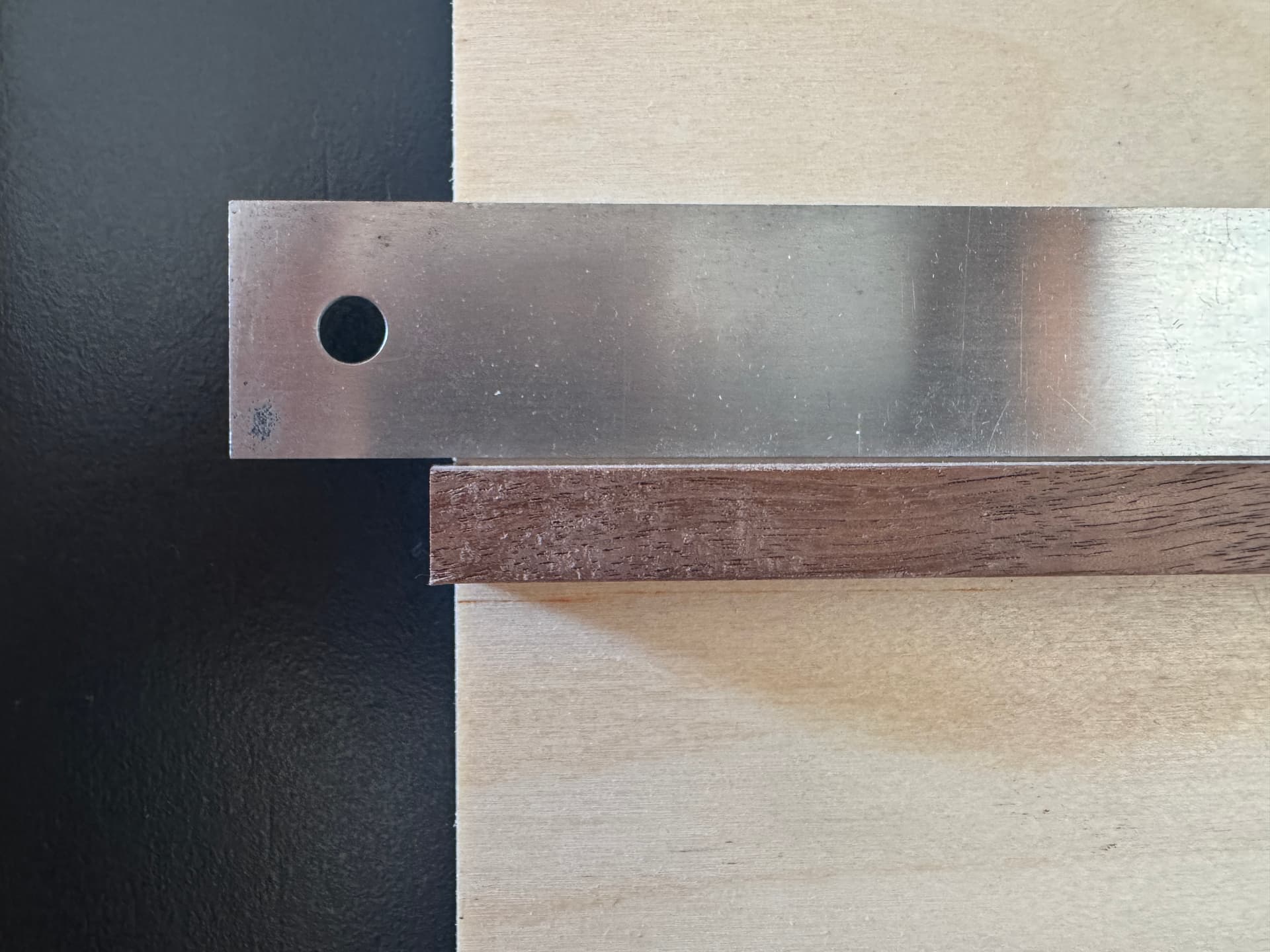

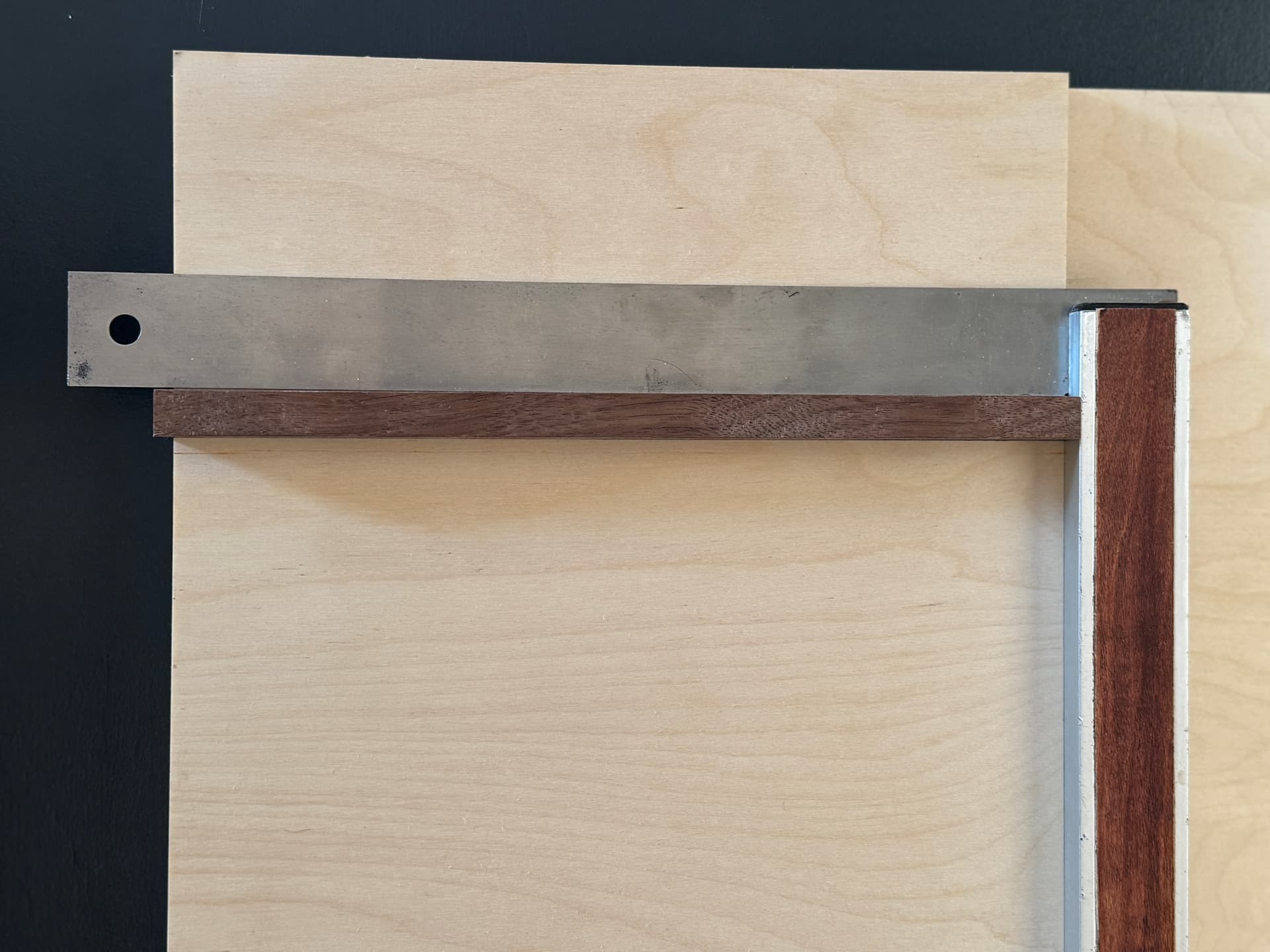

Please post some photos with you taking these measurements to help understand which side are skewed.
See below.

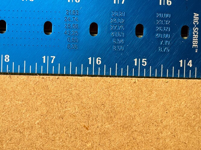

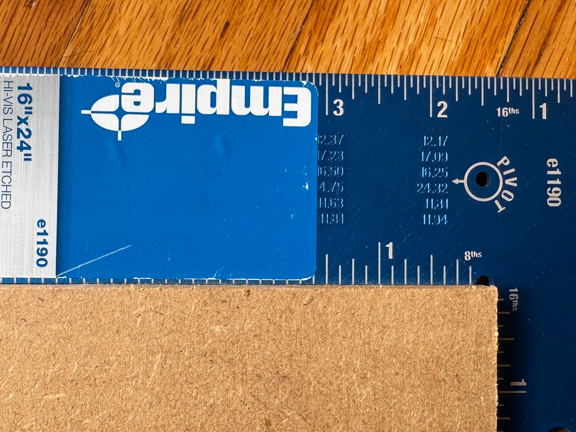

In both of these projects. The top left starts to show a visible gap from the square at about 13"+ inches, with 16" being a full 1mm gap.
Top down from a distance:
Top down, close up:
Again from a distance:
The project where I started noticing it’s off - making a shooting board that has to be perfect 90 degrees…but it wasn’t, lol.
And this morning:
Top right corner:
Top left area at 16", where the gap is clear.
Are you sure the framing square is square?
Test it by marking a line from both sides — if not square, adjust into square:
That said, I’d recommend purchasing a good quality square which you can be confident will have been made square, and remain so — Lee Valley is one company which can be trusted to curate their selection:

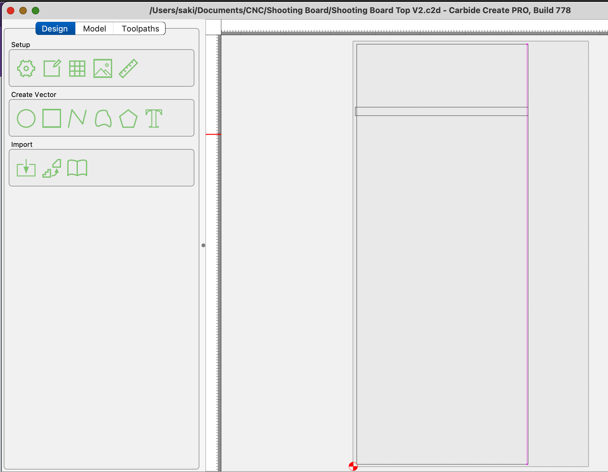

Are you cutting this Shooting Board out of one piece of MDF in one cut? does this include the dado for the fence you showing in the first two photos?
I do have a table saw and can cut a 24" square and jog it - is that better than running it along the rail to check?
The shooting board (or my attempt at making one), was made in high quality multi-layer 1/2 baltic birch.
