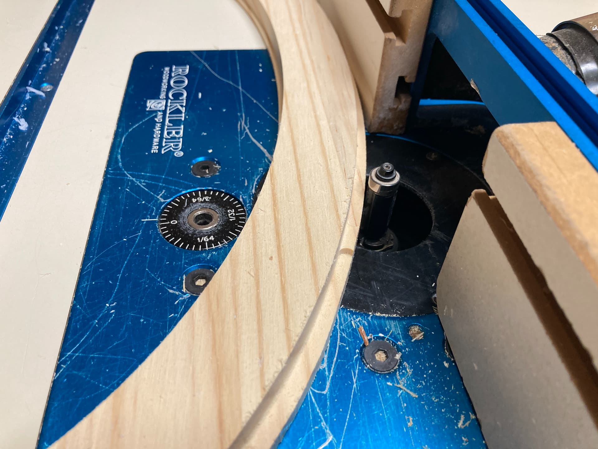

Through cuts are often necessary. But if you can, leave half the thickness (give or take) then remove the piece and use a flush trim bit on a handheld router or router table to finish the edge. This saves a lot of cnc time, keeps your spoil board intact, and provides terrific results.
NEVER use a bearing bit on your cnc.
